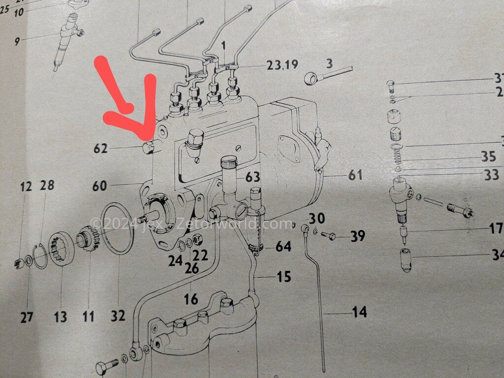

Thankyou. Where is the regulator situated and how is the oil checked / changed? It maintains the revs but when the throttle is dropped back to idle, it slowly responds and almost stops unless I increase it again.

On the back of the injection pump. When my 3011 leaks injection pump oil into the sump and runs dry, it doesnt run smooth at high idle on the road: it starts to talk like ta-ta-ta because the goveror overcompensates when it doesnt move freely, it either gives a lot of fuel or it shuts fuel off to maintain rpm within regulated margin, meaning every time only one cylinder gets fuel and the others dont when its their turn.
