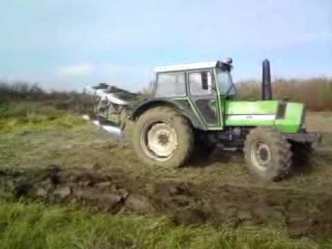

And here a Deutz DX90 F5L912

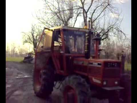

And a Same Leopard 95: With not too much silencing, it does sound a bit like the Mercedes OM605 and the VW TDI at low rpm :D
