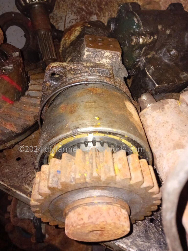

Has anyone ever removed the 4WD pack out of the housing on an 8045?
I have the nuts open and the pipe off and the cable off. I was wondering how to start to pull the pack out now?
I found a pack at my local scrap yard with the front of the pack broken and I don't want to do the same.
I'm going to answer my own question. I don't have the pack out yet, but I was informed, it's just gasket maker that is making my one hard to separate.
