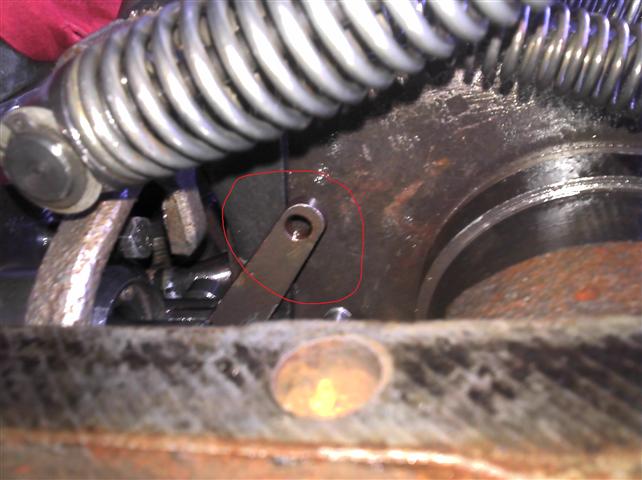

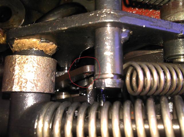

Just an update on my hydraulic woes. I found where I was loosing pressure, both the o-rings on the connector between the hydraulic distributor and the pipe coming from the hydraulic pump were broken and I believe this was aerating my oil giving it the thick creamy appearance. The lack of control over the three point linkage was due to the small link between the operating leaver inside the hydraulic cover and the valve on the distributor having come off it's pin on the operating leaver. there doesn't seem to be any method of holding it in place. there is no grove for an e-clip like there is on the other pins. Can anyone shed some light on this?
There also seems to be a part missing from the leaver mechanism under the cover. There is a leaver that doesn't seem to connect to anything yet it has a hole on the end of it that looks like it should connect to a pin or a spring, or possibly a roller. it currently just sits there and rattles around. Have a look on the following photos and you will see what I mean.

Hi Paul, did you get this sorted? I too have exactly the same lever hanging there on my 7245, like it is missing a cam roller or something? My draft control doesn't seem to be working very well. Does anyone have any photos of this linkage connected to anything? I have had a search around in the bottom of the housing to no avail.
Cheers,
Aaron.

Hi Aaron.

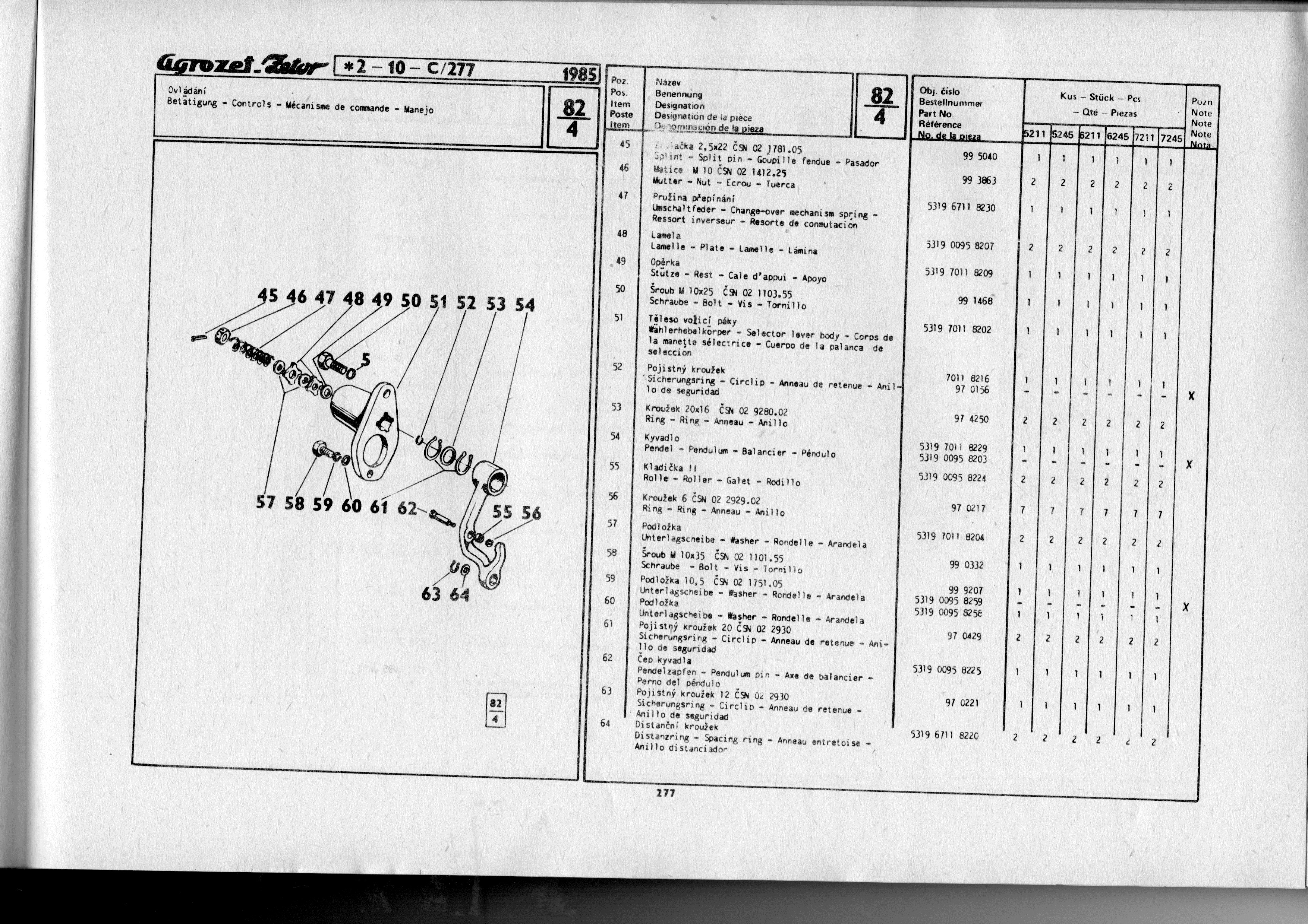

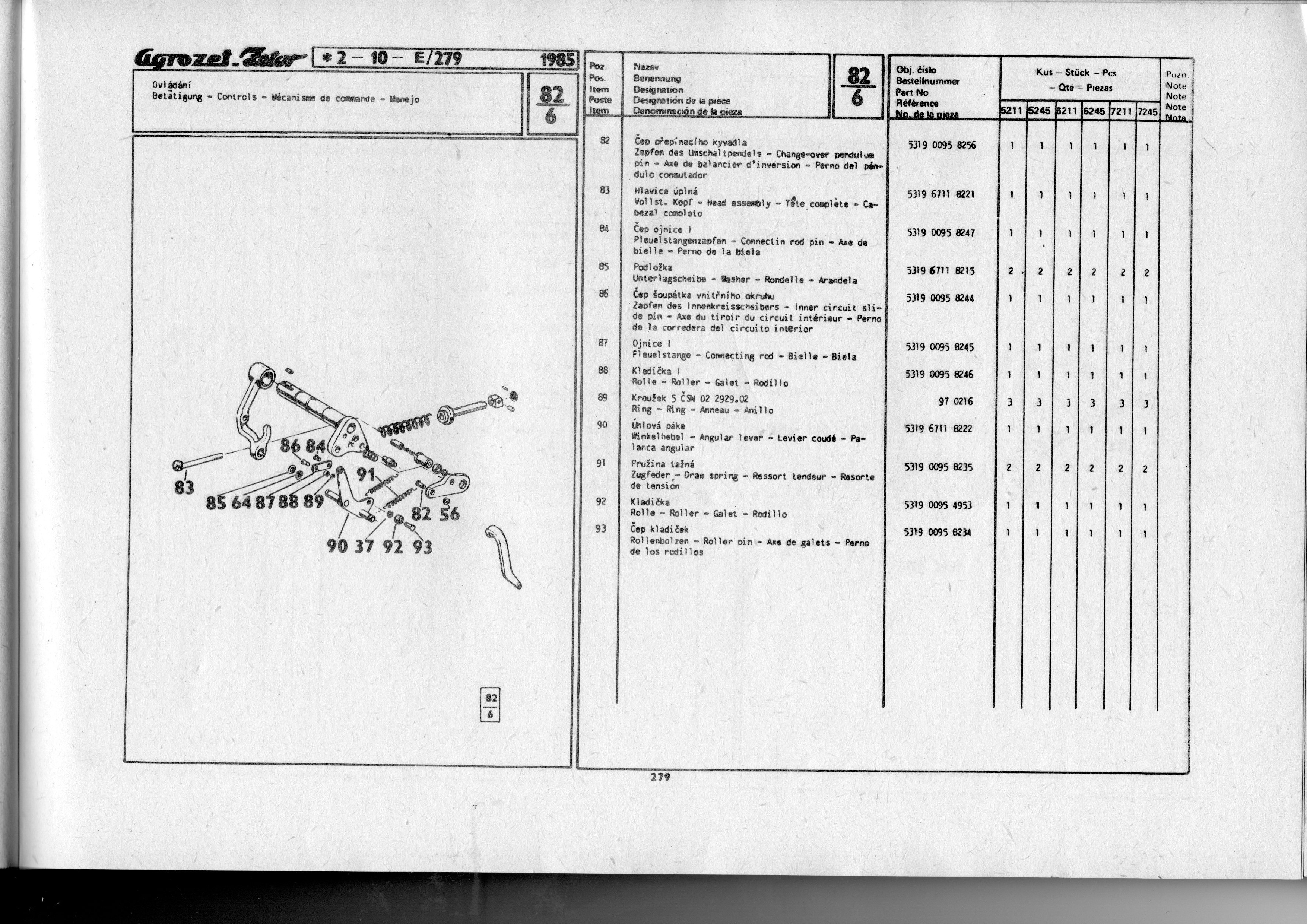

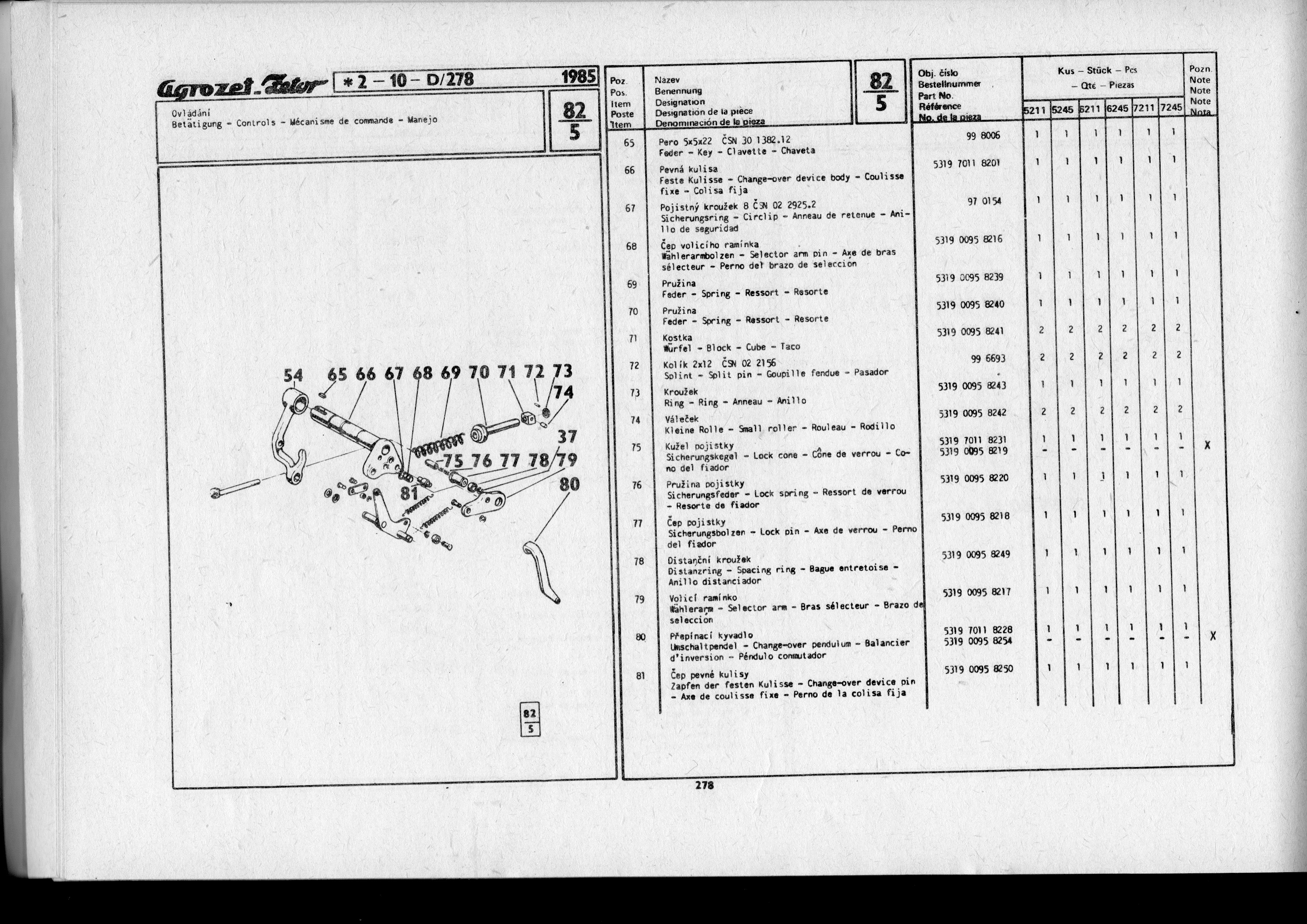

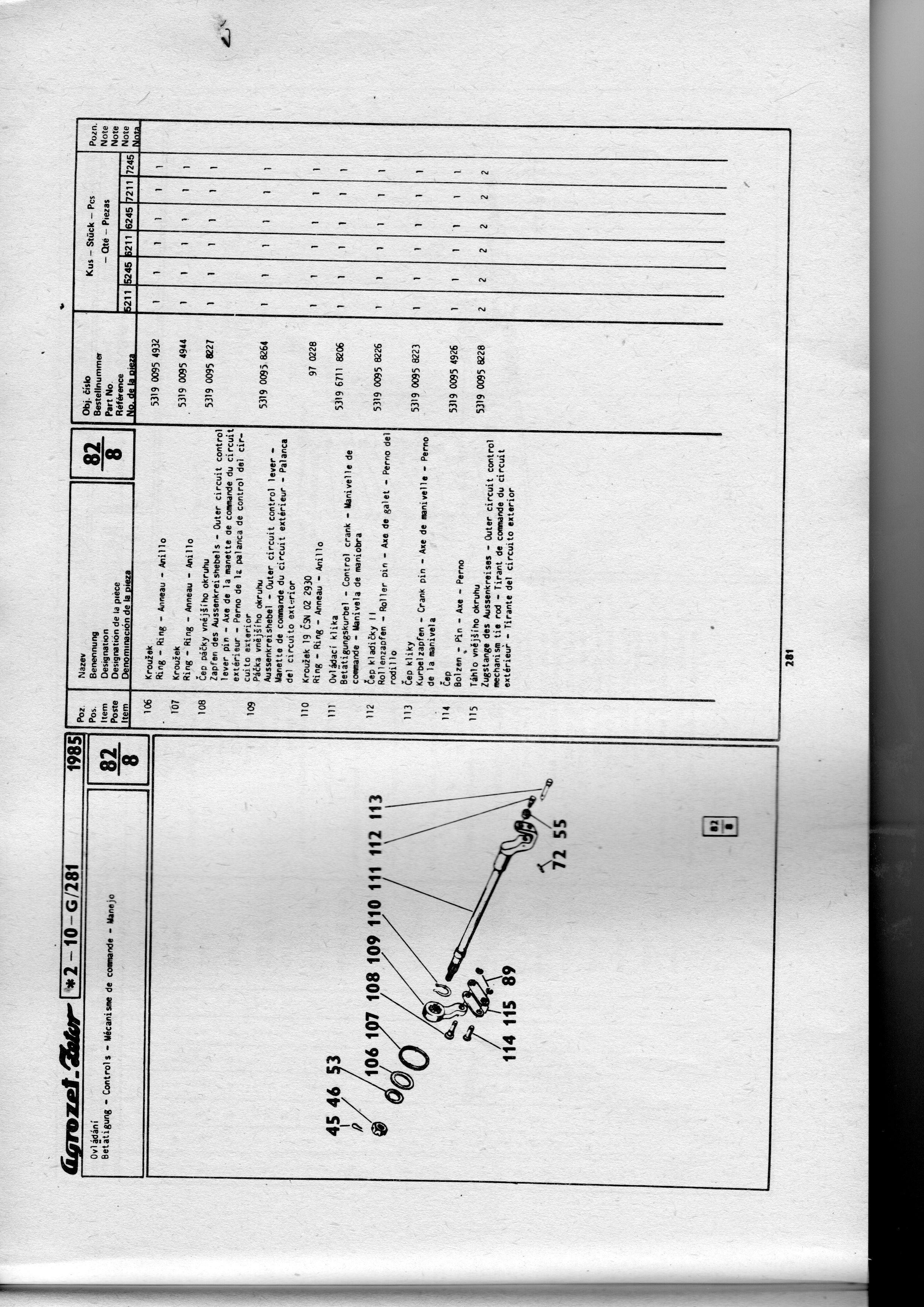

I am still working on the problem. I now have a parts manual (bought another one, the one I bought from Canada STILL isn't here!) and if you look at the image below, I believe it is item 80:
change over pendulum and there are no rollers shown in the parts book so I think that is how it is supposed to be.Sorry i cant help more. I've included all the pages from the parts book that show the internal mechanism in case they are of some help to you. Apologies for the image size, but I think you will need the higher resolution to see them well.

Thanks for that Paul, I ended up coming to the same conclusion, as I couldn't find anything in the bottom of the box, and it hadn't been apart before. I ended up pinpointing the draft control issue to the torsion bar sagging. I also resealed the whole zetormatic valve, cover, cylinders and controls, and adjusted everything up. I now have a system that is entirely leak free, and works like it did from factory. :D
