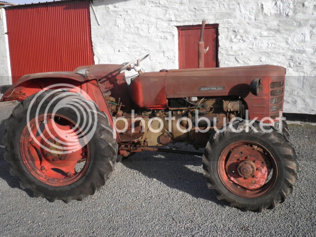

Thanks Zebedee, hers a picture of the old girl
I've put on 2 new trac rod ends, and have the bushes for the centre pin, but will have to look at the box down the line.
Still trying to figure out the hydraulics and PTO.
