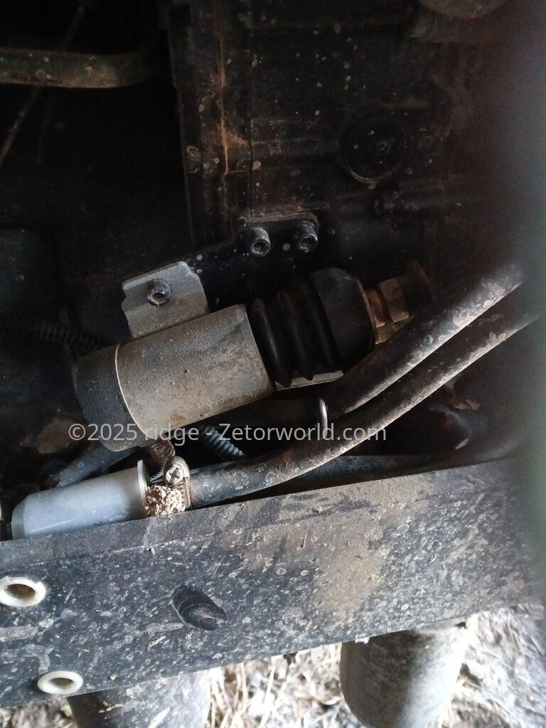

What's on an electric throttle control that's different with my mechanical one? When I turn on the key, I can hear linkages moving on the pump. How can you tell the difference?
What you are hearing is the stopper solenoid.
This guy. When you turn on the ignition, creates an electromagnetic and opens the valve for fuel . Turn off the ignition, it springs closed and cuts fuel.
The mechanical throttle control has rods and linkages like this
20250508_202604.jpg.
This is what you have. Newer models I'm told have a different system involving electronics and what a mechanic told me a couple weeks ago give trouble.
When you turn on the ignition, creates an electromagnetic and opens the valve for fuel . Turn off the ignition, it springs closed and cuts fuel .
Yes that's on mine. It makes a fair bang noise, when you turn the key to start. I remember thinking when I bought it, how modern it felt not have to pull a stopper or anything, just turned the key to stop the engine like a car.
