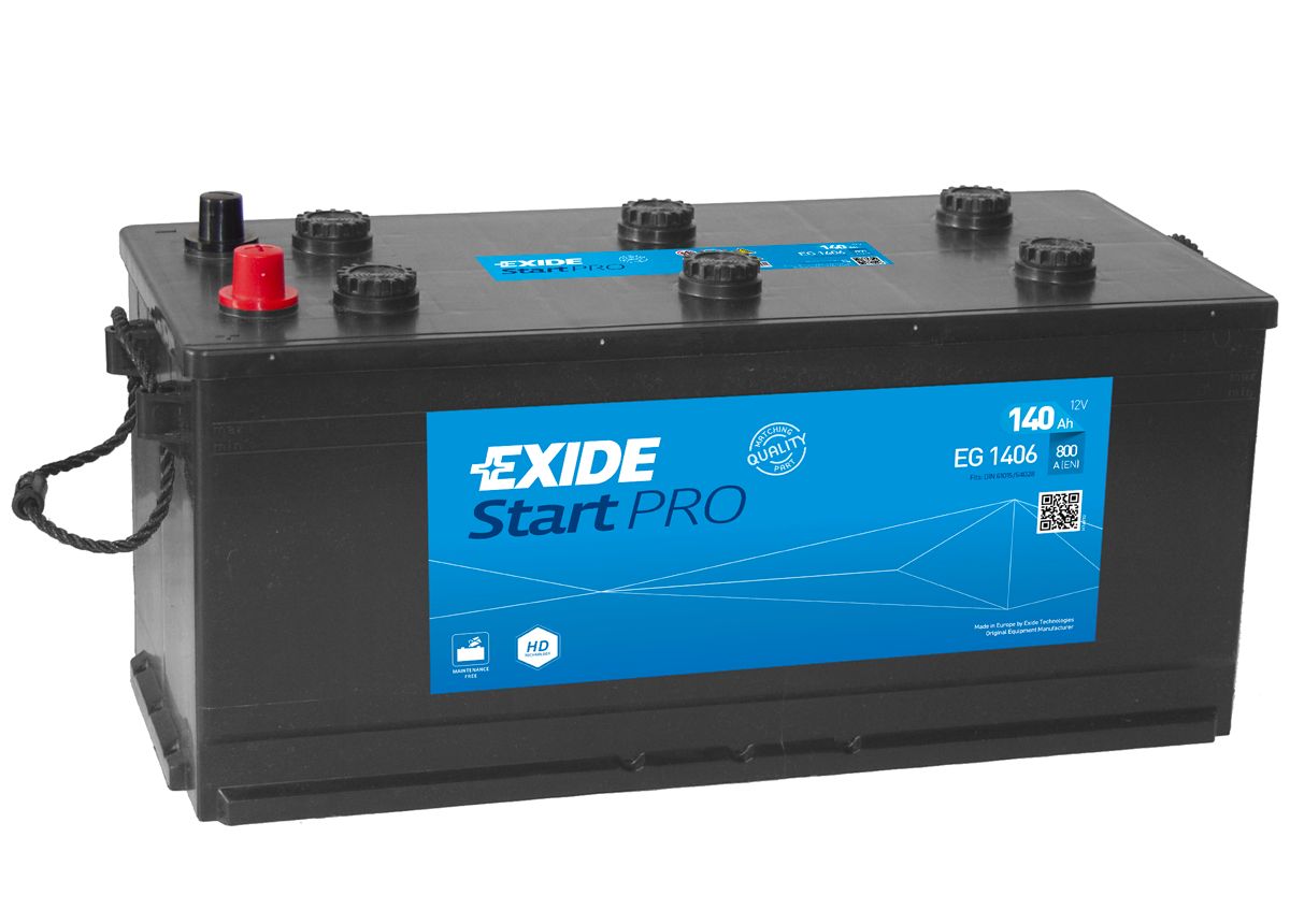

Hello everyone,my zetor 8540 tractor has battery problem,can i use exide battery 110ah 750a 1100cca on the same tractor?thank you in advance.

https://www.tayna.co.uk/truck-batteries/exide/eg1406/
That looks like what you need. I have to change the one in my 10641, like this one.

Hello,i meant exide battery 110ah 750CCA EG1100 on a zetor 8540,Regards.
That's a 663 battery, like the ones that goes into a crystal, Is the battery box in front of radiator as they usually are longer ones.
