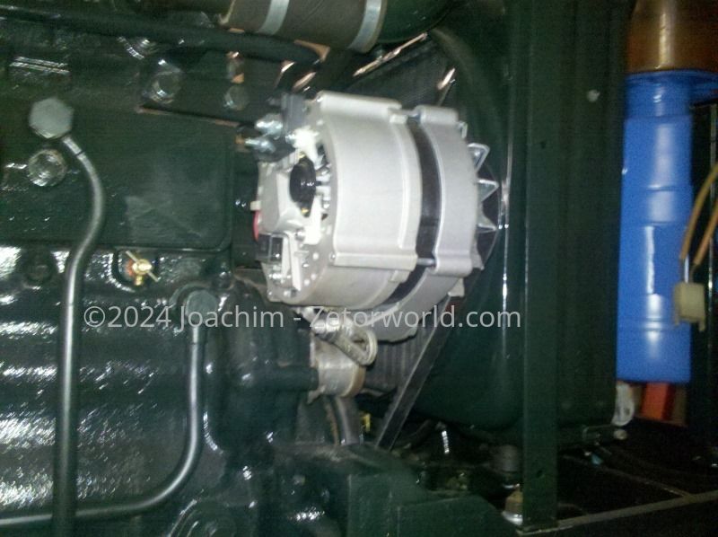

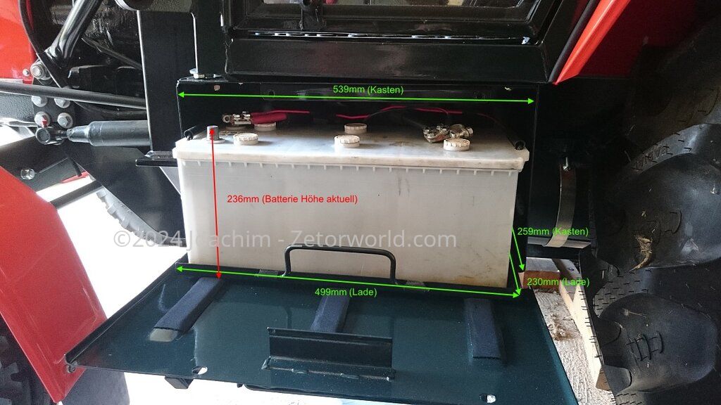

in my Zetor 5011 from 1984 works a 185 Ah battery (Excide truck battery) with 1.100 CCA, service free type. But I also redesigned the entire electrics, so I now have a 95 A alternator in the tractor so that the battery can be charged faster and I also made the cables stronger.

They is now around 9 years in my Zetor 5011 with no trouble... starts without problems up to 35°C and down to -12°C :)
That looks a great solution ... many thanks for your help .
