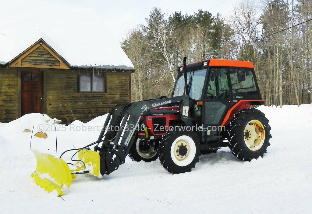

I have owned this tractor for a year now and this brake trouble came with it.
When using the foot brakes, every time pushing on the pedals either individually and/or together, the brakes build up to where one or the other begins to drag all the time becoming hot.
The brakes only return to normal after setting overnight.
This behavior seems to be like there is a check valve stopping the brake fluid from releasing the brakes.
I would like to correct this brake trouble.
Any idea what is causing this to happen ?

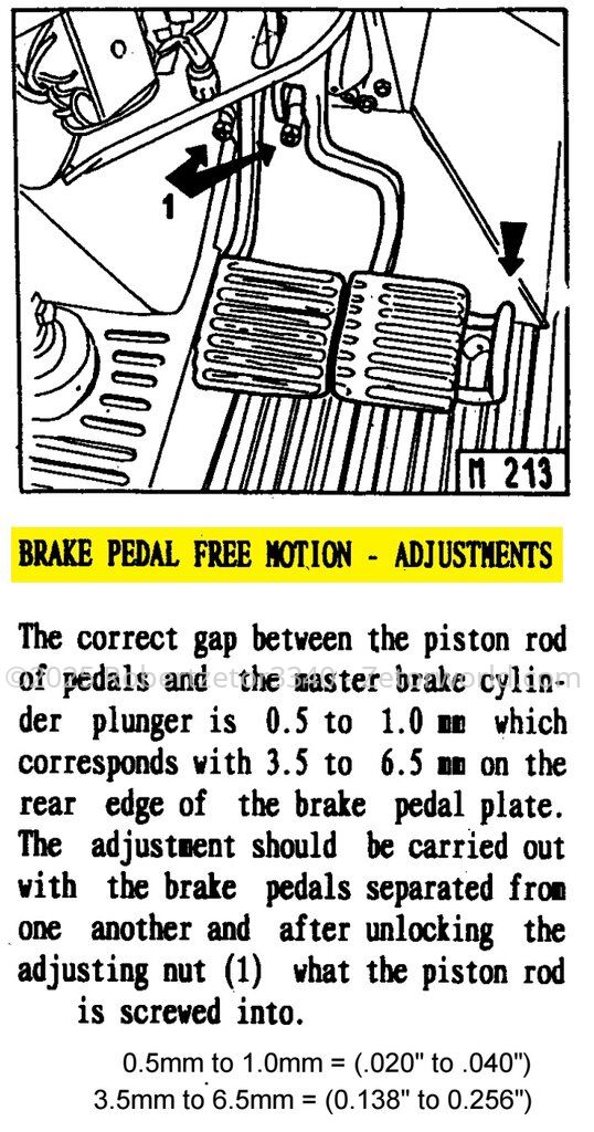

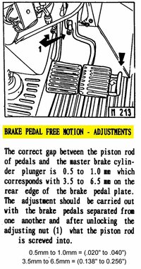

Please first check the brake pedal play according to the specifications (workshop manual )

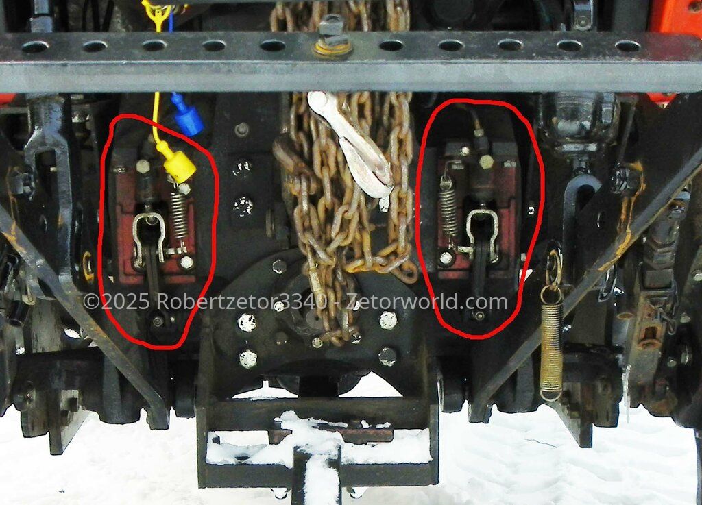

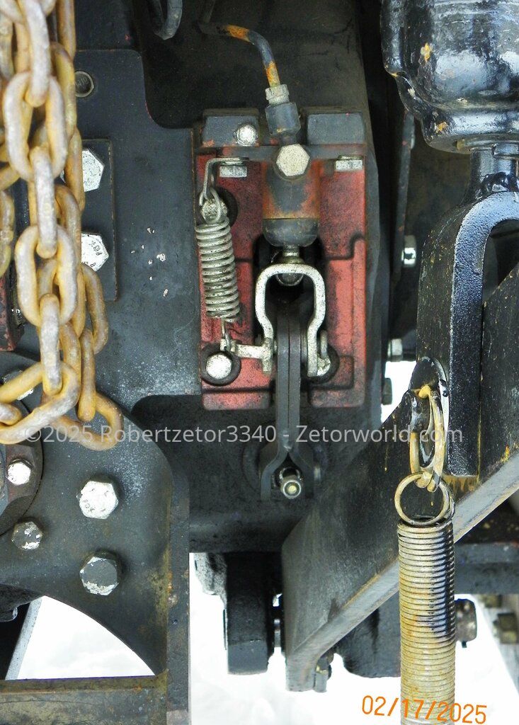

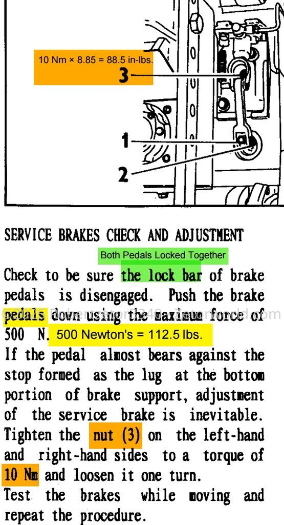

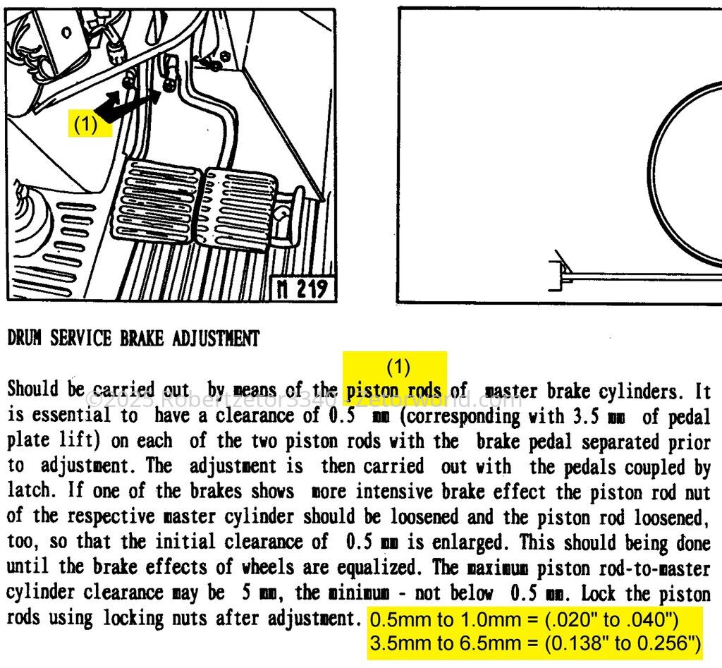

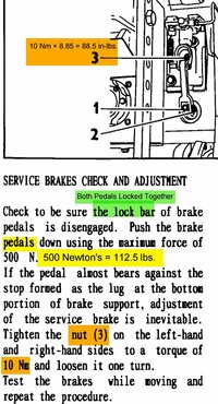

Will also recheck the Brake Pedals adjustments and with the rear Nut (3) adjustment too.
For now I have backed off the Nut (3) adjustment which seems to be a working help .
After starting the engine I will need to press the Brake Pedals several times to pump them up,
so that the Brake Pedals are not traveling all the way down when stopping.
This is working, as it is taking a long time for the Brake Fluid to return to it normal place.
