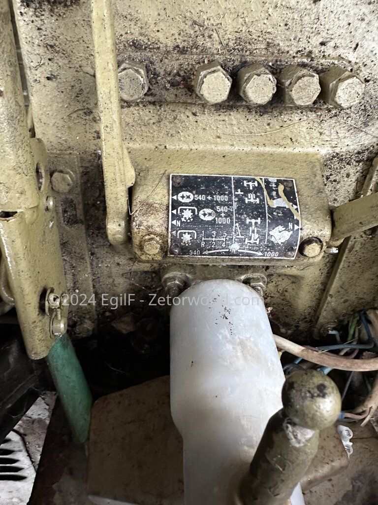

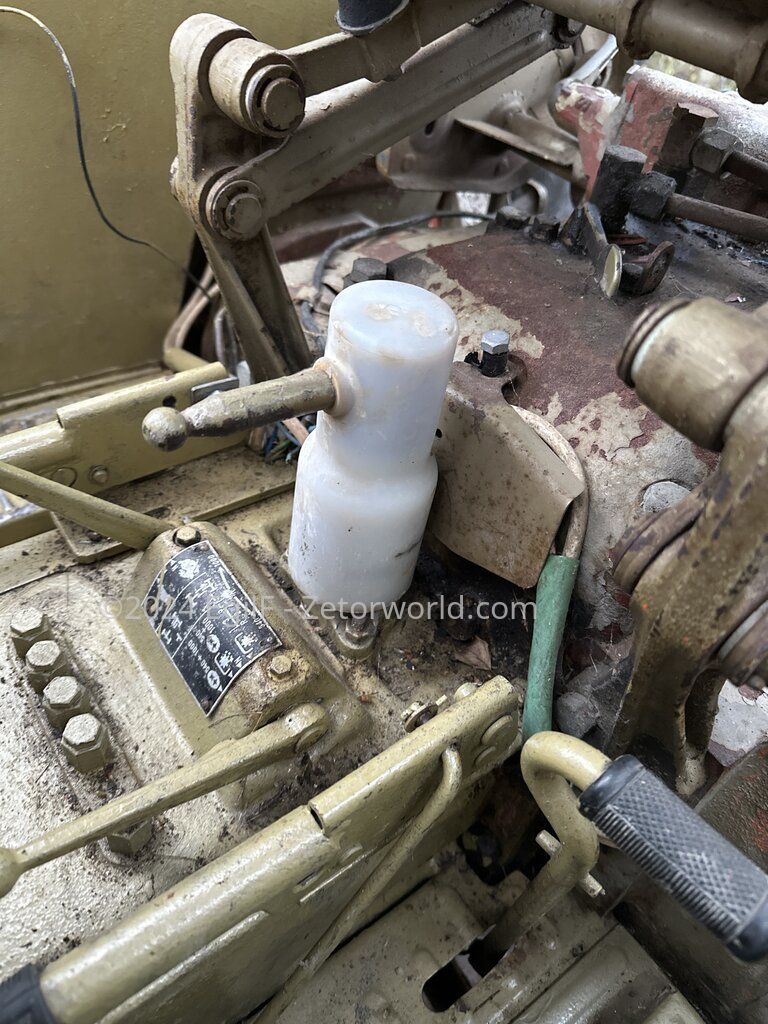

Lever 6 (picture 5) is at 540 or 1,000 rpm pto and not at neutral?
Lever 4 (picture 4) is in the lowest or 2nd position from the bottom?
Lever 2 (picture 3) is at bottom?
Lever 4 (picture 6) is set on max?
If you can answer all 4 with yes and the hydraulic wont work - yes, then its time to look deeper. The clutch is a good idea...

thanks for the reply,
with the levers all as per your post nothing works, no PTO and no hydraulics.

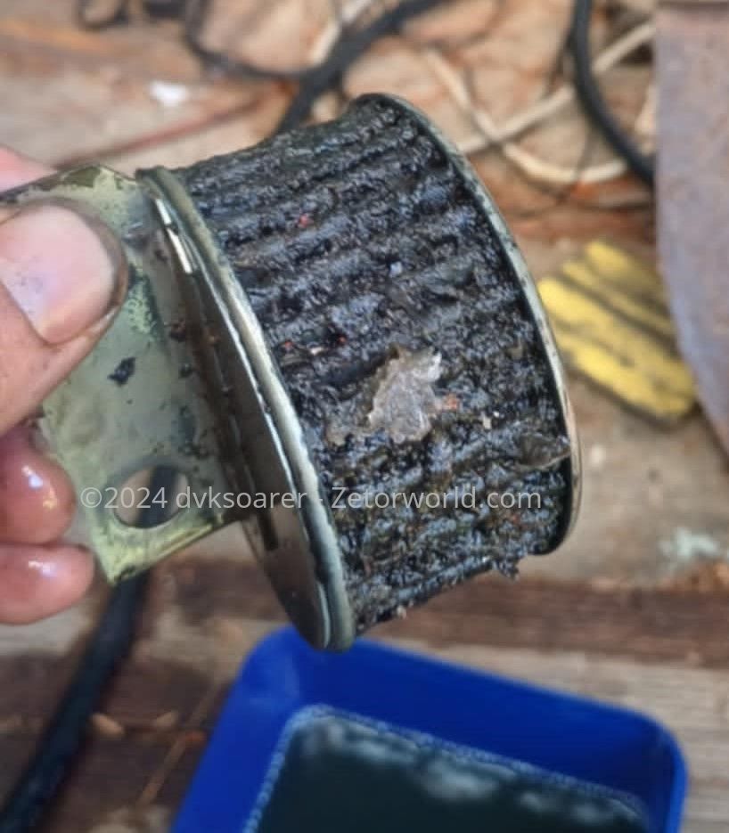

Right i have an update.
Ive pulled the hydraulic pump and cleaned the filter, this may be be the most neglected filter in history.
Ive attached a photo for you all to laugh/cry over.
