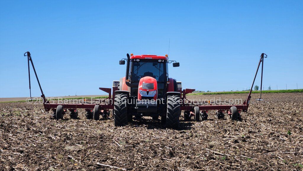

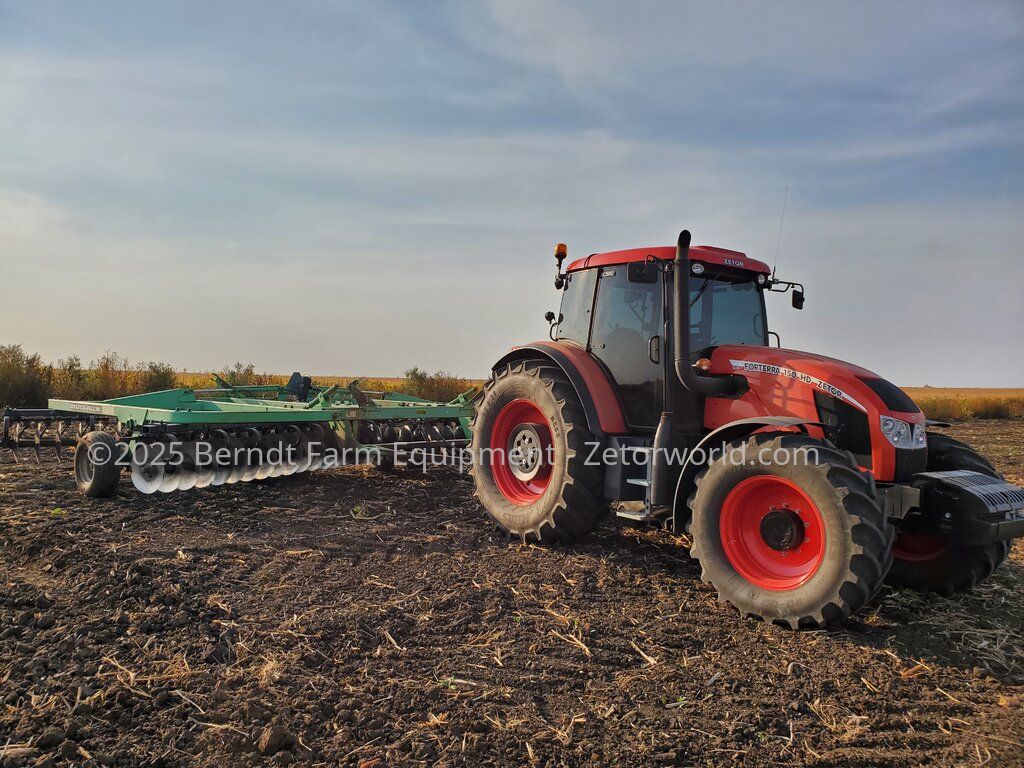

Here are the main differences between the HSX and HD that we've sold in the USA.

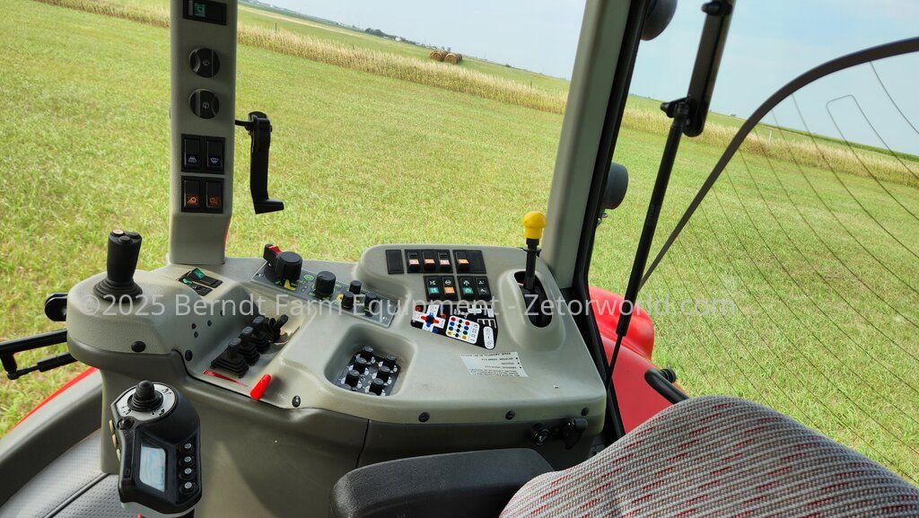

• The biggest difference to me is the hydraulic controls in the cab. The HD has electronically controlled remotes with flow control and timed detent.
• The HD also has 4 remotes where the HSX has three.
• The HD has a heavier front axle with 10 bolt wheels and optional suspension.
• Longer wheelbase and also a wider rear end.
• The HD also comes with a bigger hydraulic pump with some more flow. I don't have the exact numbers at the moment.
As far as power, we have no complaints with the 150HD that we run, it pulls a 25ft disc and 12 row planter well. And pretty fuel efficient as well.
Overall we are happy with our HD. We have run HSX's as well and the 150 does feel like more tractor.
