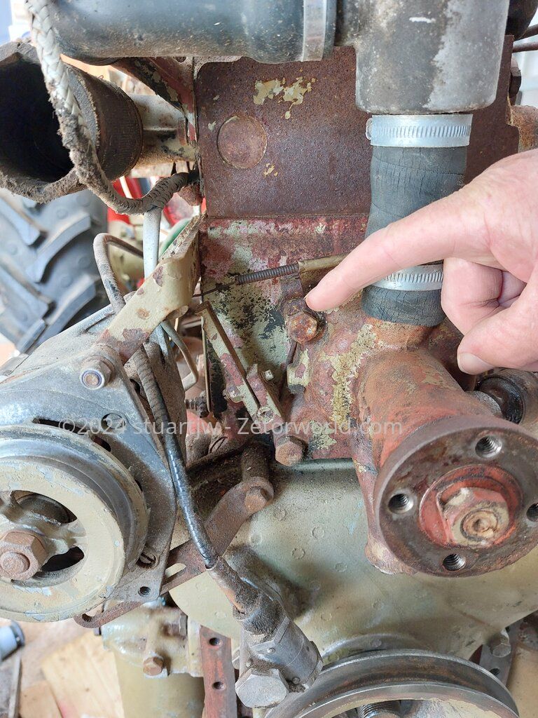

question Decompression lever function? Zetor 3511
This is the decompression function. Mainly used when starting the engine in cold weather.

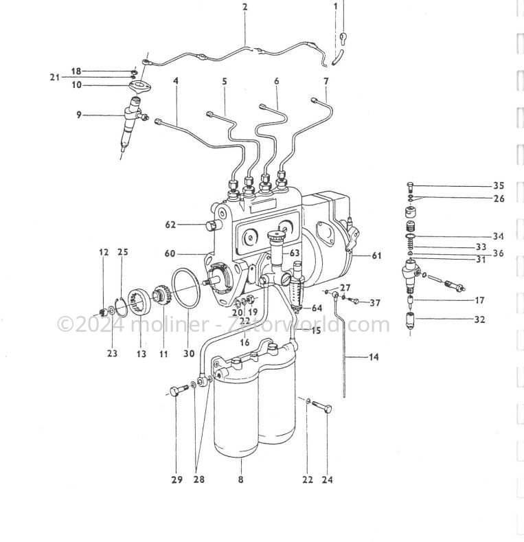

I have never used this function. I only use the "cold start button" on the fuel pump (shown as 62 in attached drawing)
Starts every time, in all temperatures.
If your battery is bad/low, you can consider using the decompression to ease the start process.
