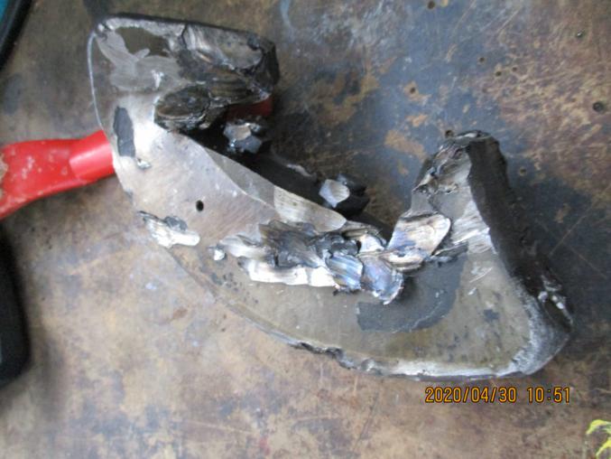

Started topping field there was a knocking noise then smoke pouring out. Found hole in side of crankcase, by number 4, conrod broken and bottom part of piston and also weight ballancer.
I assume this is the end of my Zetor 6718.
David
Is that hole in the sump? or higher up. It looks curtains otherwise.
You may go buy an engine block, there is no way of repairing that hole.
