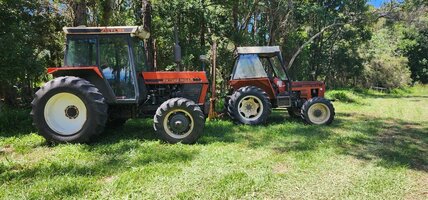

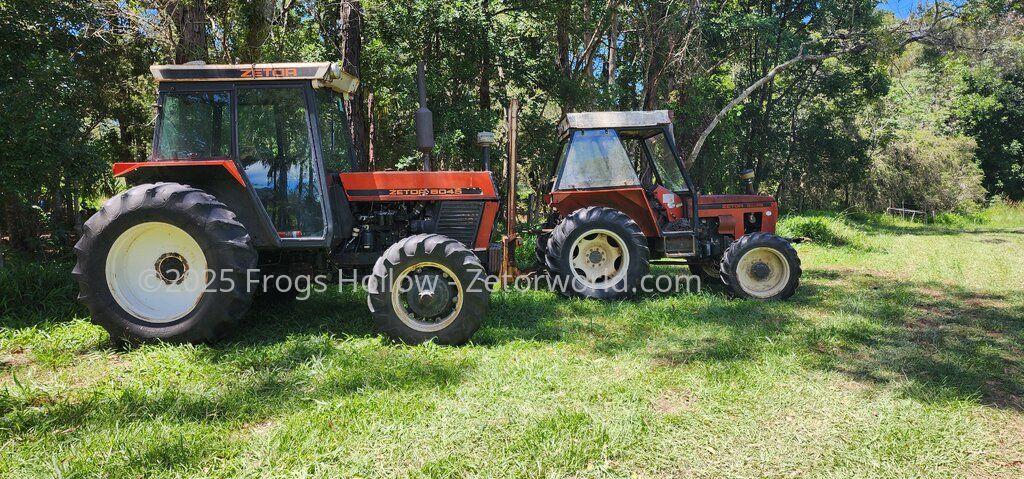

Gday , I'm from Valla NSW AUSTRALIA
I've owned a 5245 since 1998 .
I've just bought an 8045 as well .
When allowed I'd like to know more about operating it . The levers and button and switches etc .
Love my Zetors
Des

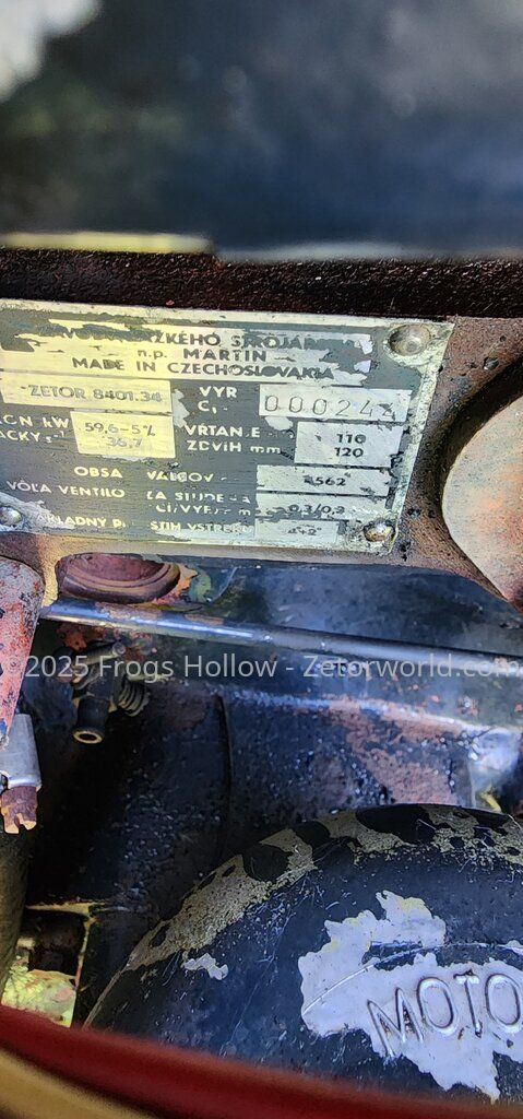

I'll attach a photo of the plate with info about model etc . Anyway of telling what year ?
This is my 2 Zetors
Thats only the engines id-plate. Do you find some other inside the cab eg.?
You should also find a year and month in your gearbox housing, outside on the left or right side. Thats the date the housing is made.
You can find a year date on the sump housing on the left side. You'll also find a year stamped on the back rims between the stud holes. There should be a VIN plate under the dash and a plate on the cab frame. All these places should have a year stamped.

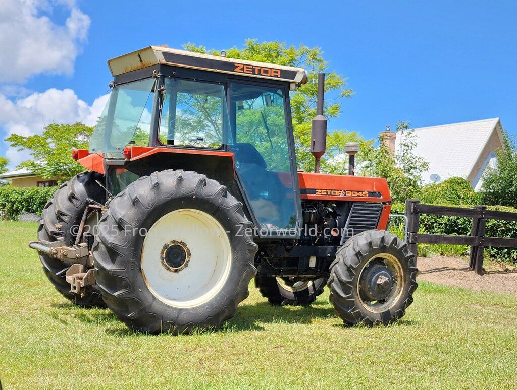

I like the cab on your 8045, It would make an old tractor look very modern.
The cab is great .
Unfortunately the rhs door must have broken at some stage and a fixed glass door has been fitted
The door on the lhs has no glass atm
Sorry, that's fixed glass window
My 5245 has the same style cab
No your 5245 has what I would call as a cab off an 8111 type tractor. We had a discussion about those style cabs on this group only lately. They were never brought into this country with that style cab, we only got the standard square original cabs fitted to them.
