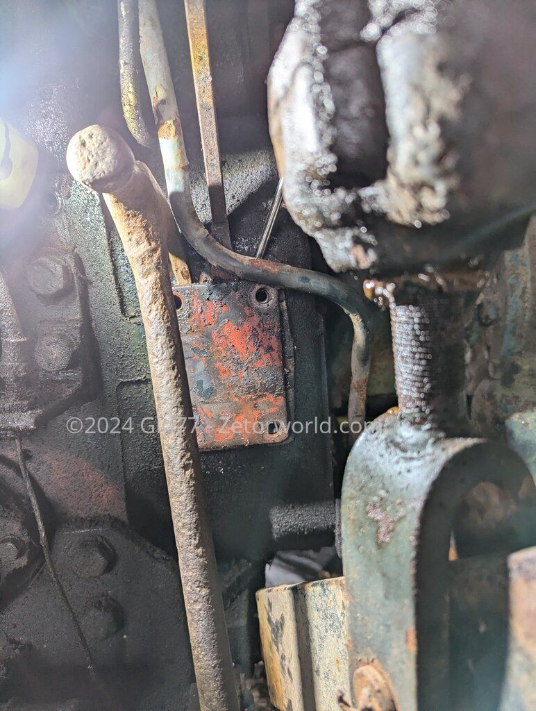

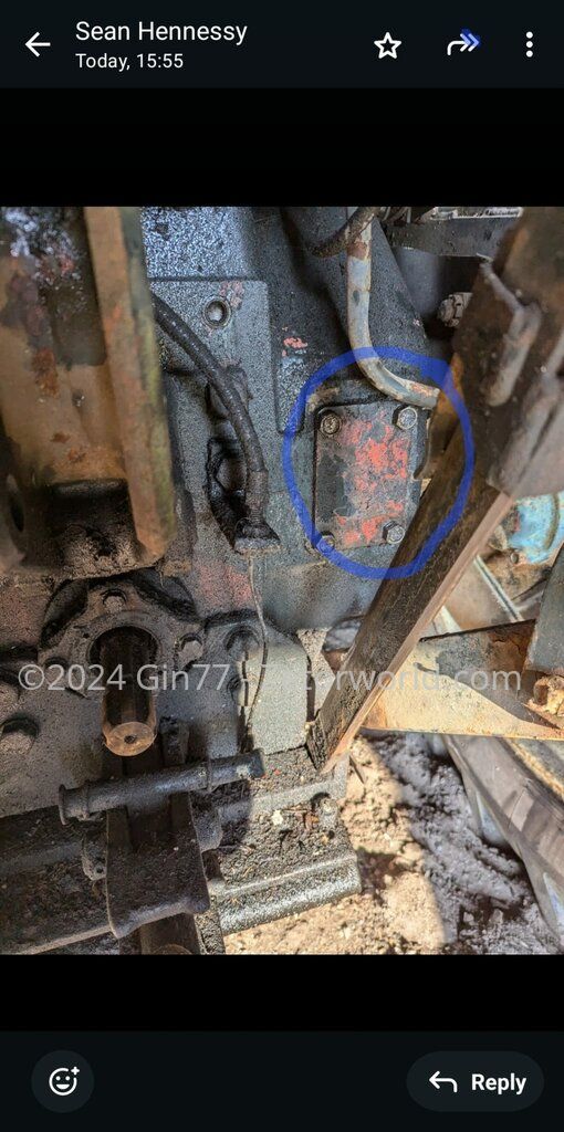

Hi everyone,
I'm currently working on my late father’s Zetor 7011 tractor, which holds a lot of sentimental value to me. It's been lying idle for the past 6 years, but I recently decided to get it back up and running. After replacing the battery, I was surprised (and relieved!) to hear it start up again!
However, I’ve hit a bit of a snag— the right rear wheel is stuck, and I’m trying to figure out the best way to get it moving. I’m still learning as I go, so any advice or tips on how to approach this would be greatly appreciated!
Looking forward to connecting with others who share a passion for restoring and working on tractors.
Thanks,
Sean

Hello and welcome Sean! :)
You made a mistake there, you shouldn't remove the plate with the 4 screws, if the mechanism behind it falls apart you will hardly be able to avoid removing the whole portal, because you can normally only put the mechanism back together if the portal is removed.

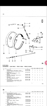

Thank you so much for pointing out where I went wrong, I really appreciate the advice! I haven’t changed the brake fluid yet. Do you think draining it and trying to drive might help release the brake? It could help rule out the handbrake issue.
I also read that there’s an adjustable nut under the matt in the cab, just above the half axle, that can release the handbrake tension—does that sound right to you? Would love to hear your thoughts!

Yes, but if you start fiddling with it without a plan, especially without knowing whether the handbrake OR the footbrake is on, you will only adjust the handbrake and possibly make things worse.
The workshop manual describes in detail how to adjust the handbrake.
Therefore: BEFORE you disassemble and/or adjust everything, first check whether the handbrake is not already loose. To do this, remove the gill plate so that you can look at the brake drums from above. The plate is only secured at the front with an M6 screw.
If the brake band is loose, so that you can move it back and forth a little with your screwdriver, the handbrake is not to blame...
