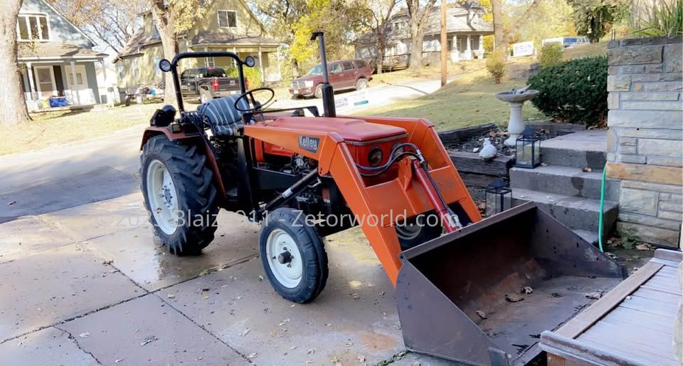

Hello my name is Justin and I recently acquired a Zebra 3520.
Here is a picture of the tractor. It needs some TLC and currently in the process of replacing the head gaskets.
Hello and welcome Justin! :)
Is the Zebra 3520 similar to the Zetor 3511 ? Can you pleas take some more detailed photos from your tractor please?
@Joachim from what I can tell it is similar to the Zetor 3511. I will work on getting some more pictures. I currently have the heads off and ordered a gasket set, but was informed they are out of stock and order was canceled. So back on the search :)
