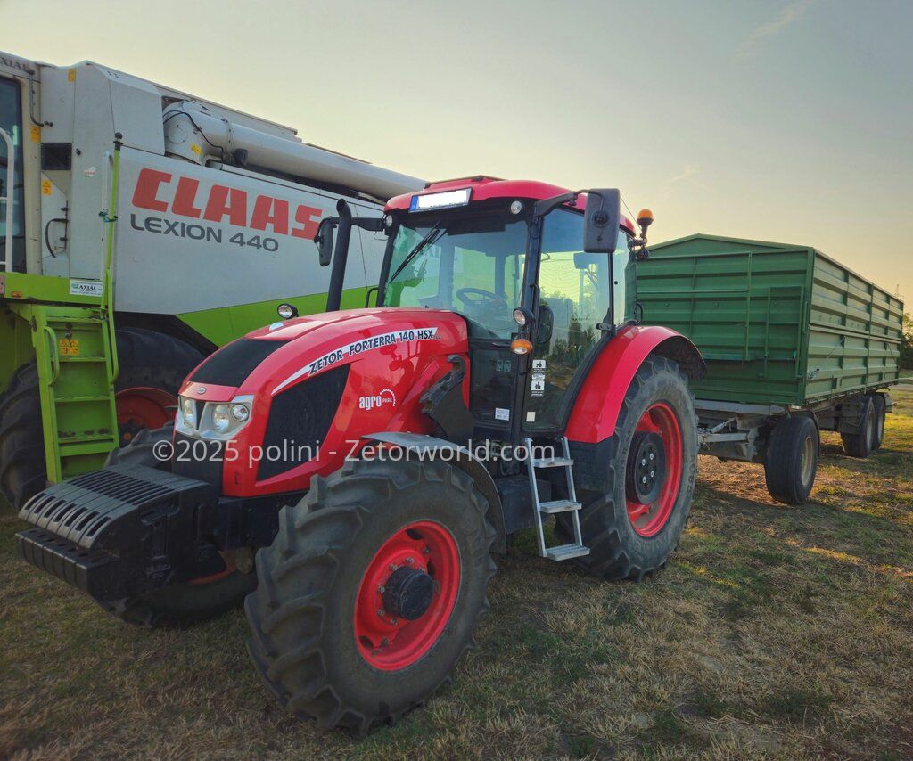

Hello everyone, this is my tractor.

Nice Zetor and Claas do you have - how big is your farm? :)

I work on 150 hectares.
Hello, I have a HSX 140 too. What year is your tractor? I notice yours doesn't have solid rims front or back.
