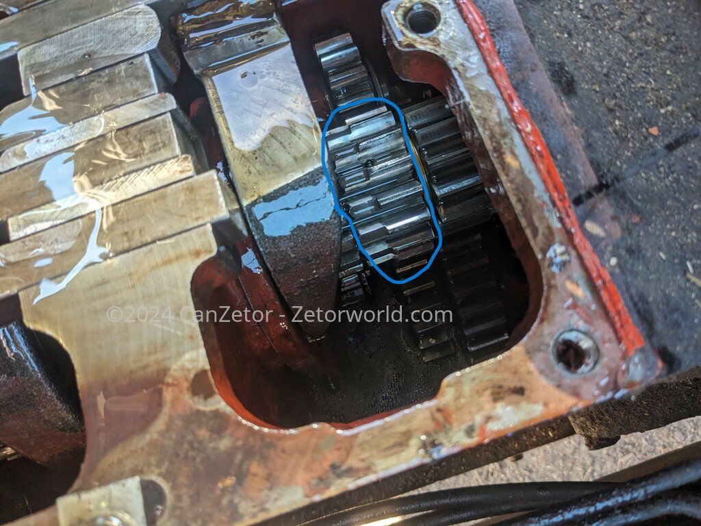

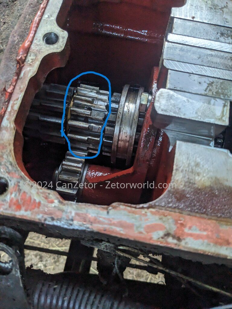

I have a 1999 Zetor 7341 that has been making a grinding noise anytime you are backing down a hill. It will not grind if the tractor is backing up a hill or pushing something. I purchased the tractor three years ago and it was grinding then. I recently split the tractor this past winter and replaced all of the bearings and a few shafts in the speed reverser assembly. It was good for about five months but is now starting to grind again. I will attach some photos of the reverse gear that seems to have some play in it. I'm unsure if there are any adjustments that could be made as to not wear the bearings out.
Here are a couple of pics of the speed reverser assembly. the gear that is circled has a bit of play up and down. Maybe 3/16". I am not positive what is grinding.
I would suspect the needle bearing in the idler gear.

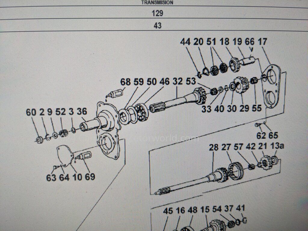

I noticed that in the diagram of the speed reverser that the idler gear is mounted on the other side of the transmission, opposite mine. Probably nothing because I do not see how it could be flipped. Here is a picture of the diagram anyways.

Hey, thanks for the reply. Yes, grinding noise only occurs when reversing and without load (downhill). I did something which may be frowned upon and drove the tractor with the transmission cover off. It was difficult to see past all of the oil being flung up but I'm pretty sure it is the gear that I circled in my previous reply. It has a bit of play up and down, maybe 3/16", I cant figure out why those bearings would have gone bad so fast.

Then i assume spigot bearing no. 57
Forward, the shafts aŕe connected directly by the shift collar. In reverse, the spigot bearing has to center the gears, when it is gone, it causes misalignment which causes noise and explains the grinding into gear.

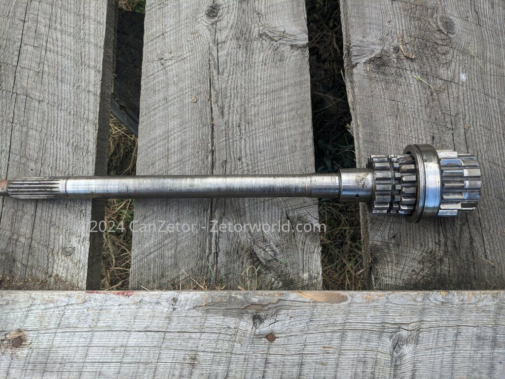

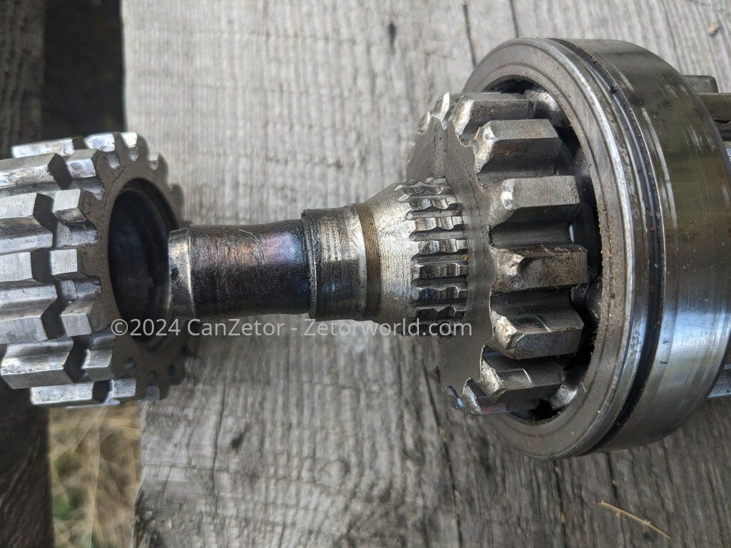

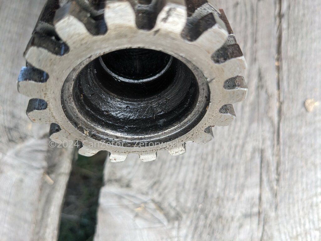

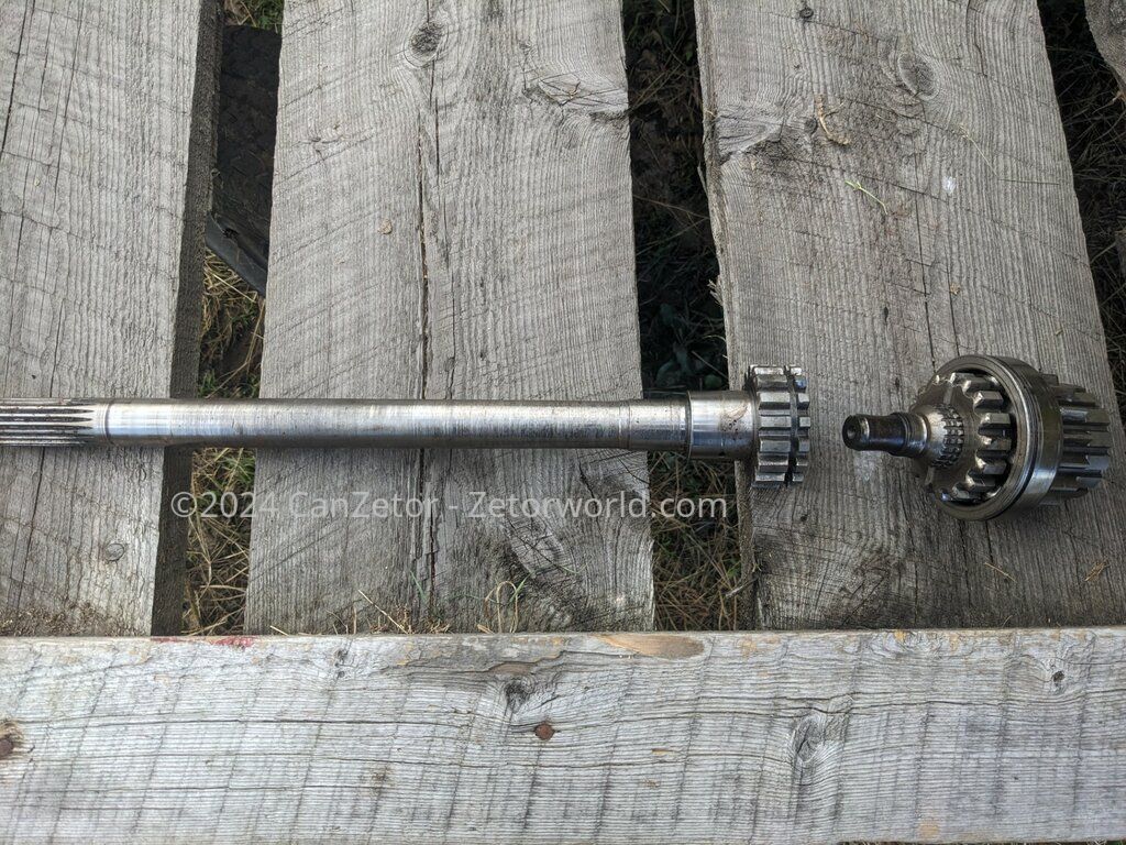

Tractor has not been run low on oil since I have changed all of the bearings. Unsure if it has been prior to that as I have only had it for a couple of years. Interesting guess with the spigot bearing (no.57). When I split the tractor this past winter that spigot bearing and retaining clip (no.42) were totally missing. I ended up cutting open the hydraulic filter and found the remnants in there. It badly scored the clutch shaft (no.2:cool: and the driving shaft (no.15). I ended up replacing both and all corresponding bearings.
There must be some sort of improper adjustment somewhere because it is getting plenty of oil flung up onto those shafts. I will post some pictures later of the shafts that I replaced. Hope this information helps, I'm quite new to the world of Zetor mostly been working on David Brown's up till this point.
