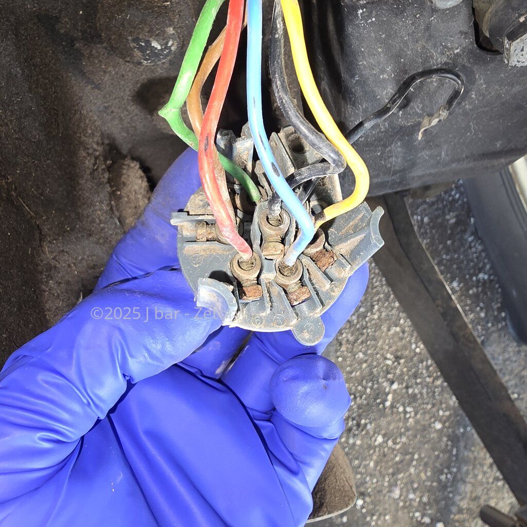

question How to electrical plug a New Holland RB 460 round baler at Zetor 7320?
J bar
May 17, 2025
Texas, USA
Zetor 7320
How to rewire my 7 pin Zetor 7320 trailer plug to match a New Holland RB 460 round baler?
All 7 pin trailer plugs and sockets are wired up to a standard everywhere. So your baler could be different to the tractor.
  • 1 is left indicator yellow.
  • 2 is sometimes blank it's blue.
  • 3 is earth white.
  • 4 is right indicator green.
  • 5 is right tail light brown.
  • 6 is brake light red.
  • 7 is left tail light black.
