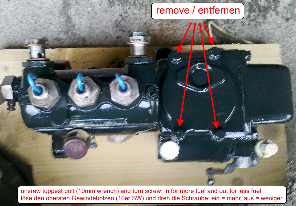

Hello Renze,
what you mean with "take the back cover off" ?
On the back side from fuel pump is no cover to take off. Did you mean the cover on top, holded with 4 scroubs?
Or can you make a photo? :)
regards
Did you mean it so: https://zetorworld.com/index.php?threads/horsepower-increase.524/
I have made a pic for better understanding, you know iam from germany... ;)
full
Its so right? :
srew in = more fuel = more black smoke = more power
screw out = less fuel = less black smoke = less power
Regards

To be honest this governor looks different than the 3011/4712 type AND the 5245 type. Is the cold start button locked with a locknut ?

On the 3011 and 4712 (both have the same pump model) the fuel setting was adjusted by the cold start button:
the head can swivel on the threaded tube, and the threaded tube is secured against the pump body with a low nut. Undo the nut, then screw the threaded tube into the fuel pump body and secure the locknut again, then turn the cold start button back to where you can push it. Even if the governor is slightly different, if it has the manual cold start button it must be the max fuel adjustment too.
Hello,
optional_title said:
the head can swivel on the threaded tube, and the threaded tube is secured against the pump body with a low nut.[/]
Yes, I think I can see it and as you say I should do this:
full
If I screw in I'll increase the fuel and if I it screw out I will decrease it - is it also right? If so, I can now reduce the fuel to try to reduce black smoke... :)
Thank you Renze to clearify this.
Ha ...
... thanks. It was a long way to understand, but now its clear. :)
Sorry i didnt read it properly on the cellphone during lunch break: If you screw it in you decrease fuel , screwing out is increase of fuel.
