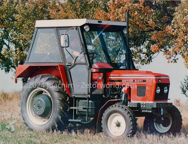

I never seen that style cab on any model tractor in Ireland, where they only exported to certain countries?
possible...
Its the slawakian cab version, litle bit smaller than the BK 6011, but metal roof instead of GFK and so better for forest workers. But in hot summers, the czech BK 6011 would be much better to cool as the BK 7011 with metal roof.

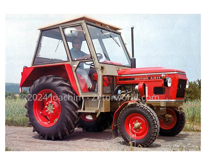

First generation on series 9

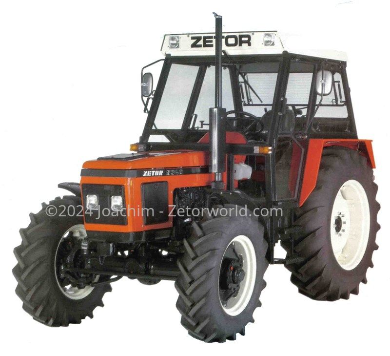

4. and last generation on 3320 up to 7340 Turbo:

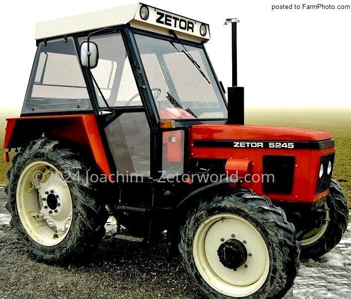

The 6011 picture were here OK, But the 7245 with a Crystal cab is different. All them other pictures would never get in Ireland, they all looked like the one in your profile picture.

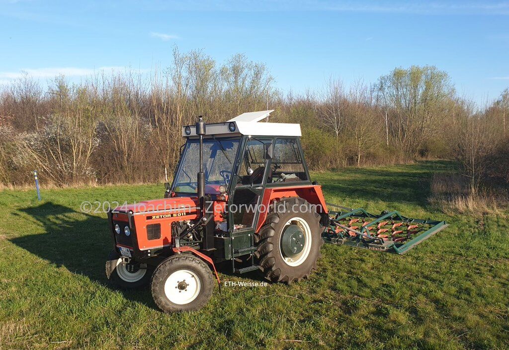

I have a Zetor 5011 from 1984 with over 8.000 h with the series small cab:
OK, it even has the roof of the BK 7011 cabin from the successor (I converted it like that because I wanted a roof hatch and because I was given the roof as a gift) and the rear window is also frameless (converted myself) and instead of the standard latch it has a 3-stage locking mechanism like in the Case Maxxum.

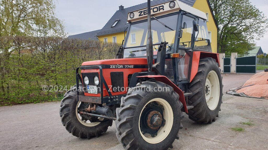

Her as last a Zetor 7745 with original slowakia cab BK 7011
This Zetor is from one out of my family - here on my yard for some reparations 2 years ago.
And before you say anything about my house, it's from around 1850 and not as big inside as it looks from the outside. A house built from clay and wood... 😁
