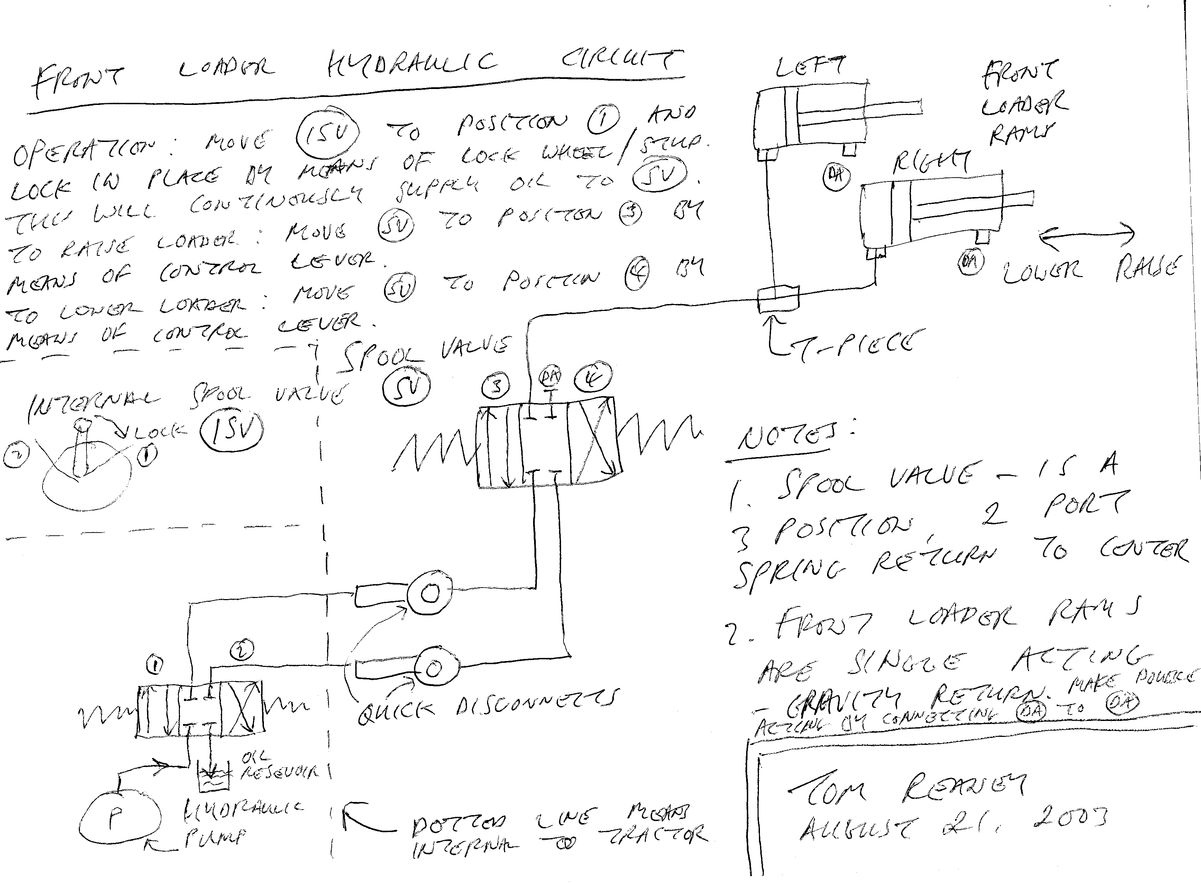

hi everybody,
i got a problem for connecting my frontliftercontroling to the hydraulicsystem. so my questions, 1. where sould i connect the permanenthydraulic input for the controller and 2. where the backflow from the controller. i don`t mean the original Zetorlever righthand side from the driversseat.
thanks and regards from germany
dieter
Tom has posted a plumbing scheme in the photo gallery.
Here it is:
