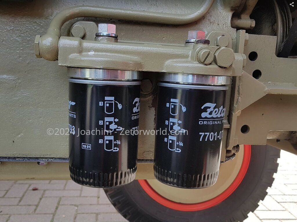

I saw a thread that said the 5011 2 stage disc oil filters can be replace with cartridge type oil filters. If this is true does anyone have the numbers for the number 1 and number 2 filter housings?
What you need are two adapter plates. I sell this system in Germany since years to many of our customers with the old double oil filtres.
new/better oil filtre system:
This will be the best way to filtre the engine oil in Zetor tractors with the old system. You than can switch to a cheaper cost engine oil like 15W-40 instead of a 10W-30 or 20W-30. Also after the first 2 oil services you can drive the oil a longer time. You can see it longer clean instead dirty black.
I also drive this system at two of my older Zetors like 2011 and 5011, its a great upgrade.
