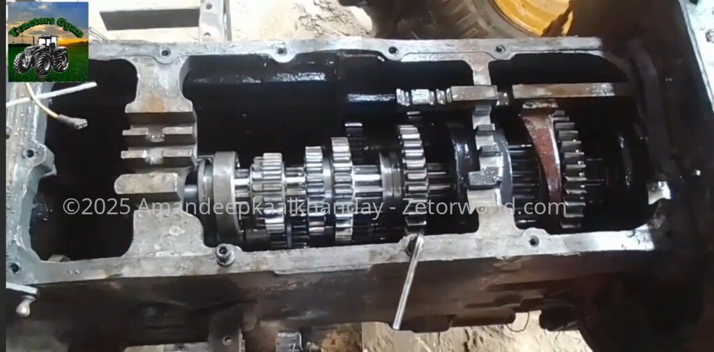

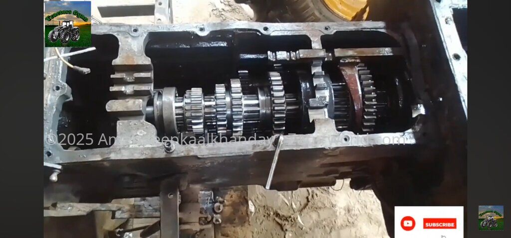

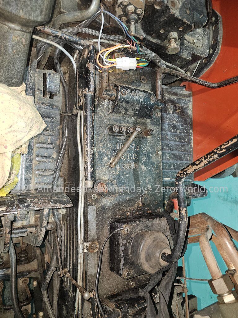

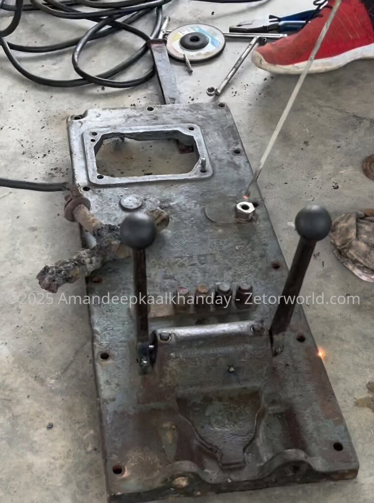

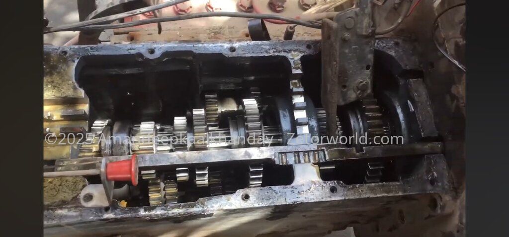

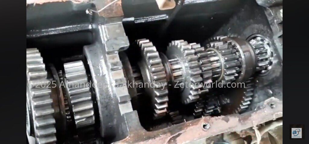

This is the gearbox and casing we have
Gearbox cover is different from 7341 but similar to 7340

The 10/10 shuttle transmission housing has a different part number because the slot for the gear selector rod is milled at a different position than the 540/1000rpm shift rod.
If there are differences in the casting to support the reverse idler gear, i dont know..
