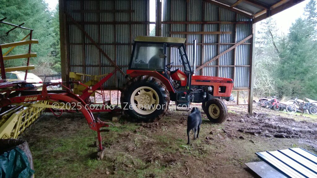

Hello, I'm cozmo and need help to find out why my crankcase was full of antifreeze and I don't think it's head gasket problem as it looks like a half gallon of antifreeze is mixed with the oil . Any suggestions.
