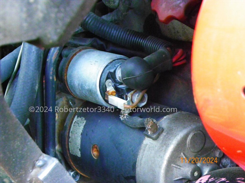

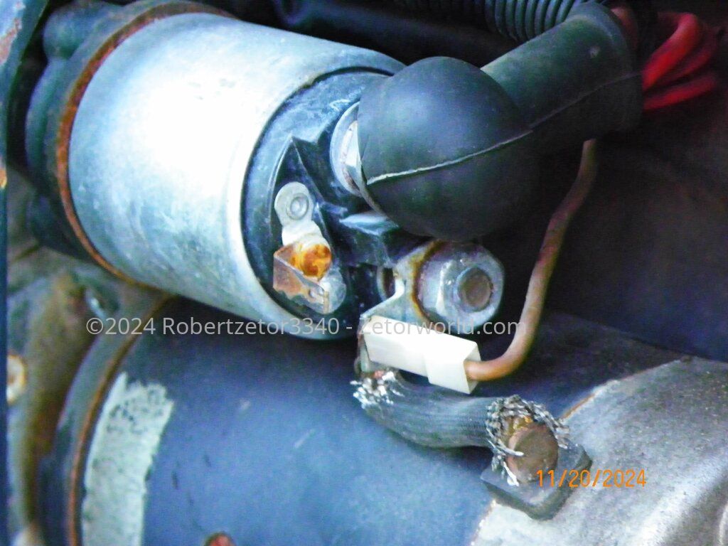

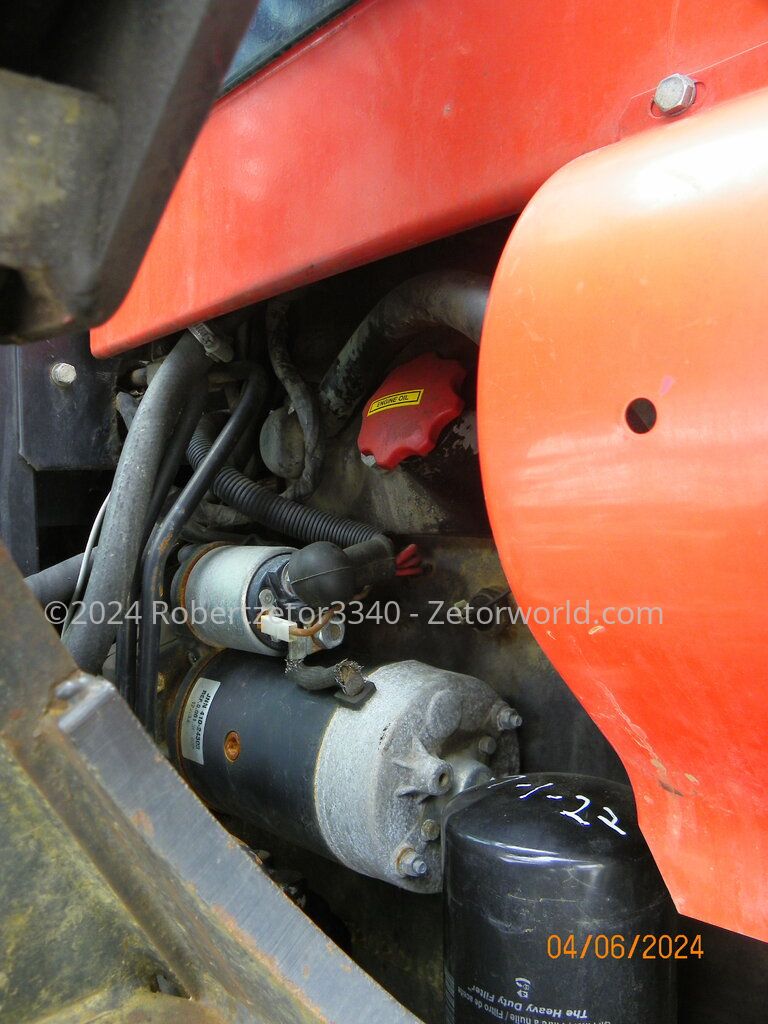

Sometimes when turning the ignition-key to start the engine, I hear the Solenoid clicking and not turning the engine over.
It dose not do it all the time and has been doing it from the time since the purchase, back February 2024.
By turning the key several-time in a row (Like 3 to 10 times) it has started the engine.
The Starter-motor seems to be strong when turning the engine over.
Can I repair this Solenoid myself ?
- Check the electrical connections between the battery and the starter (corrosion, breaks, crushing)
- Remove the starter magnet switch, clean the contacts inside (rust or contact burn-off) and if necessary smooth them out again with a file.

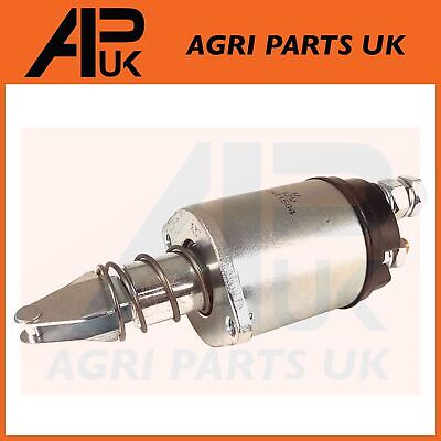

I also searched for just the Solenoid
and is this one the correct one too ? (If I need to replace it):
Thnik that shoul fit.
