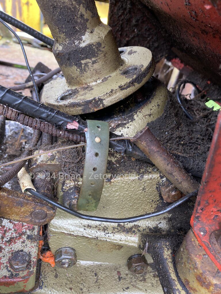

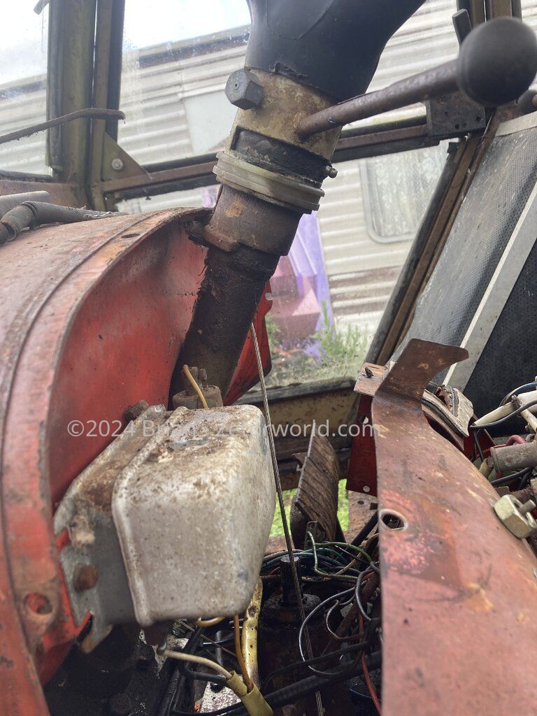

Does anyone have a photo of how the throttle cable is routed under dash please?
Mine doesnt look right and the lever is on left so it hits your legs when its engaged.
I'm guessing the steering column needs turning 180deg but how do i route the cable?

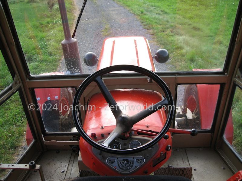

Should the trottle lever be on the right above the gear stick, so you push it away from you?
Yes, on the right side:

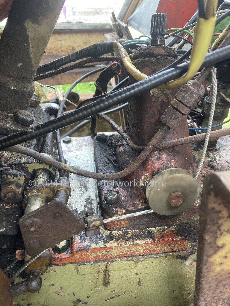

gas throttle cable:
Your plastic pulley is already quite worn. Normally there should be a PVC hose over the Bowden cable to protect the pulley.
Thanks Joachim, Does the cable just wrap around the top of the steering colmn like mine?
I mean yes.
It is hard to photograph without unscrew the dashbord.

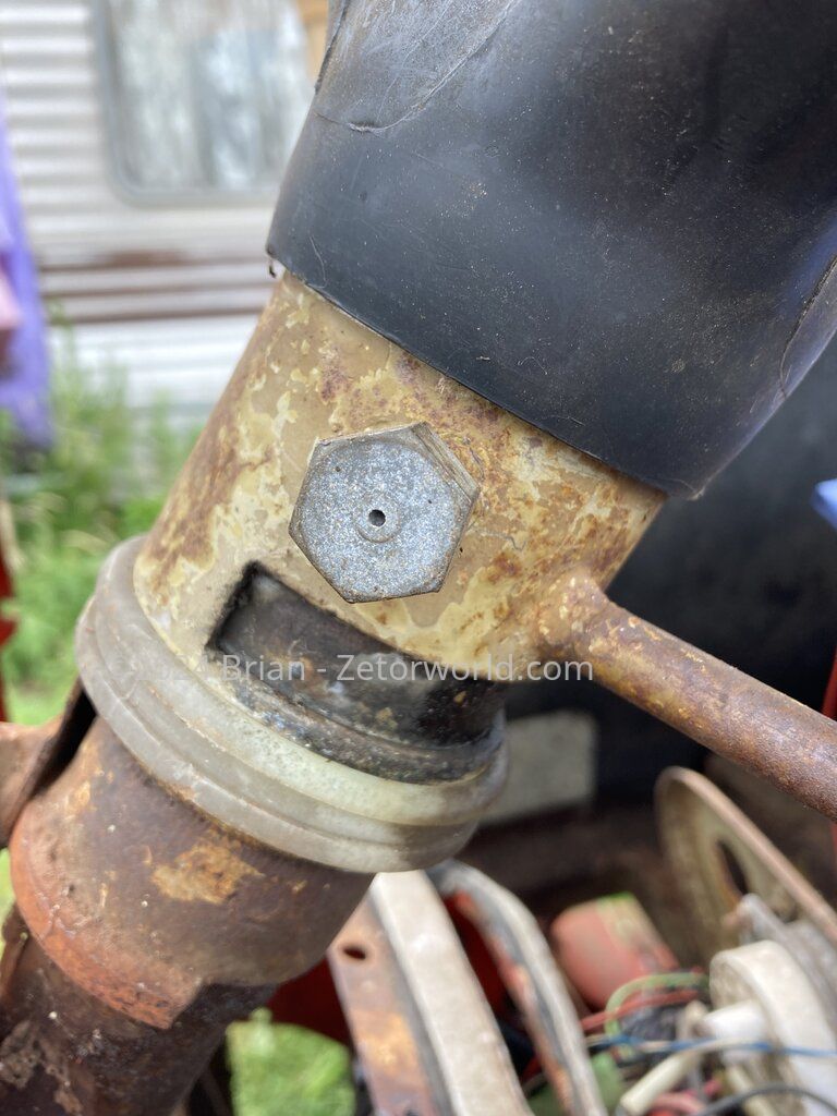

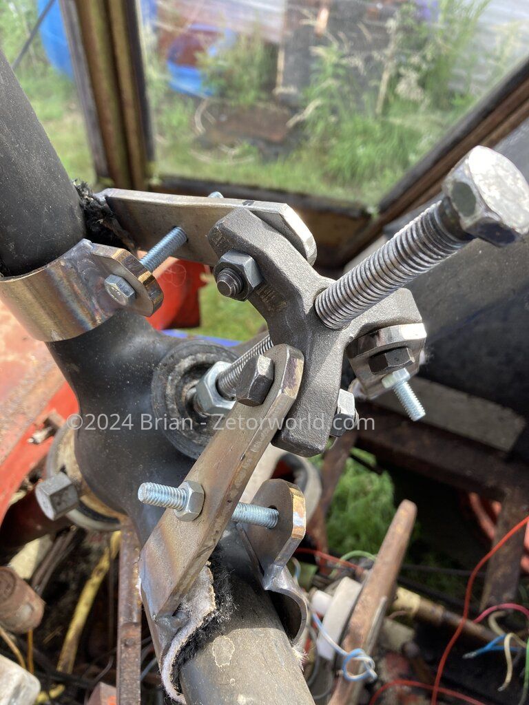

In an attempt to rotate the steering column i removed the 4 M10 nuts and started to pry the column from the box when i got a bad feeling, seams like i will be unable to get the column back in. Am i making a mistake here?
What is the purpose of this cap?

I am pretty sure it should be on the right because as it is the lever hits your knees when you use it

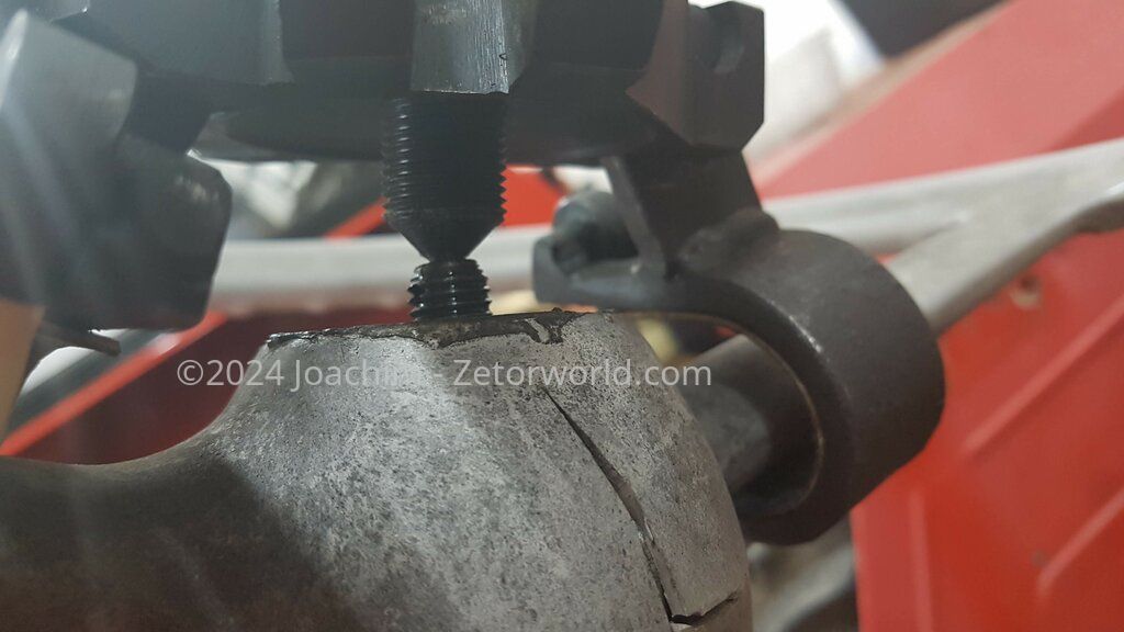

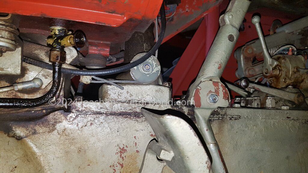

marked one is the plast tube
red = screw
green = friction inserted piece
blue = insertion
yellow = lubricating nipple
So the red one is that:

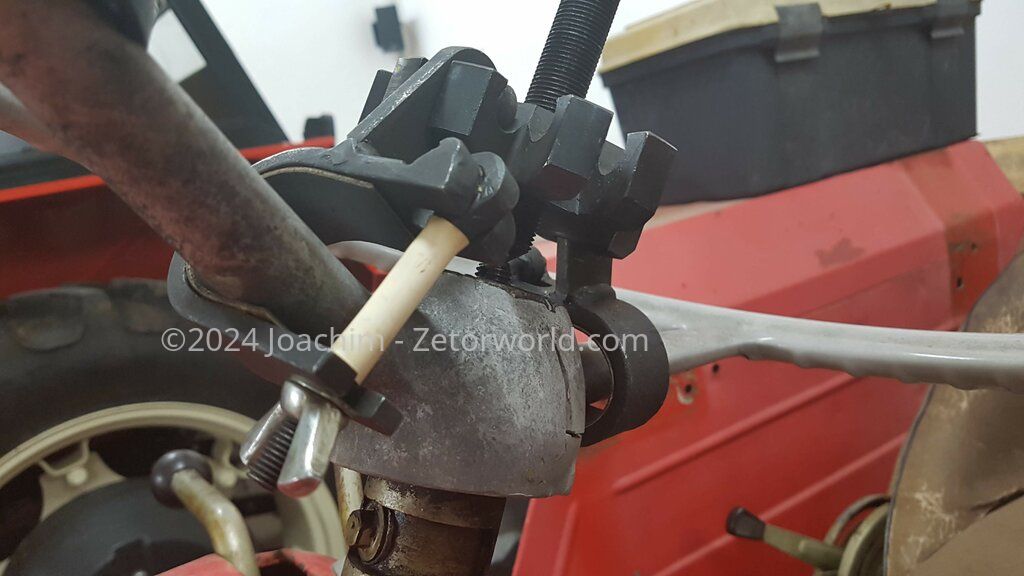

some extra info . I am unable to remove the steering wheel as it has corroded onto the shaft so when i released the bottom of the column from the steering box I assume the worm drive has moved out of position. Anyone have ideas on how to proceed?

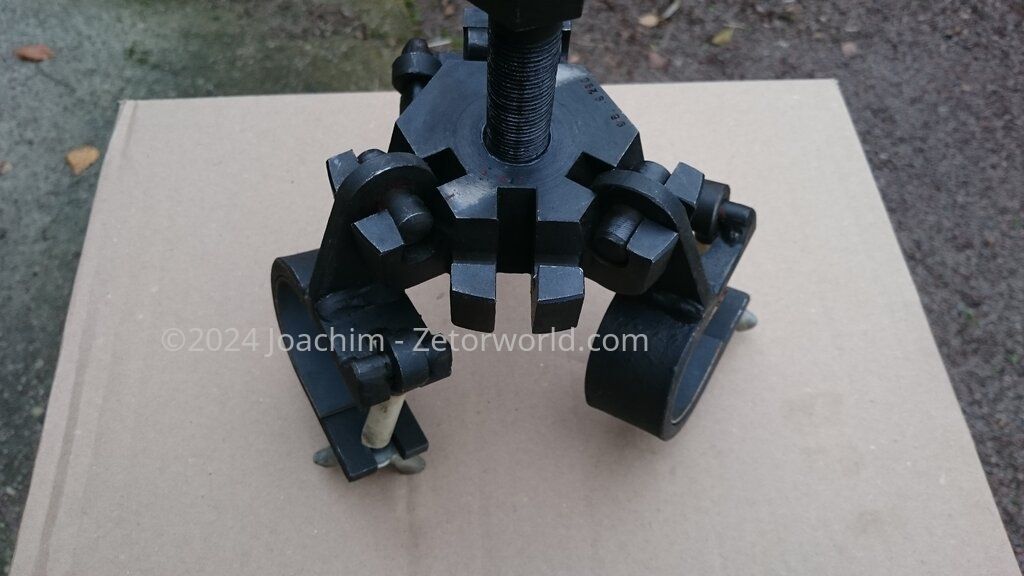

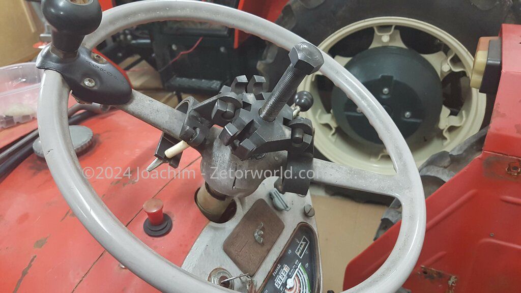

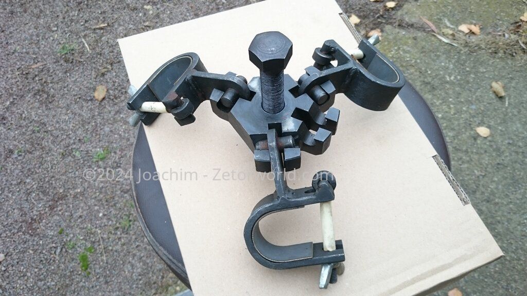

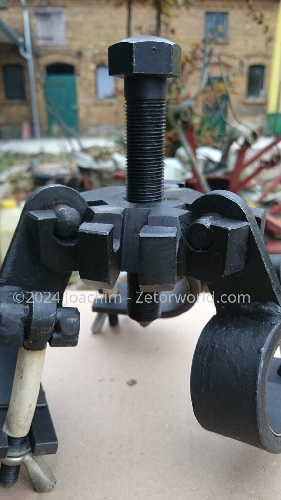

You need to spray it serveral days with WD40 or similar.
And then use a special tool like the original one:
