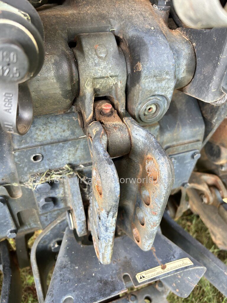

Could someone tell me if this is supposed to move where the top link attaches and if so what lever controls it.

Hello Brad.
The upper link mount is sprung and movable with a torsion bar.
The movement is only relevant if the hydraulic control lever is set to M or D.
In P it is irrelevant and P is used for everything except plowing or heavy tilling.
You can find out everything about the individual control types in the operating instructions for your tractor.
Hello Brad.
