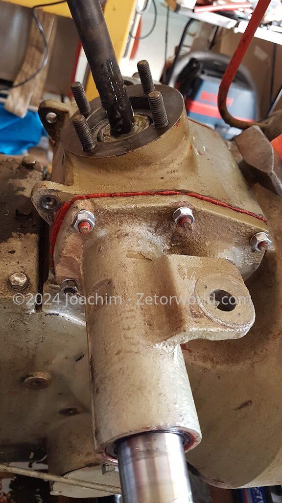

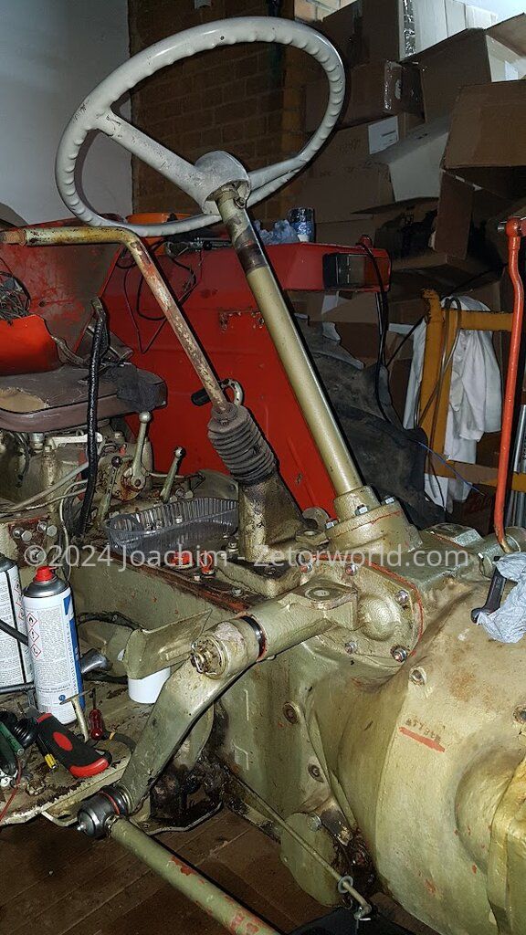

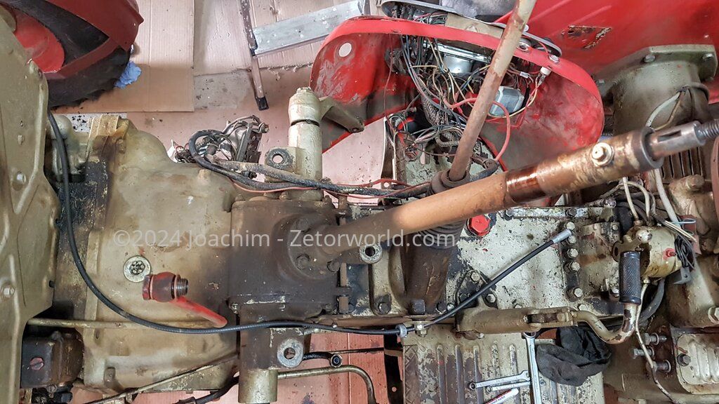

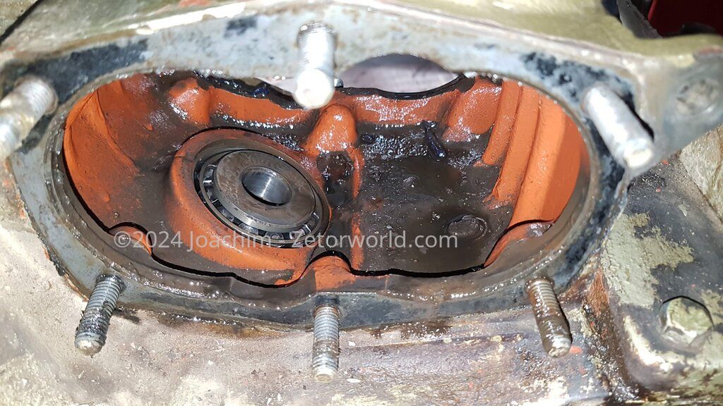

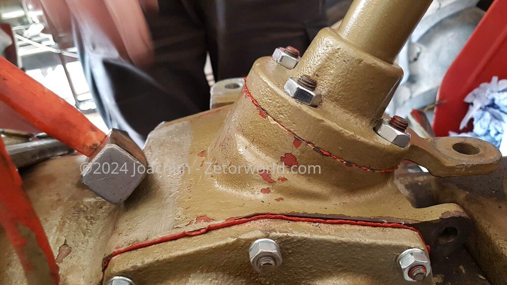

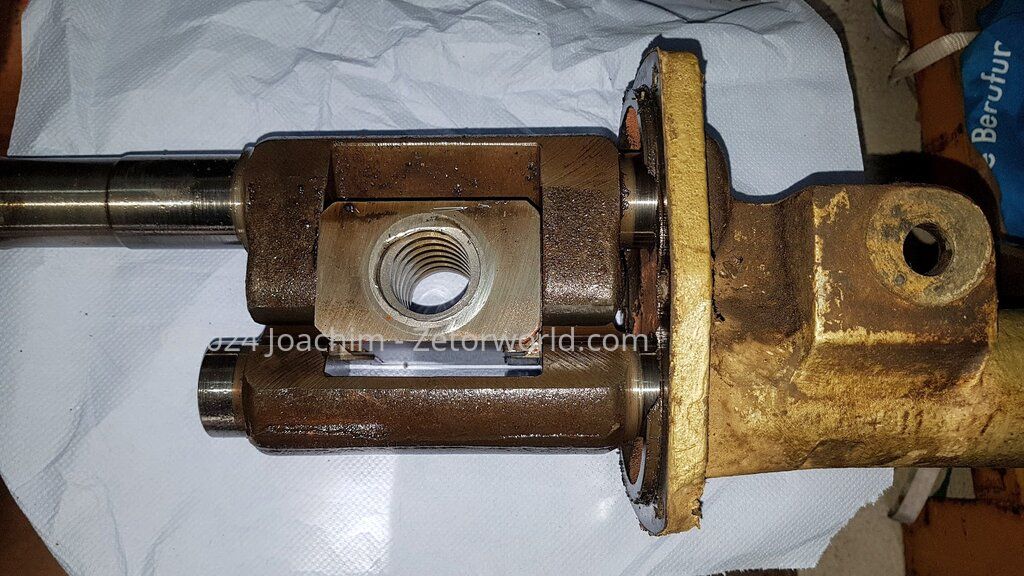

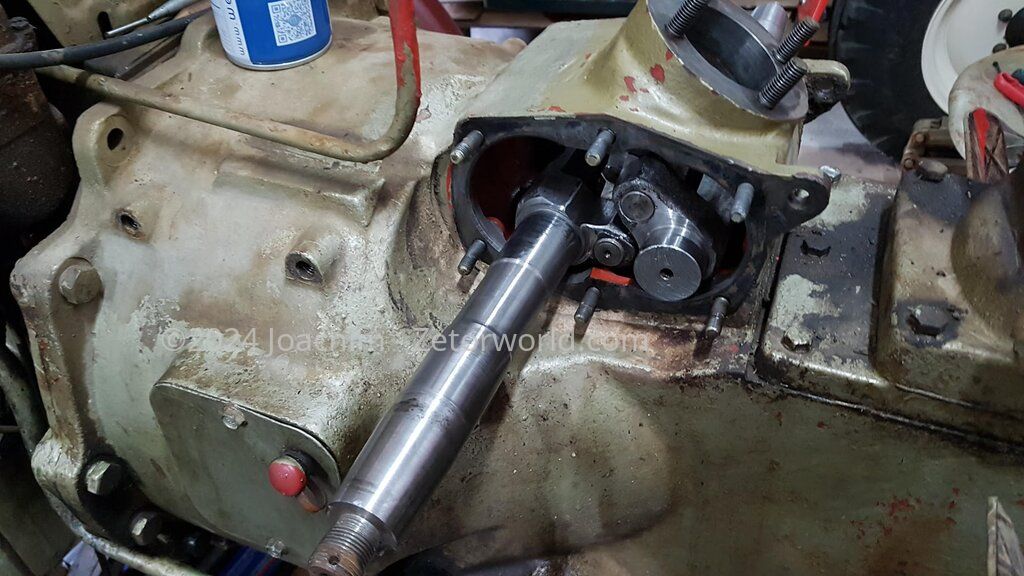

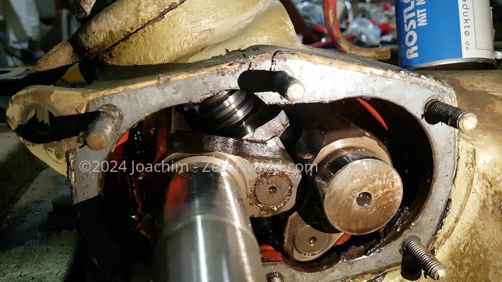

It sounds to me like you should take a look at the steering gear. Something may have broken off or there may be a bearing defect - you will have to open the steering gear to see it. But it's not a big deal with this tractor - I did the same thing with my 2011 Zetor not too long ago.

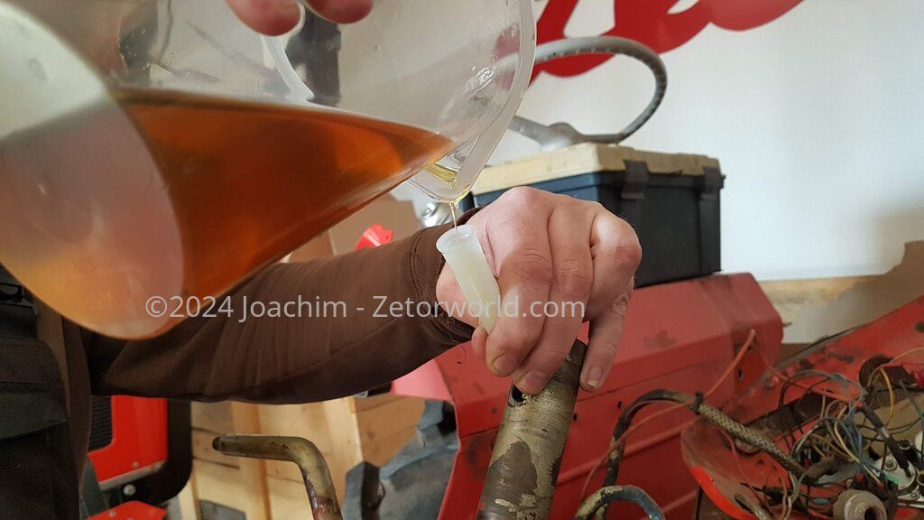

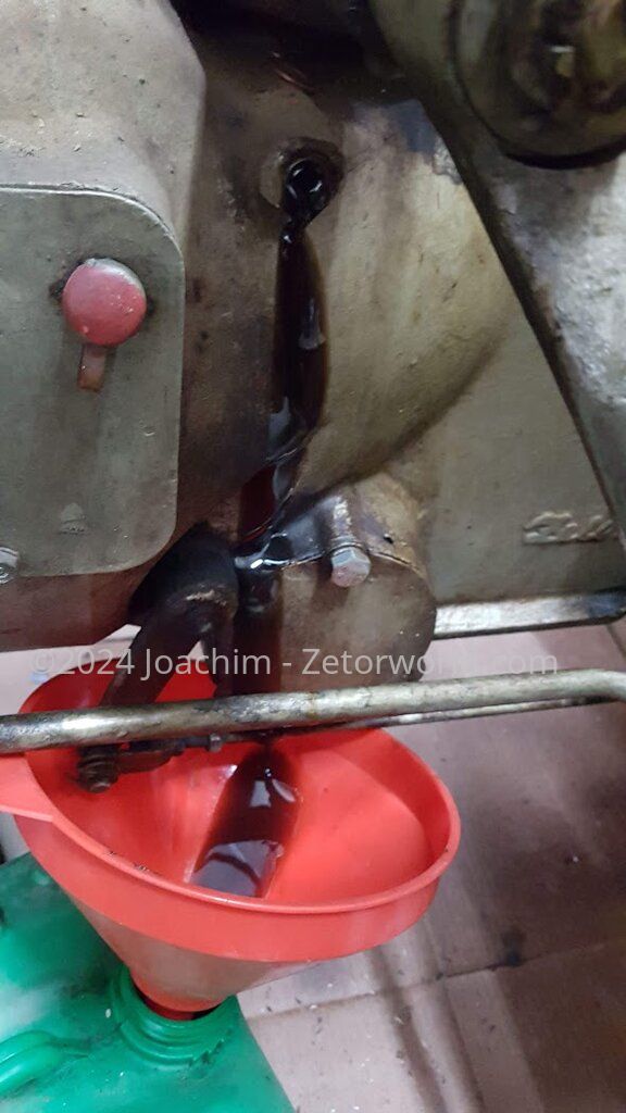

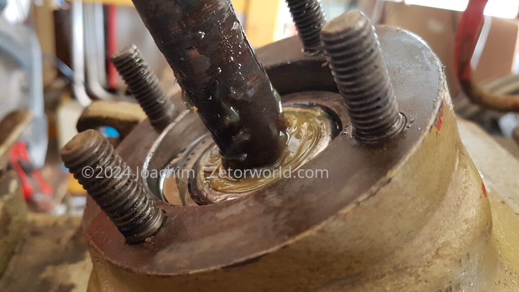

Is there oil in the steering gear?
