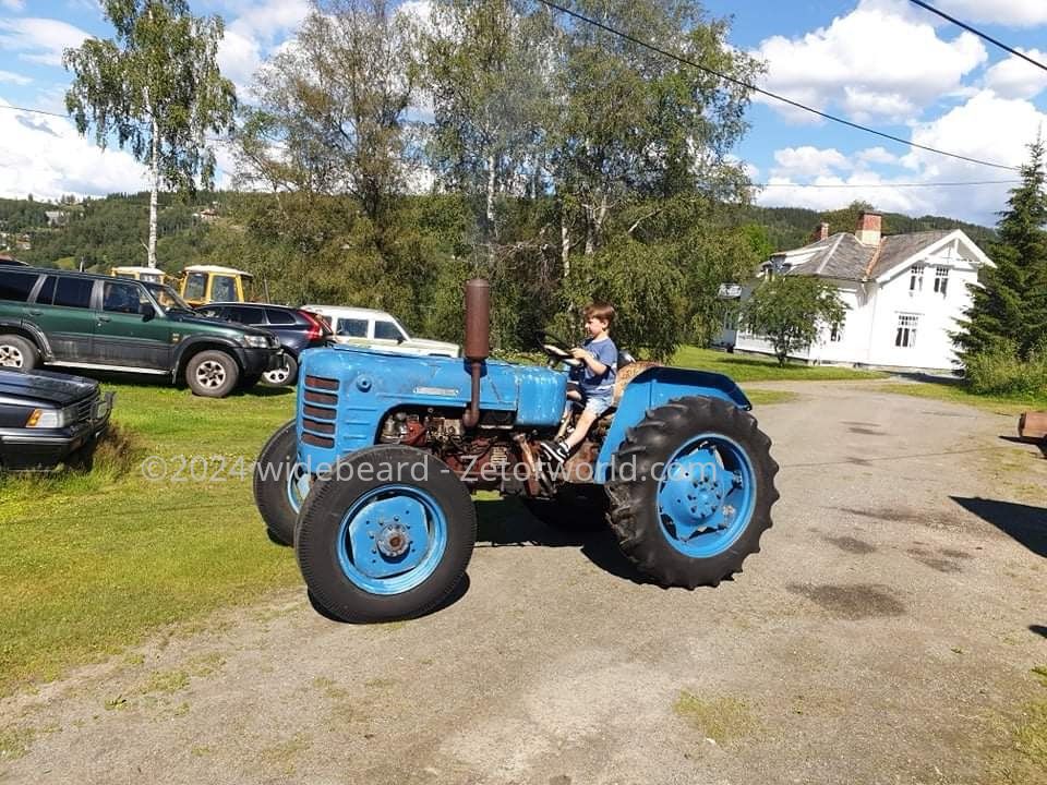

I am here because I have taken custody of my familys old Zetor 3045, the family have been in forrestry for 7 generasjons and my son is the 5th generasjon driving "old blue". It originaly had halftracks and a gondola type winch, it was primarily used in steep areas where the heavier equipment struggled. I am about to restore it now, it is really in good condition and has been in full work until this summer. The 4wd broken sometime in the 80's and was never fixed.
Are trensmission/driveline parts for these possible to get hold of?

Brilliant! Thnx! I have to pick it apart and see whats broken. Its apparently not the "usual" problem, but the transfercase that hit a treestump. I have a packed barn i need too dig through. The parts are supposedly in there somewhere😅 but somethin IS broken i just dont know what yet.

Thank you for amazing information!! The front rimelig i think are original but its some old truck tires on it now,i have ordered the correct ones
Original there was mount:
front = 8-20"
rear = 11-28"
Source: google picture search
