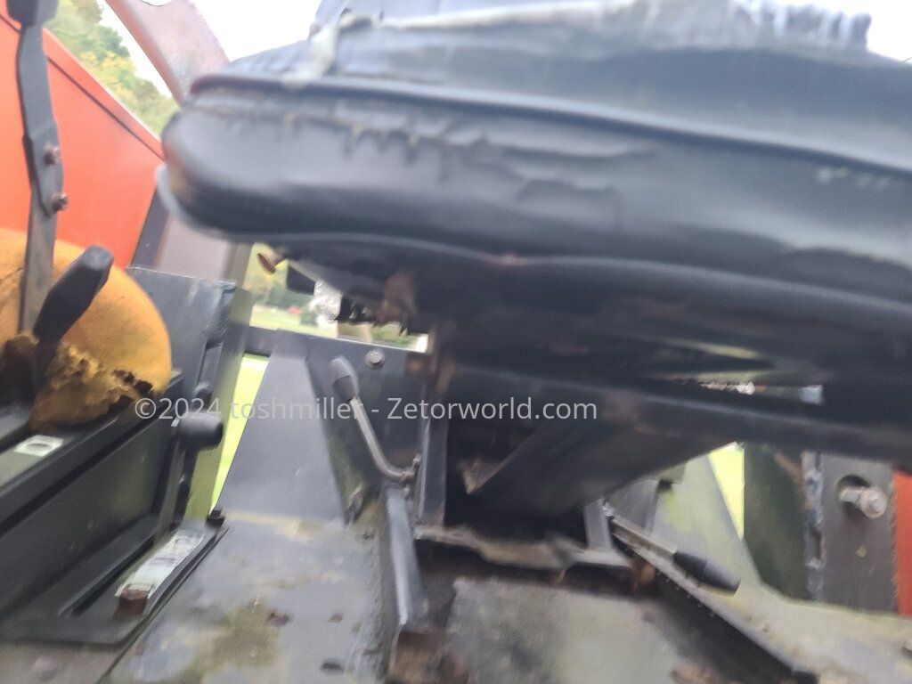

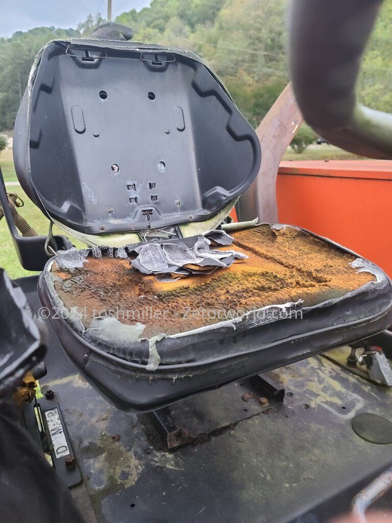

Just bought my first tractor, zetor 3340. Bought it to cut hay. First issue to tackle is the seat is trash. Its literally not much more than a frame and some rotten cushion. My question is what's a good comfortable seat that bolts directly to it that ain't super expensive? Do all generic tractor seats work or am I looking for certain ones? Any suggestions?

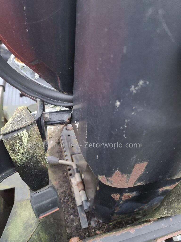

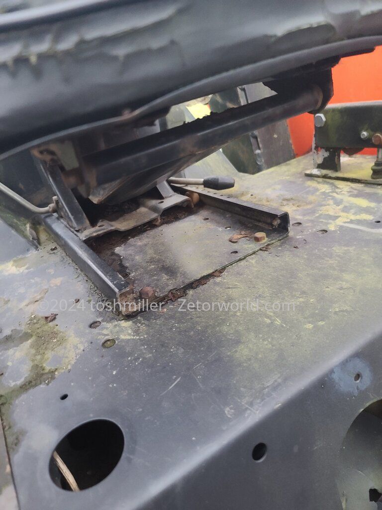

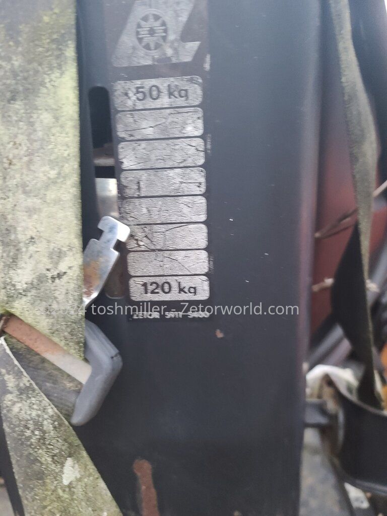

First - take some pictures of your Zetor and share it with us so we can help you better. Espacialy from the actual mounted seat. Thanks
Do you have a cabrio or a 3340 with cab? (photos? ;) )
There are many seats that can be used if we know what the current situation is with your 3340.
But there are also many that don't fit because they are too high or too wide, for example.
After looking at the photos, I'm sure I can give you a good tip.

This is the original MARS seat.
Original spare parts are easy to obtain (seat cushions, shock absorbers, rollers, springs,...) and the seat is also new and can be ordered with armrests.
