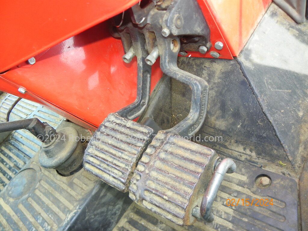

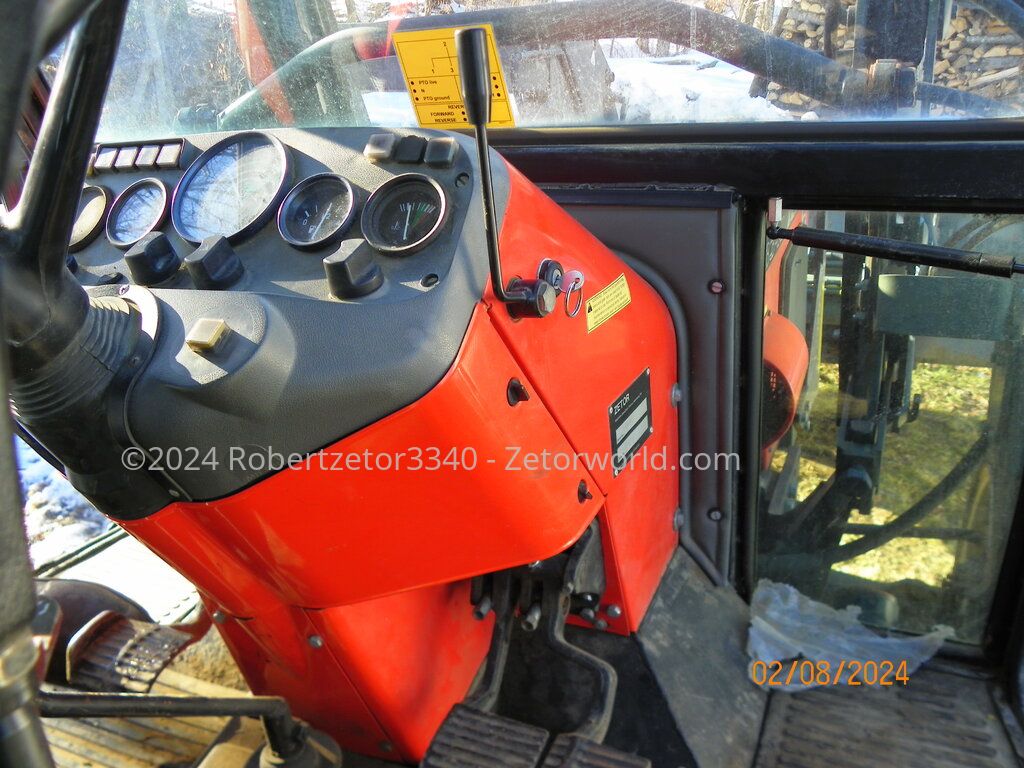

Hi,
Zetor 3340 with Cab
There is a mouse-nest in the lower dash compartment and I am trying to get the Brake and Clutch Peddle Assembly out of the way so to get access.
I am having a very difficult time with it trying to remove the removing Brake and Clutch Peddle Assembly.
(there are nuts on the back side that are not accessible)
I have removed a lot of bolts and not making much progress.
I am not sure the best way to get in there to clean it out.
Is there a better way to get access to it?

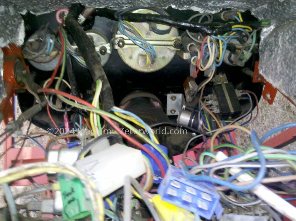

A little update.
I took the 4 bolts out that hold the Steering-Dash-Console which was a little help .
Was able to remove a lot of fluffy's house and the fluffy pee-poops.
Yes, it smells bad too.
Wires chewed-up are a Brown wire in two
and a Black and a Yellow not in two, but are in very bad shape.
I am not sure if I will be able to get to them to repair them.
I still need a better way to get to them to repair them.

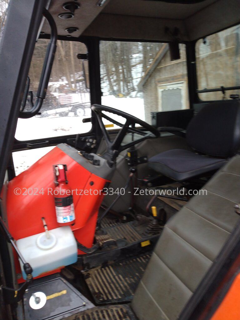

Simply remove the cab front cover - 4 screws and then lift it up and you have a better access I think.
Or remove the dashboard holder (the red metal part) then you have a lot of space.

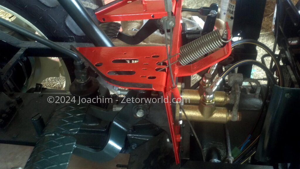

My favorite way:
screw out the 4 screws (red) and then pull aut the complete unit (OK, you still have to remove the two springs and disconnect the power cables from the brake light switches, but that's it.)
if that doesnt work, you can unscrew and remove the cab front plate - also simple and fast to do
if that doesnt work - you can unscrew the dashboard, disconnect the multiple plugs and remove the steering column rubber, then you have the dashboard in your hand. Then loosen the hand throttle cable and then remove the dashboard cover - then you have a lot of space.
3 ways without cutting everthing... ;)

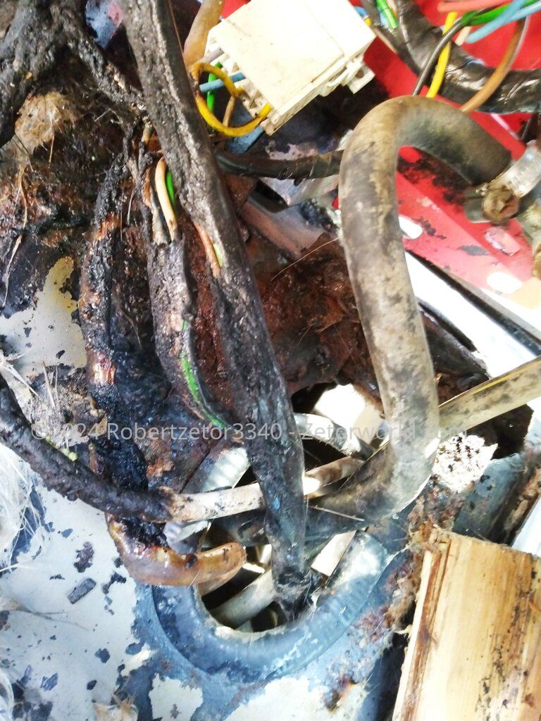

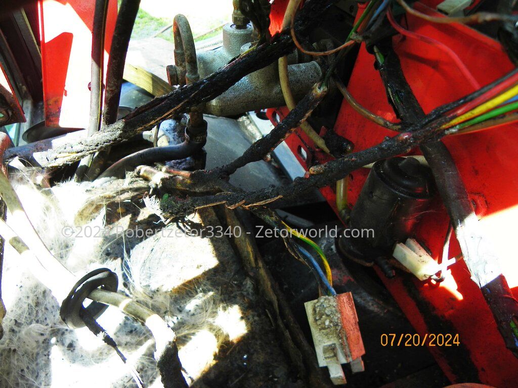

Update:
I am making progress in repairing the burnt wires.
I have the wires repaired in the Zetor and have the Dash disconnected and out of the Zetor.
The indicator-lights and wires on the Dash have some fire damaged too.
Some of the indicator-light connections on the Dash have incinerated into dust.
Mostly the male ground wire connections are gone.
Seems they are very flammable over the plastic on the wires.
These two pic only showing some of the damage from the fire.

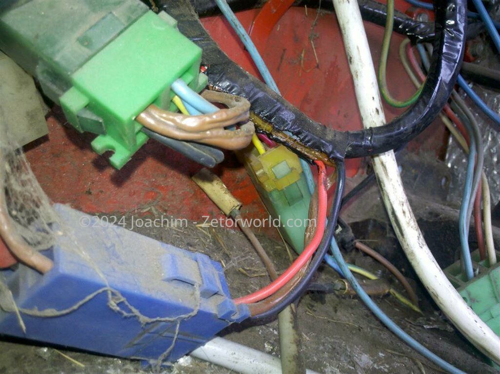

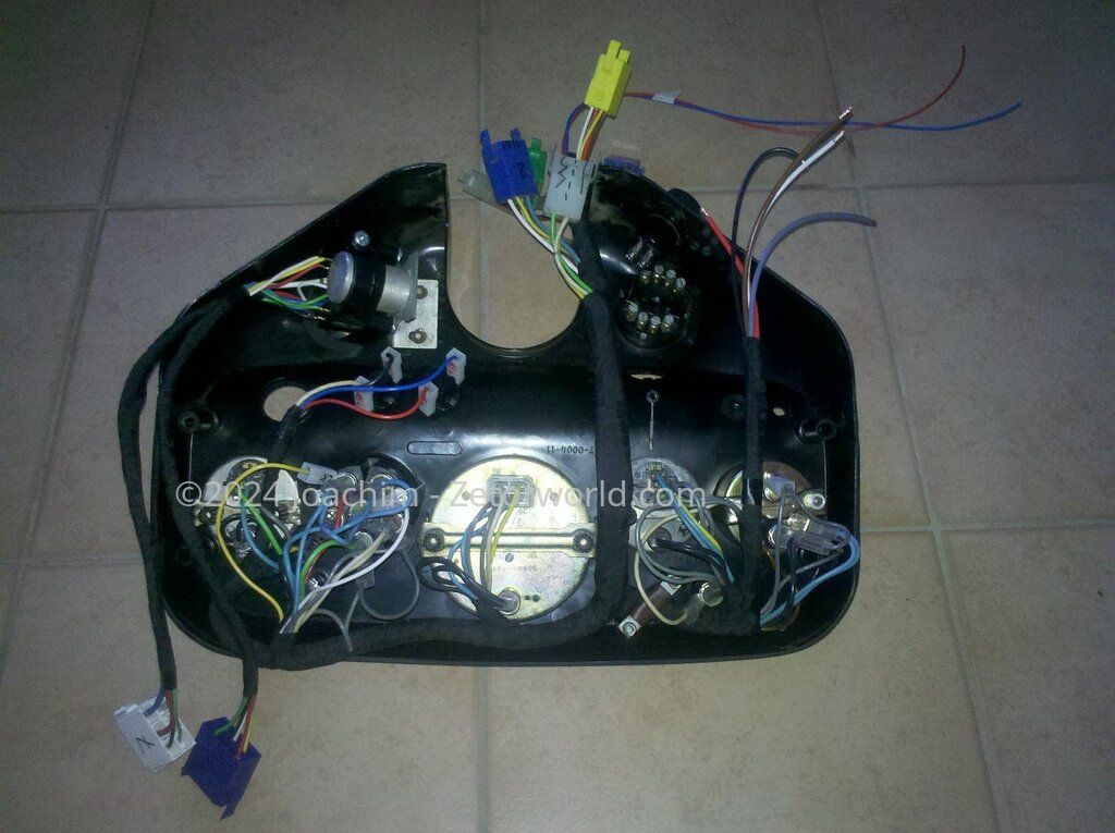

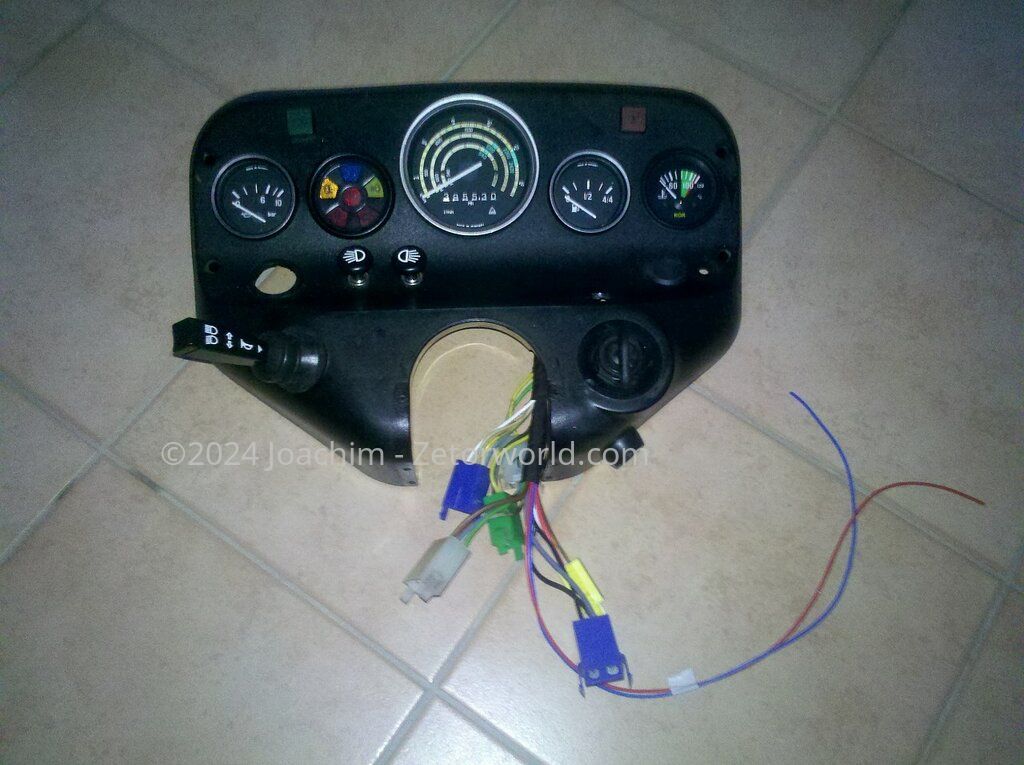

Yes and the sound/thermal isolation too...

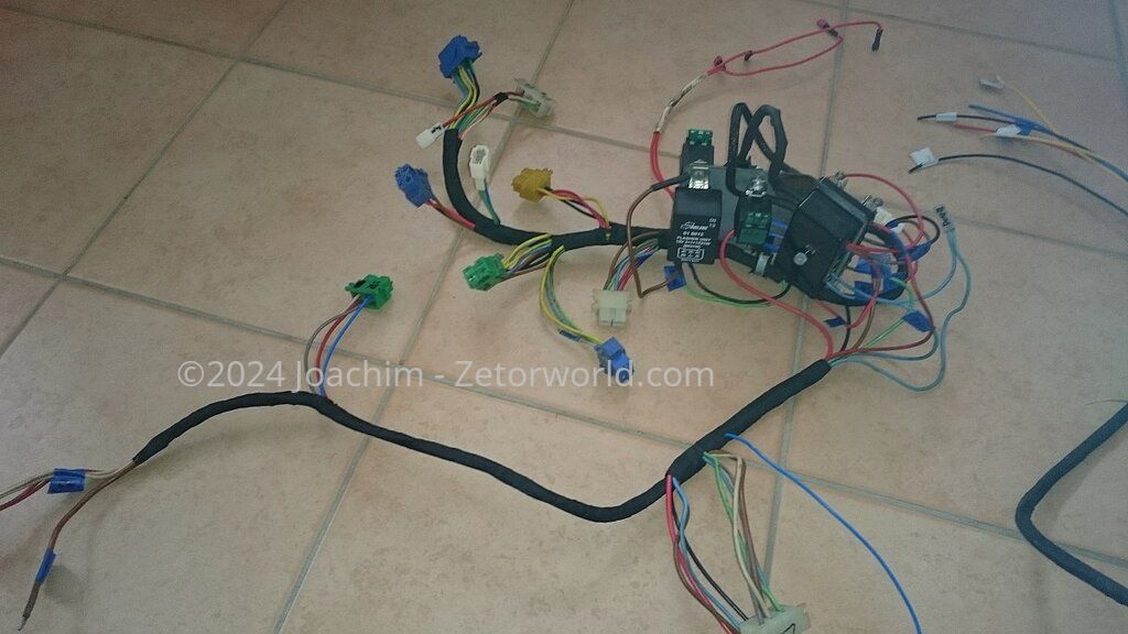

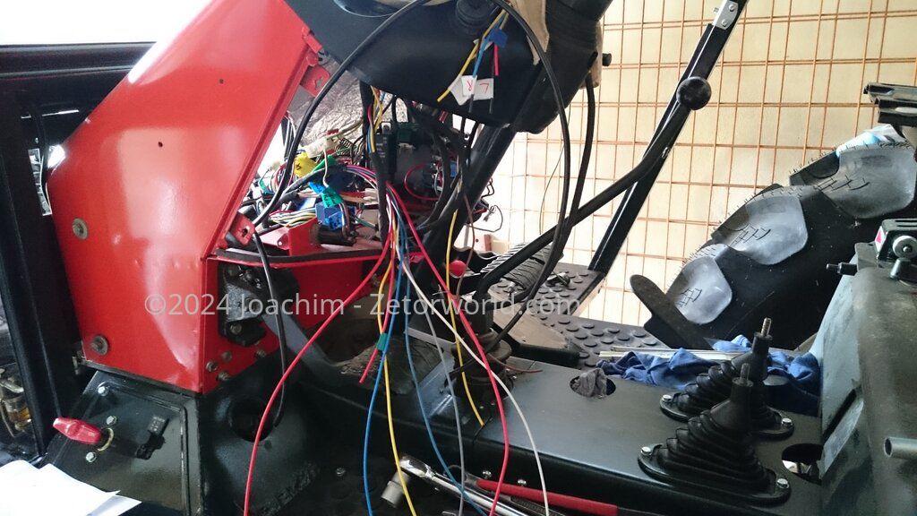

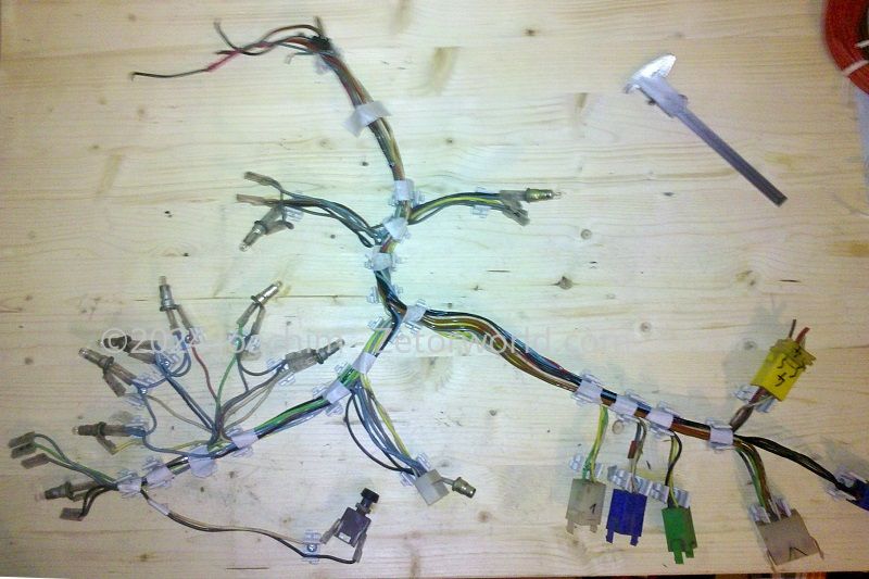

My Zetor 5011, years ago:
I pull all complely out and then I made them new. Wire for wire...
But since that I have a perfect new cable tree. ;)
... and since 10 years not one electrical problem with.
