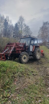

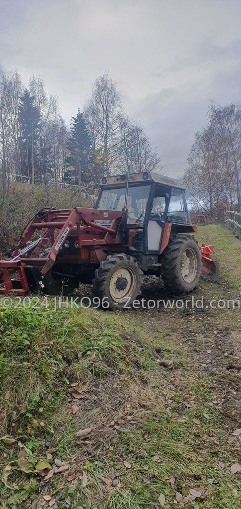

Hello,
My name is Joakim and this is my Zetor 5245, it have been in the family since 2004. I am looking forward to read in the forum😜
