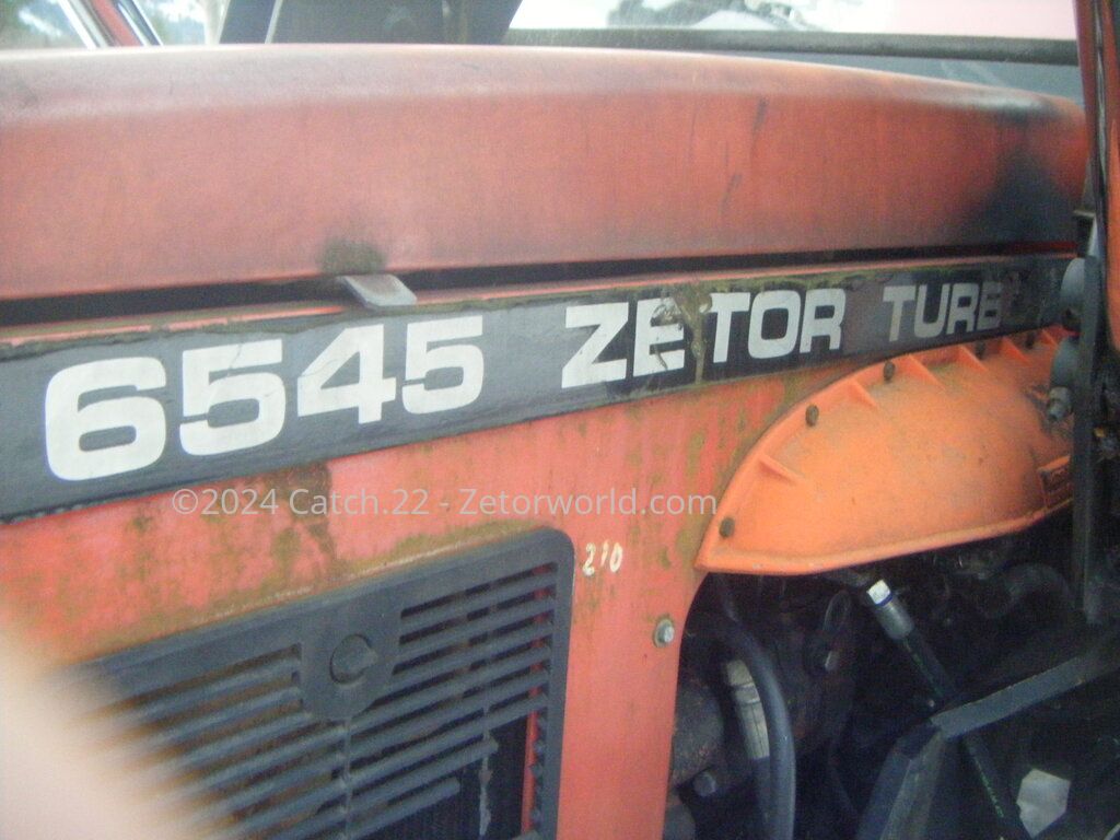

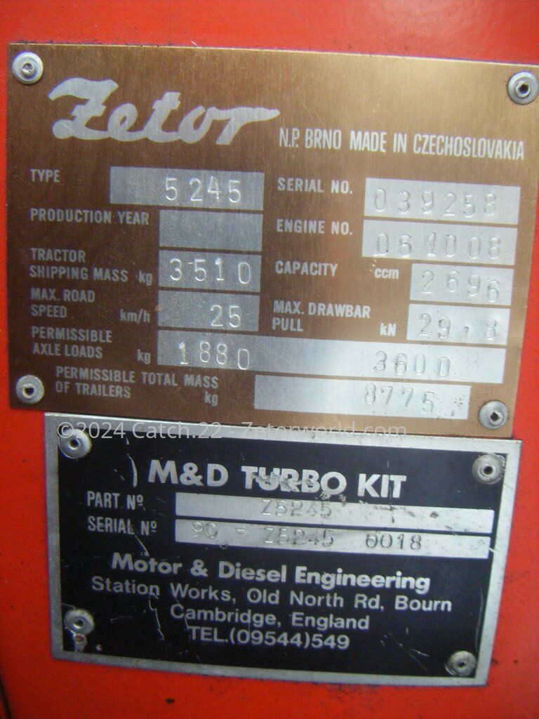

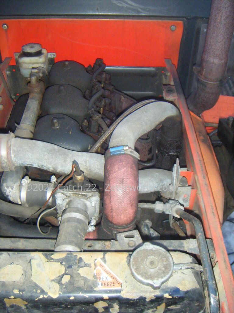

Trying to use the airhose to refill the tires for the first time, and cannot find the air outlet on compressor. Is there a modificatin on this tracktor, since it bacically is a 5245 with a factory installed turbo. There is a rubber hose going out in front of the compressor where I think the outlet should be, going down to a sort of filter bowl close to the engine oil dipstick.

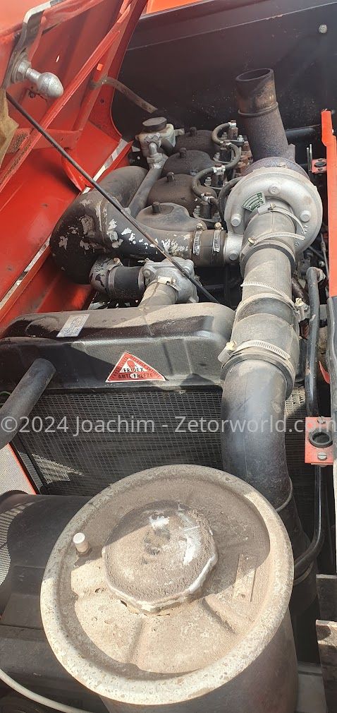

please simply post a picture of the right engine side so we can better help you with your question.
Normaly the air outlet is in front of the air pressure valve reght side of engine betwen diesel filters and battery box.

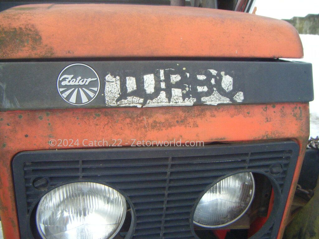

Zetor never sells a Zetor 5245 or 6245 out of factory with a turbo. The only one in UR1 series was the "5243 Tubro" as a vinegard tratcor model with a 3 cyl. engine and the 7745 Turbo as also the later ones like 6340 Tubro, 7340 Turbo and 7341 Super Turbo as 4 cyl. engines.
So I think it will be the best you post some pictures of you tractor to let see us what tractor do you have. :)

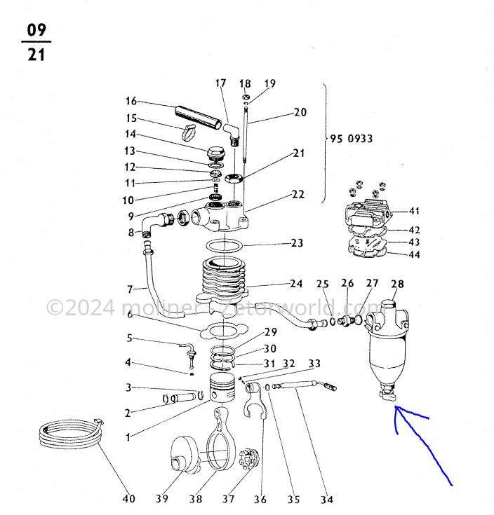

The outlet is at the bottom of this bowl. Remove the cap before starting the compressor. You need a special hose with screw-on connector, or you can mount a quick coupling adapter.
