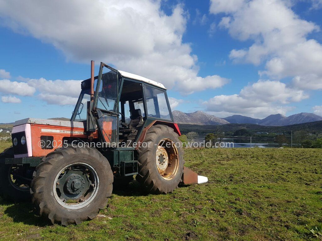

Hello from Ireland this is my zetor 7045 , that I'm hoping to do up , currently has a few issues from being left up sitting idle.

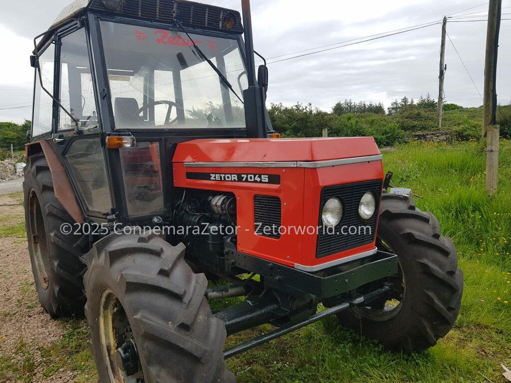

We've had this one since 2000 , it's been laid up about a year maybe more , as a result the brakes are seized and engine oil is gone to sludge , not to worried about the brakes , more so just wondering about the engine oil , can't drain , was thinking about putting a drip of diesel in it to loosen it up , or would she get it loosened herself if she was started
Can you not open the sump plug? Did you use a spanner and a hammer to hit the plug before you try opening it? or are the edges rounded? If so the right thing is to weld another nut onto the sump bung. That heat will help open the bung along with giving another nut to try open.
