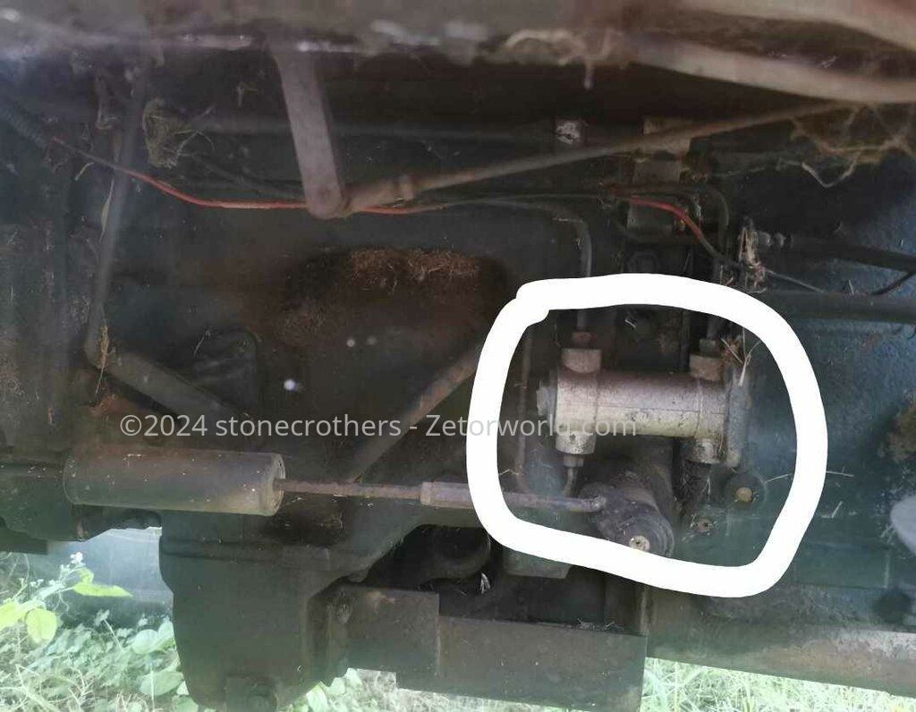

Hi I have this zetor 7045 and I'm chasing info this this part like the precise name as I am having dramas find the part online to replace it
Hello and welcome Josh! :cool:
You should buy a spare parts book for Zetor 5011-7045 - its a good investition. ;)
6911 2607 - Brake pressure compensator
And attention - its NOT the same as 7011 6830 :lala
