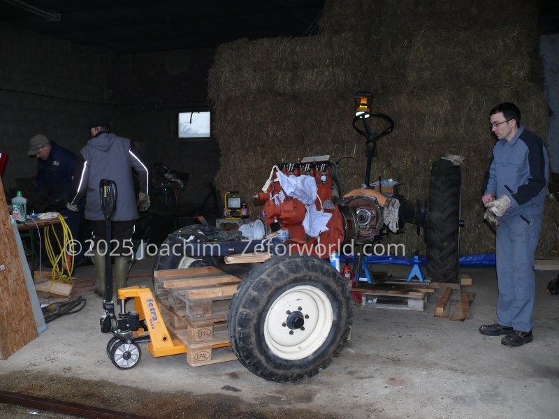

Its not a big job :) - its a job you can do by self its not realy complicated and works without special tools.
Do you have a pallet truck or an engine mounting crane (one of those Chinese things will do)?
You have a right and a left hand?
You can spend one or max two days for repair? (I do this job often for others, I need around 6-7 hours for but other guys are faster as Iam the old man. ;) )
You can do it by self. :)
Make photos from working steps so we can help you or give hints and save a lot of money.

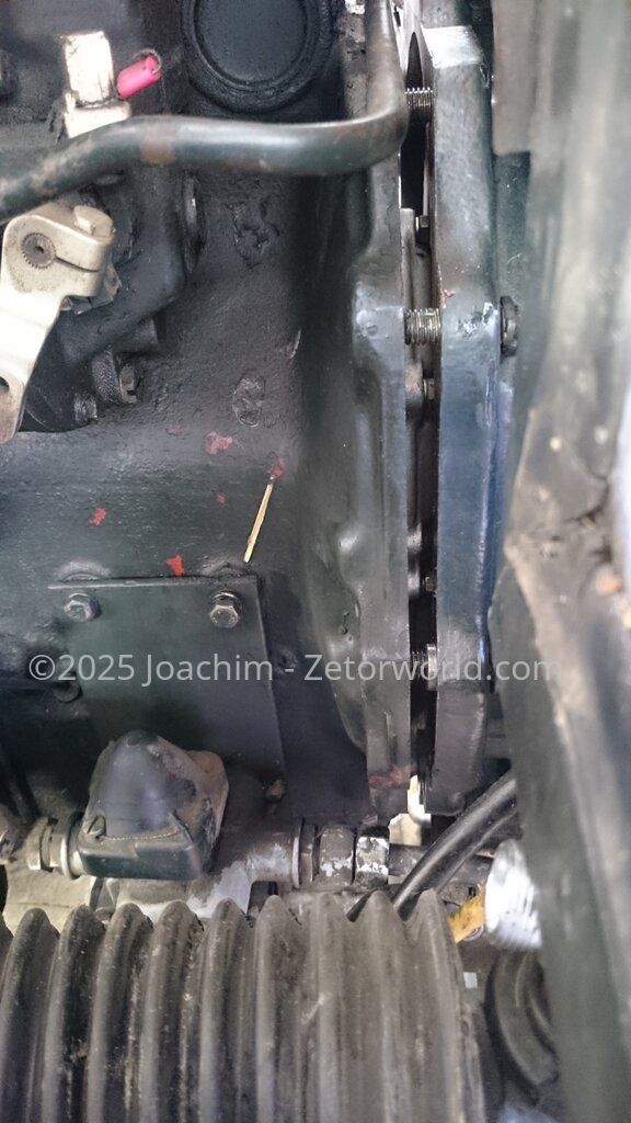

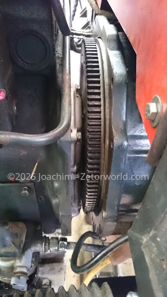

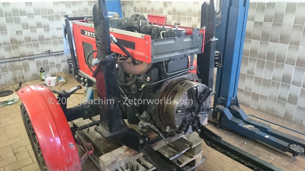

Two examples...
Of course, the cabin does not have to be dismantled ;) I had to do that here because of other, more extensive repairs - so don't worry.

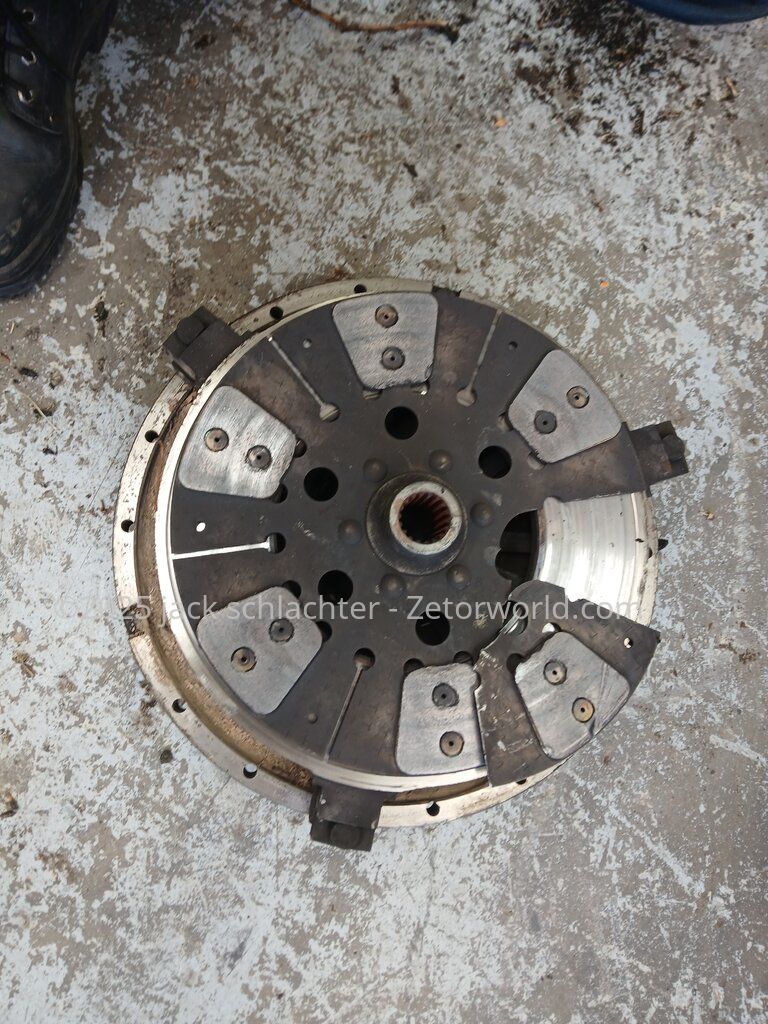

Congratulations ;) - it doesn't just look like the clutch disc is broken, but also your pressure plate in the automatic clutch.
What many people don't know is that the ceramic clutch discs last a little longer, but they also ruin the pressure plates in the automatic clutch and the flywheel.
The standard clutch discs don't last that long, but usually don't damage the automatic clutch or the flywheel.
