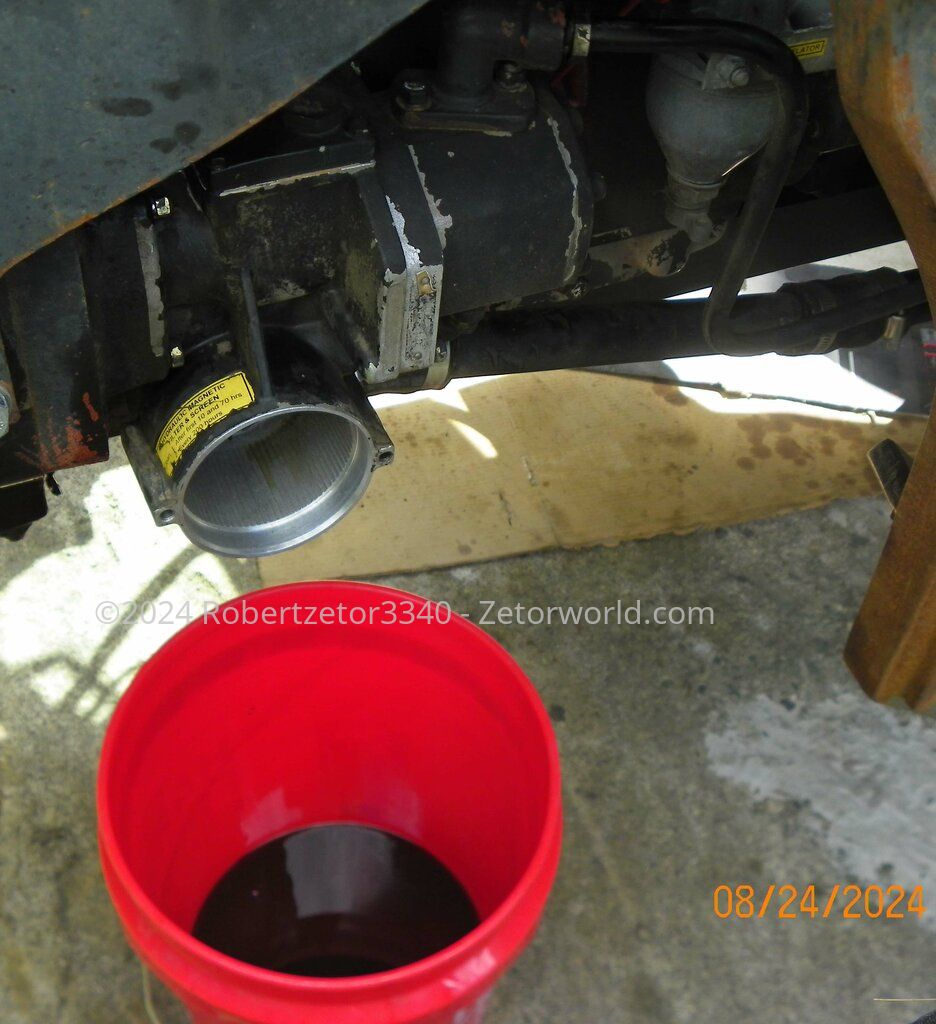

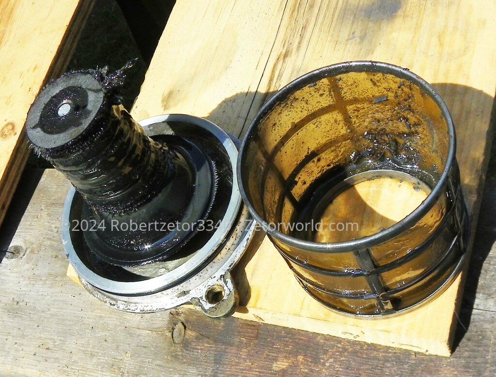

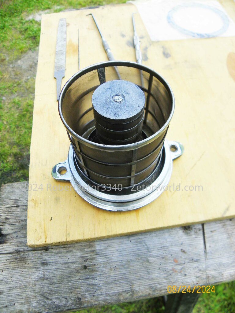

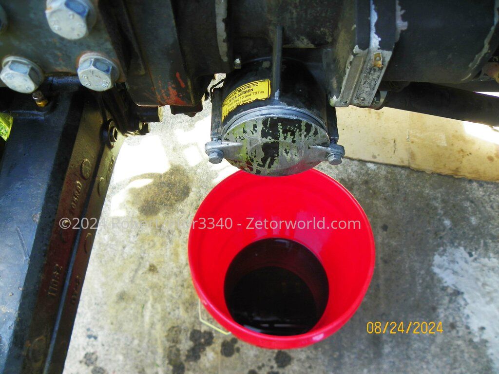

A few weeks ago I changed the Gearbox/Hydraulic Oil and Filters on my 3340.
The Magnet Filter by the pump looked like it had never been cleaned.
