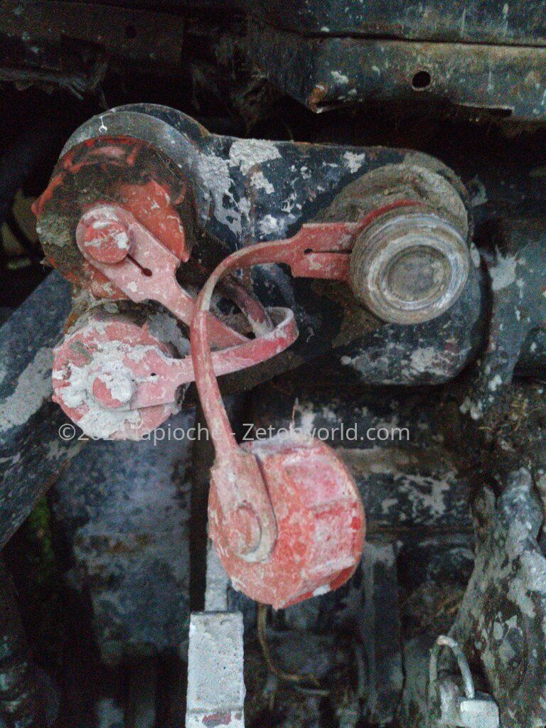

These are my ports I have. To order a cable that connects to them, I'd like to know how to specify the connection
That are screw hydraulic ports - never seen this type before in Germany or East Europe.
Try to find them at a hydraulics store website with shop or so?
You can simply change them to other ones, its in most cases M22x1,5 and pipes are 15L pipes.
