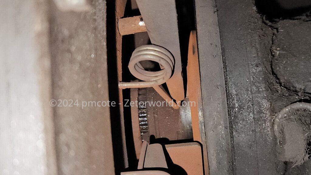

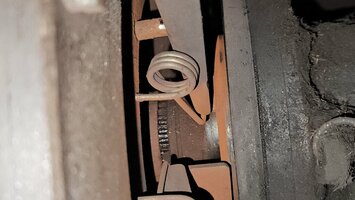

Hi there thanks for your reply,
The 540 is selected , I also tried on 1000. The left floor lever is all the way to the front. One noticeable thing is there is no grinding when this lever is moved to PTO and hydraulic when engine is running and manual pto clutch not engaged. I also took a picture of the inside of PTO clutch view port, Im usure if those lifting tabs are right.
The PTO always turn by hand what ever the floor lever position is. I did not try with the PTO Clutch lever engaged... I should.
