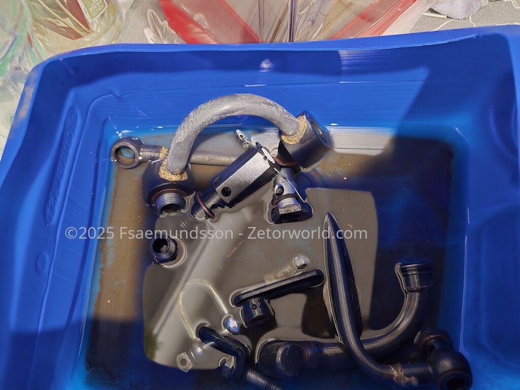

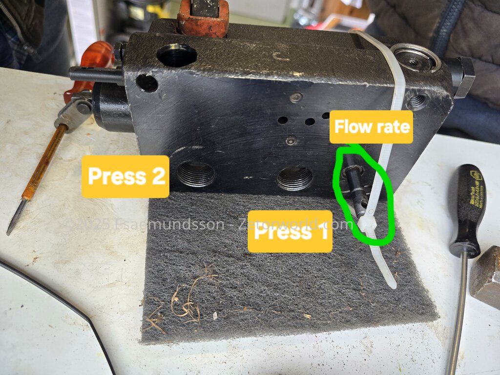

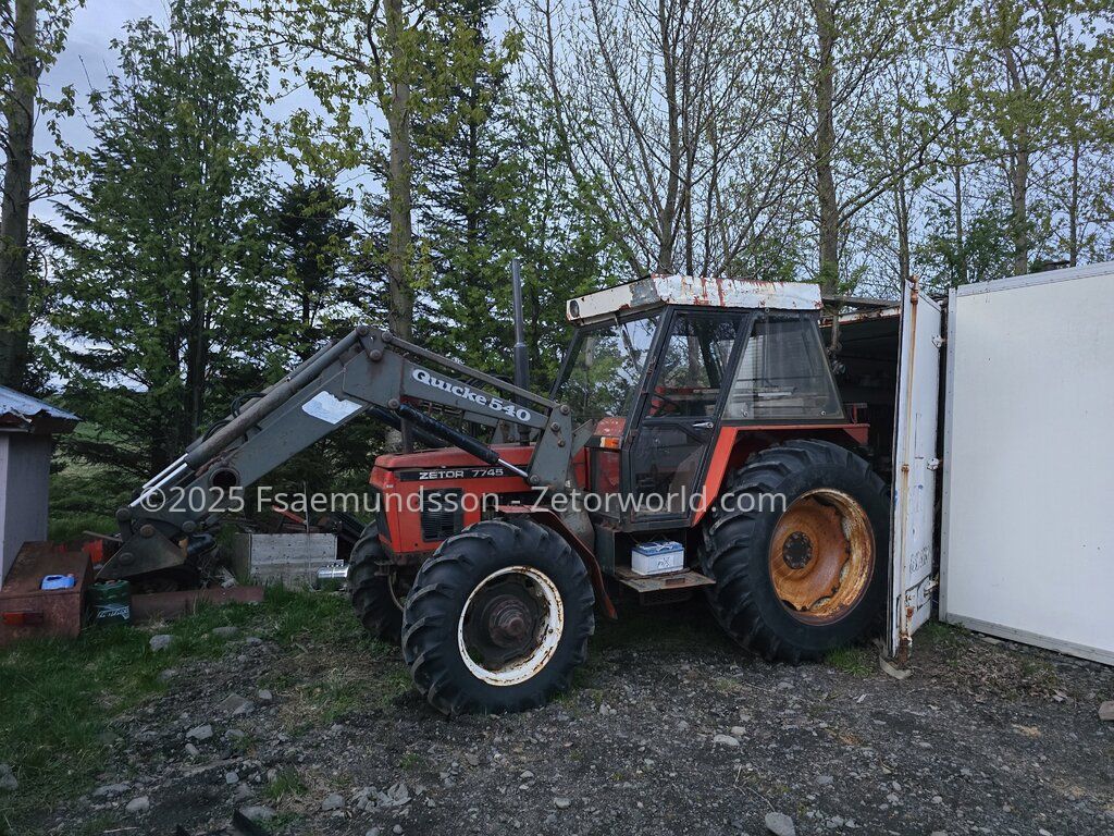

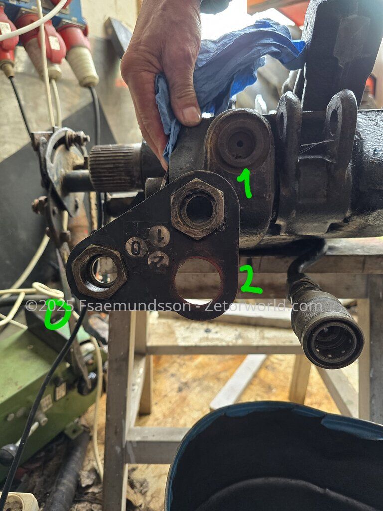

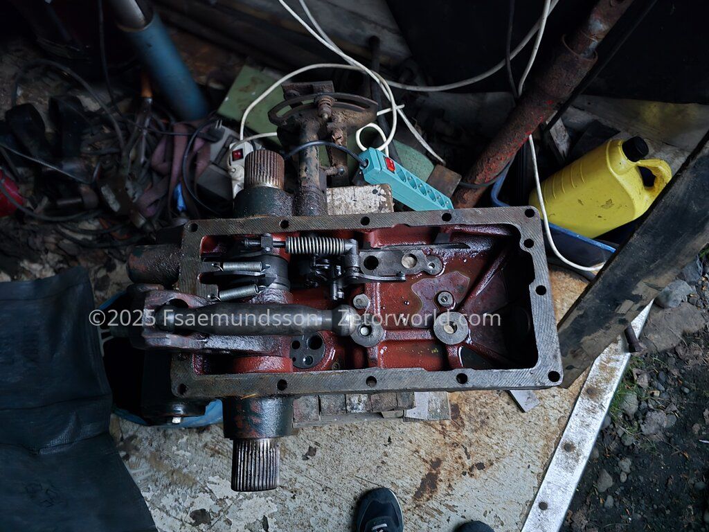

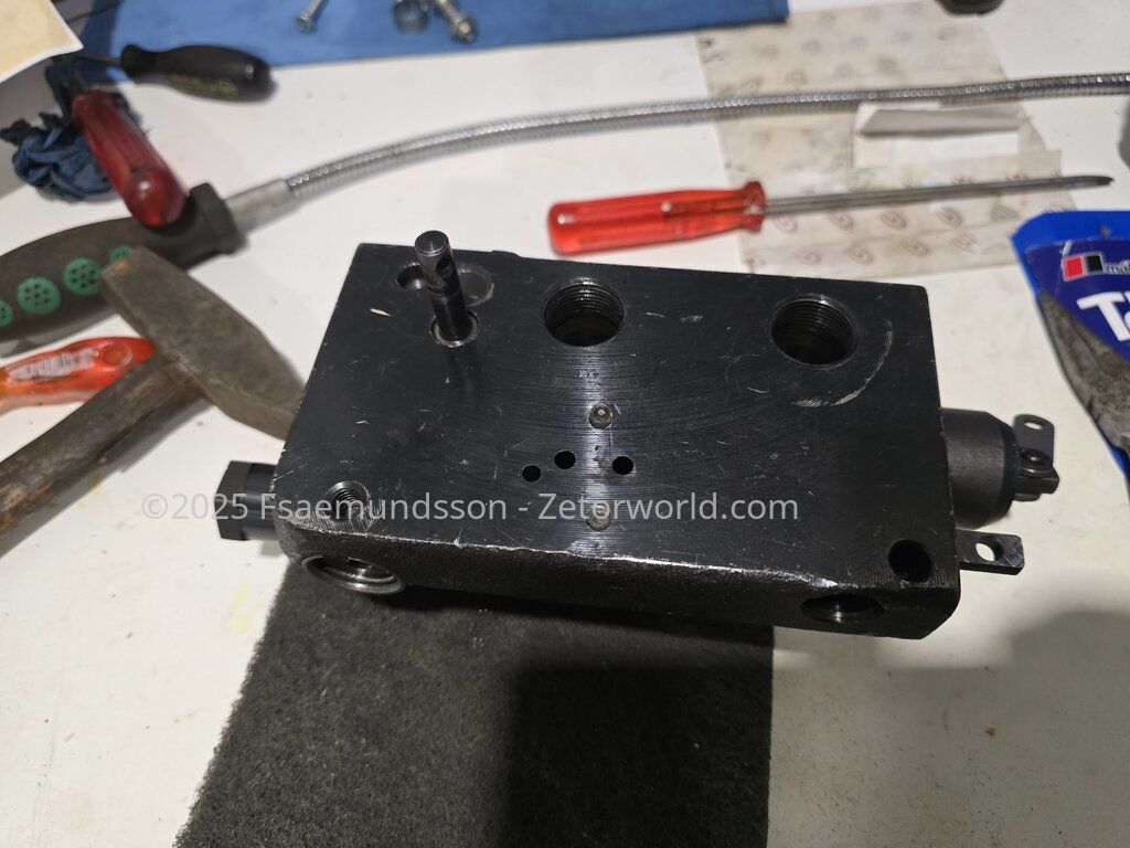

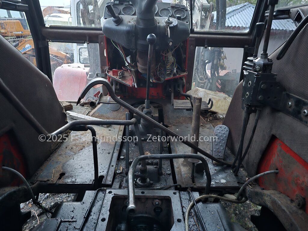

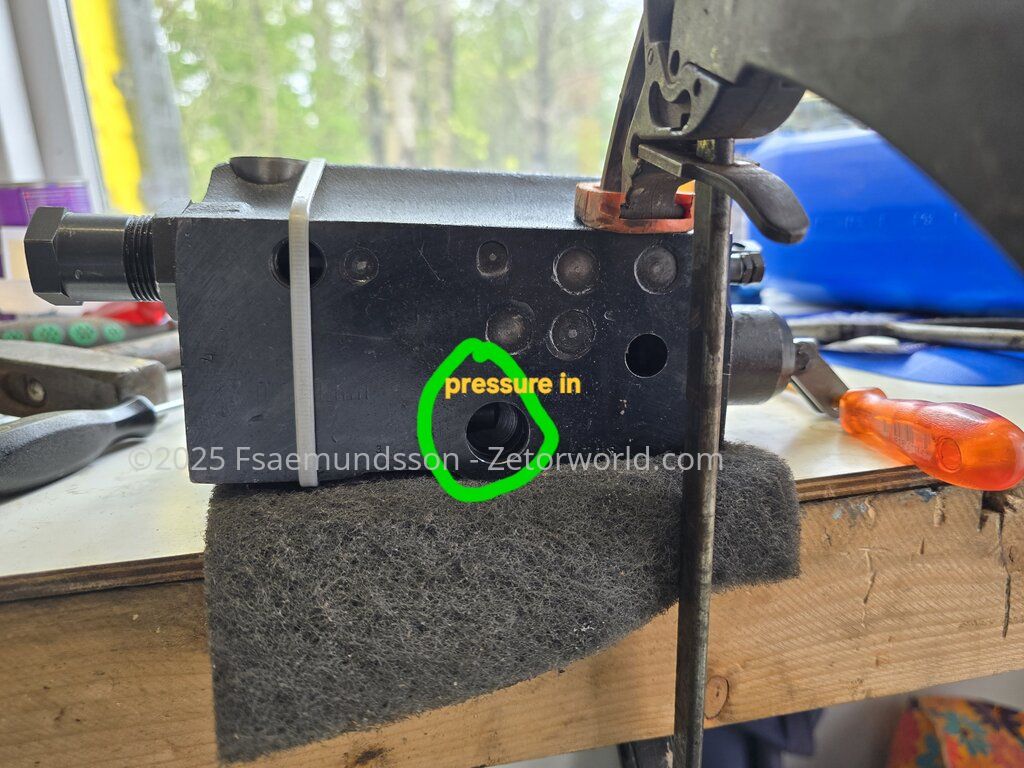

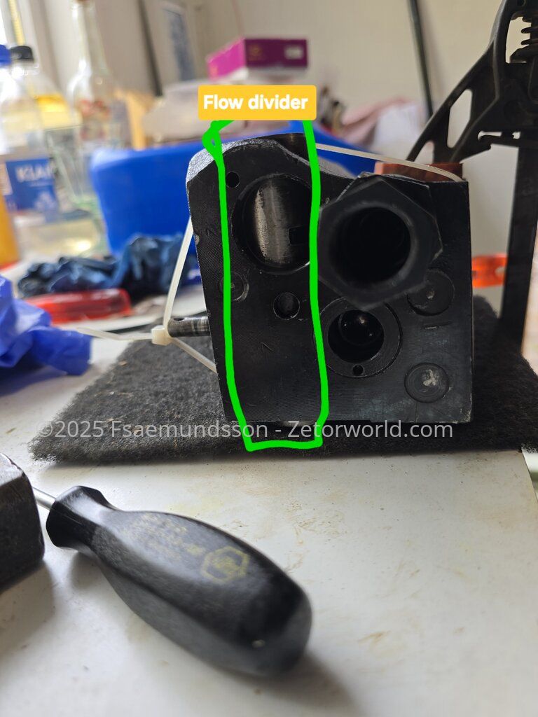

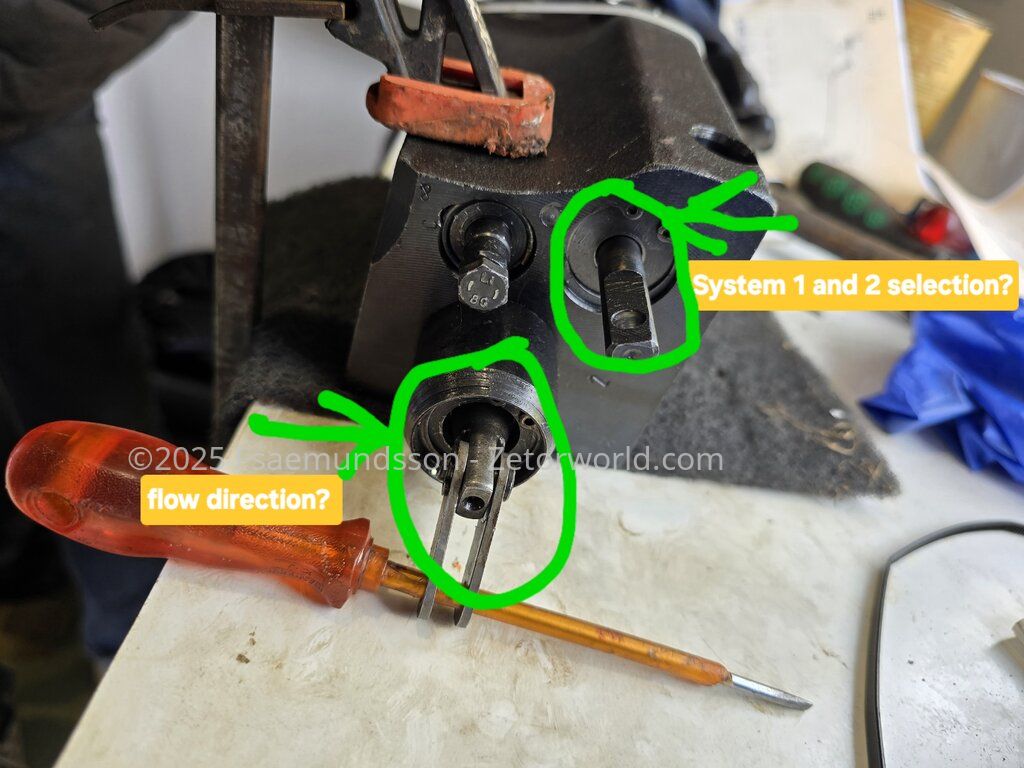

My Dad's Zetor 7745 is not lifting the rear Linkage or the front loader but there is hydraulic pressure coming up to the hydraulic distributor and to supplying the 2nd port with hydraulics.
So far we have stripped the distributor down cleand it up made sure everything is clean and free but no joy in anything working would you guy's have any suggestions on what to try next ?
Many thanks Flo and Sam from Iceland
