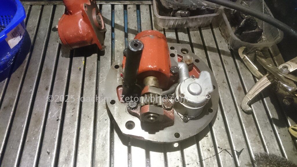

My question is, are the any outlets for pb hydraulics anywhere else on the tractor?
Where are the hydraulic pump located?
In your model, the hydraulic pump is still located in the center of the differential gear box on a round cast cover.
No, max. 3 in the back.
but, do you know this:
Thanks for the reply, I talked to someone who used to work at the dealership as mechanic and he said they actually used to have a replacement cover for the hydraulic pump that they retrofitted for the loadertractors, anyway the faq looks fine so I will look into it and see if that something I can do myself.
