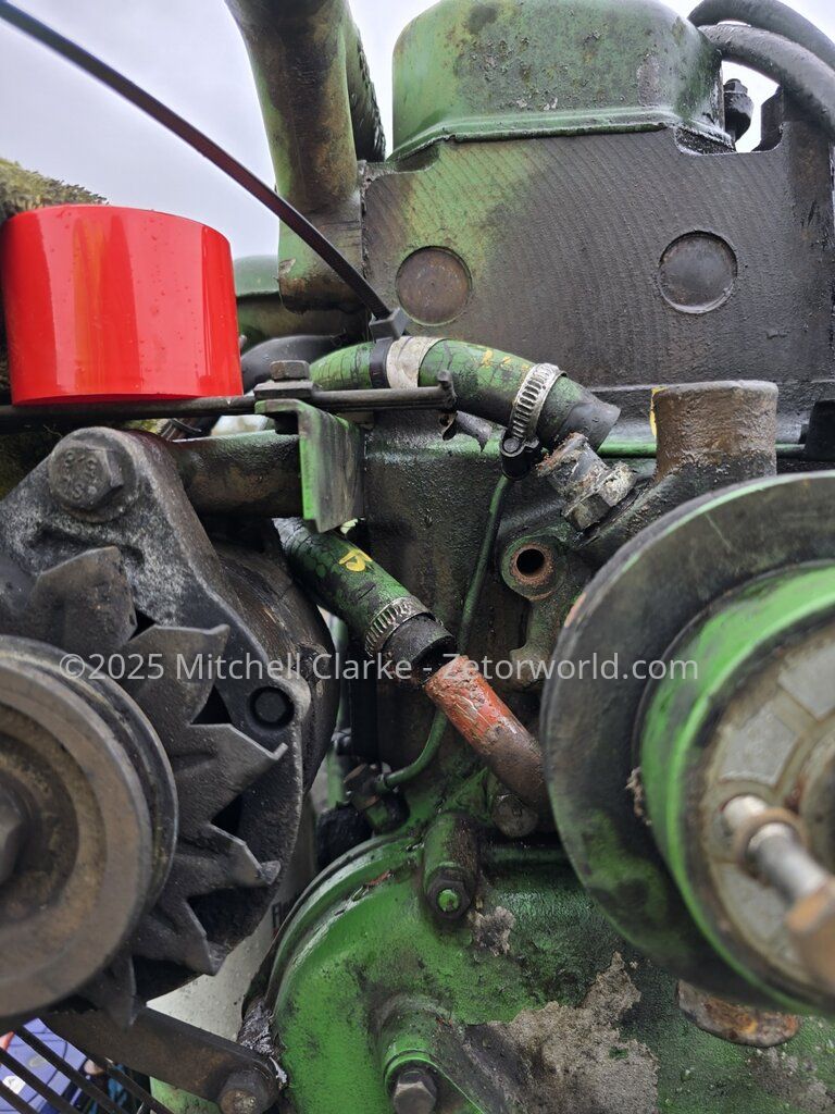

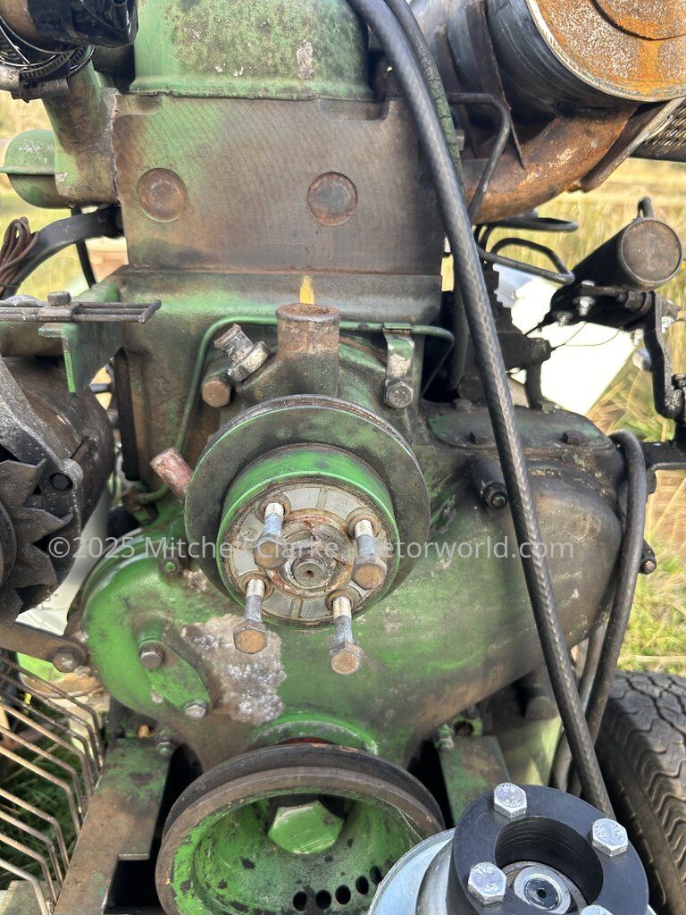

Searching for a water pump for a zetor 7901 engine being used as an irrigation unit.
This engine was used in Zetor 7340 Turbo. Part number is 79010650.
No - that part number is only the pump housing... ;)
The right part number is 79010625 or 79010615 for the complete pump.

Hi Mitchell. You could contact Zetor direct in Echuca,they will have the right pump, genuine for about the same price as non genuine. Alternatively you could recondition this pump fairly easily if you have time, and a press. I've done this a few times on different zetor's and it works well
