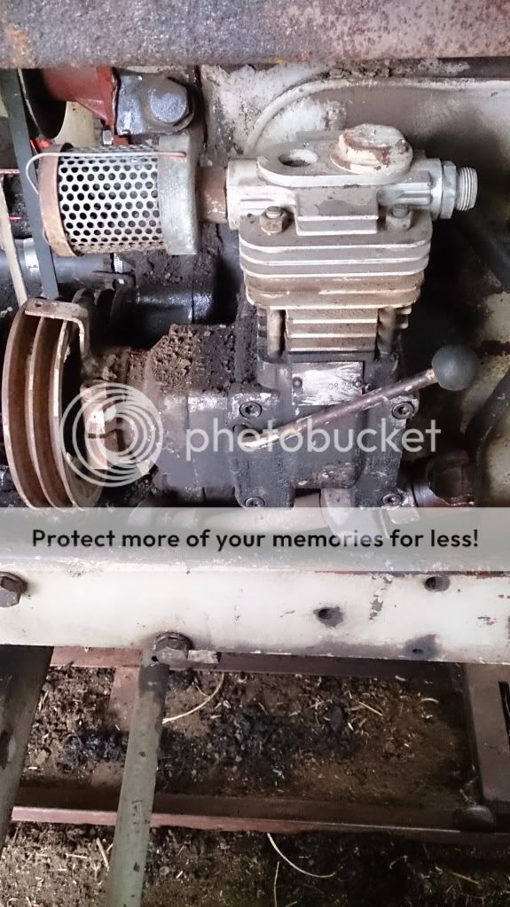

Gday, so I'm restoring my 8011 atm and bolted on the side of the engine is a compressor v belt driven but is disconnected and in need of repair it looks factory just wanted to know if anyone has any more information on these units
Ok so i searched this forum for info on this and most posts suggest 2 leavers to activate the pump, so unless im blind i only have 1 lever as my picture shows
Crystal compressor has only one lever to engage it.
I see yours has an inlet filter fitted. most had a pipe to the aircleaner unit. maybe the aircleaner on yours rusted out and a non genuine one was fitted that didn't have the rerquired pipe.

The pulleys all turn ok so the bearings feel fine, I asked the previous owner and they said after the first set of belts broke they went replaced, so I have one more question, I am going to pull it off and inspect it anyway cause wasps had built a nest in it, if I undo the 4 long Allen key bolts and knock it off what's behind it? Is it connected to the engine somehow behind for an oil feed or is it just a solid flat mount point?
Yes. It just pulls off the engine leaving a big hole through which the oil to lubricate it splashes
