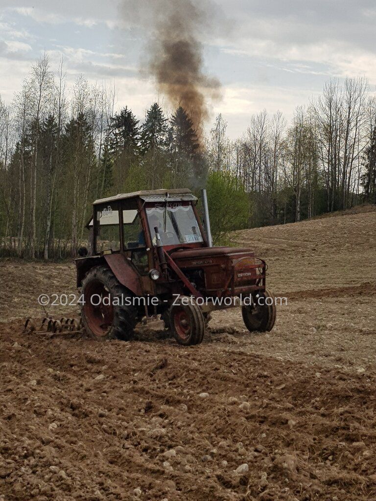

question Zetor diesel tuning options?
Its not a real good idea and black smoke is just your money (diesel)
The Zetor 4712 only has a 100mm bore and the "small valves" and therefore manages to achieve 45 HP on the 540 PTO.
With some work it is certainly possible to get around 5-8 more HP out of the engine - but at what risk?!
The 3 cylinders are not unknown for cooling problems on the 3rd cylinder (towards the cabin), so the engine cannot easily tolerate more diesel and therefore more heat if the power is to be used permanently.
If you have the thought of a turbo - don't do it, a grandma doesn't become a virgin.
