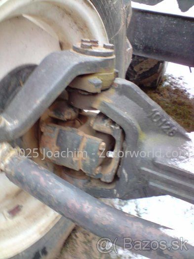

Zetor 's own heavy all-wheel drive axles (6745, 5945, 6945, 6045, 7045, 6245, 7245, 7745 and early 6340 and 7340, as well as early 8540 and 9540):
This was a joint development with the Romanians. Did Zetor produce these in the Czech Republic, or did they even come from Slovakia (Stetex)?
I believe the joint development of these axles began with the development of the UR2 Crystal series and only affected the heavy Zetor axles with the cast star.

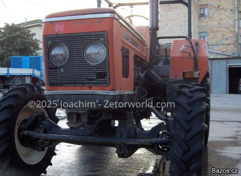

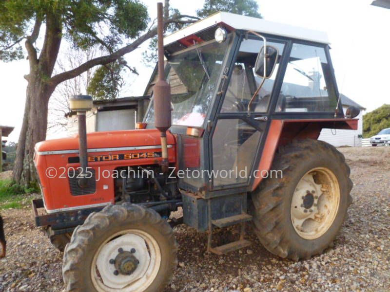

Zetor 5045:
This used an axle from SIGE, similar to what was used in Deutz tractors at the time.

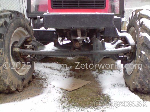

The later Carraro axles:
Zetor purchased these completely.

Zetor UR1 and UR3 axles use 3011 satelite gears, part numbers are identical.
You can also mount UR2 portals on a UR1 axle, the kingpin bearings and their spacing are identical
