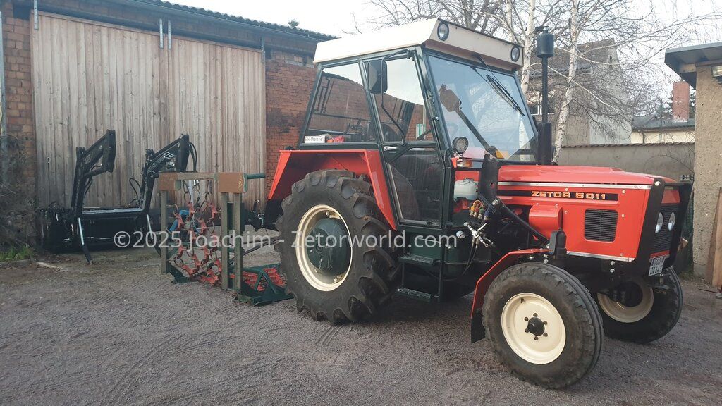

I made a lot of electrical changes to my Zetor 5011 when I rebuilt it years ago:
- Alternator changed from 45 A original to 95 A
- Cable cross-section between alternator and starter from 4mm² to 16mm²
- Battery cable between battery and starter from 35mm² to 50mm² fine strand (from boat building)
- Battery 145 Ah 12V replaced with 195 Ah 12 (Exide truck battery)
- Cable for the driving light in the hood from 3x 1.5 mm² to 4x 2.5 mm² and also the ground connection from 1x 1.5 mm² to 2x 2.5 mm². Then changed from Bilux to H4 (headlights from Wesem)
- as well as a few other cables that were reinforced in order to be able to safely install and attach the radio, work lights, etc.
I had the entire wiring harness out and rebuilt it largely according to my own wishes.
If you were sure that 2x 16mm² would be enough, it would be easy to retrofit and from the battery you could go directly in the A-pillar on the left side of the cabin up to the roof console and from there onto the roof.
The air conditioning would then have to be fitted into the roof hatch and then there would be the question of how much higher the tractor would be and how easy it would be to get to it for maintenance.
In terms of weight, this is not a problem with a metal roof, but with a GRP or plastic roof like the BK 6011 cabin, you would have to distribute the load over a larger area to avoid damage to the roof.
If you had any more photos of this type of conversion, I would be grateful for any. Then I could think about whether I could choose this option for myself.

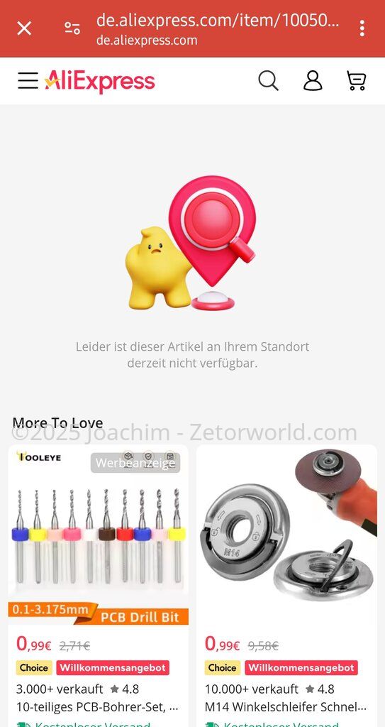

Some sellers are missing some data, this seller is missing ALL the data :ROFLMAO: . Nothing about the power, but I see it's a very small and easy to fit as the things measure under 6cm long and wide..
You can ask him is easy try it ....
Seems to block my country...
Also the parts included to switch to heating are not described anyhow. It is easier to find a dealer who informs what he is selling than try to communicate with dozens of dealers who don't. I would also be interested in the heating power, but that link does not help it..
