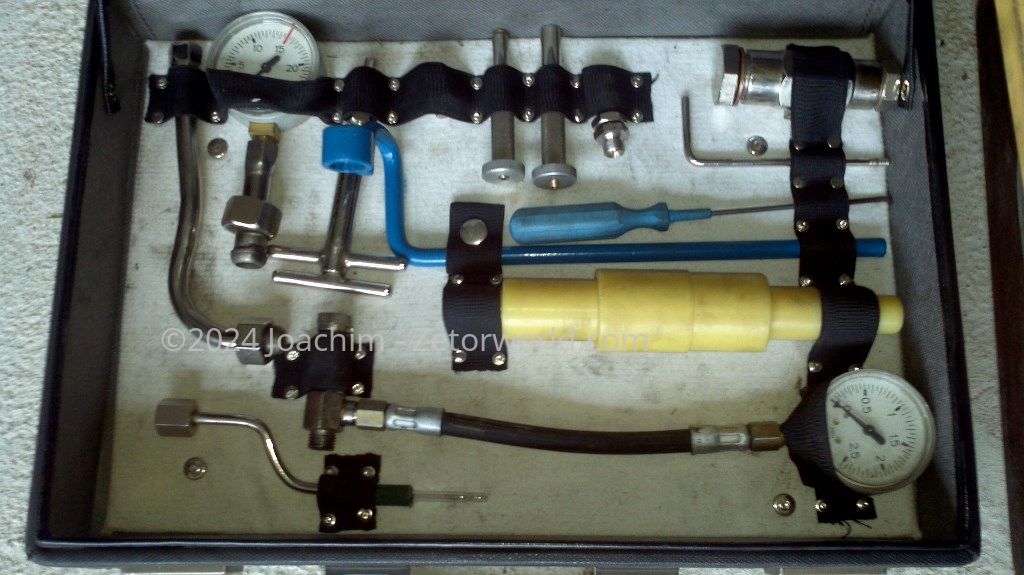

I have an original Zetor /ZTS transmission/hydraulics test case. I can see if I can find more information about it and take photos if necessary.

Your a wealthy German man, I'm only a poor Irish farmer, I don't have that equipment you showed in that picture. I'm sure it would be expensive. I have a general tractor garage only 3 miles away, who would be able to do this and tell me if that's good or bad. It might all right for you to buy a fancy tools but It's not much use for me to buy special tools to use maybe once in my lifetime.

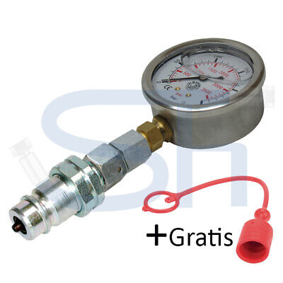

... and I said that you don't really need that. A tester like this will do the job for under 30 euros
and a suitable hydraulic hose to connect it to your tractor.
The test case is great to have, but not absolutely necessary, especially since it contains much more than just the hydraulic test tool.

My test case was actually a bargain on eBay years ago. I saw it by chance, together with an original wooden box full of special tools for Zetor tractors UR1 and UR2, and bought it for a mere 80 euros because hardly anyone else knew what it was. So it's not like you have to be rich to afford something like that, it's just a chance you took.

The photo of the test case should only serve as an idea to show you what the test equipment looks like and make it easy for you to build something similar for your tractor.
