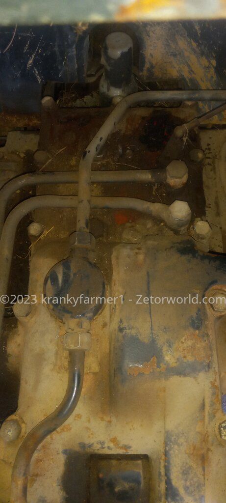

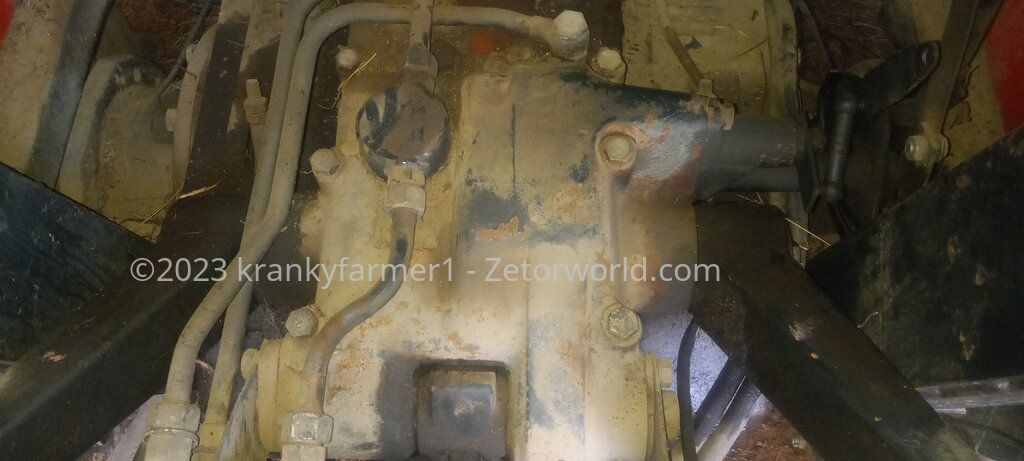

So got handles reattached. And medal cover up tied up leaned forward..
Im thinking only the outer bolts need taken loose or ?
That one main line lookes like i gotta take loose under rht hand side that goes to the front.. there is a bar across the back attached to the fenders that needs removed as well..
I am guessing when i unhook the hydraulic lines from the back my lift will drop? Do i need to drop it all the way down first?

Theres a hydraulic oil filter on the right hand side in front of the cab, on the end of that line. Undo that, undo the link conecting the 4 hole toplink bracket with the 3pt lift cover, undo the pull rods from the lift arms, and indeed undo the M12 bolts around the perimeter of the cover. Then lift it off high enough so you dont damage the levers underneath the cover.
Oh yes, undo the line to the external ram too.
Dont forget to change the O rings on the small tube between lift cover and axle housing when youre in there, and the main ram seals are 30 years old too, so its easy to change while youre in there.
This thing has 2 filters on right side right velow the starter i see.. looks like that extra long line that goes under the right side will have to be moved completely..

I see that filter now.. thanks
I take these are all threaded lefty loosy and not left hand threaded that bolt in the bottom of filter housing won't break loose 🤷‍♂🤔
I'm not sure if yours has the external ram that was mentioned? It doesn't look like it, (as a new member I cant open the image to see for sure) but if it does be careful because as you remove that line your arms will lower forcing out a lot of fluid and necessitating a shower.
As to your bolt question, I believe they are conventional threads, yes.
