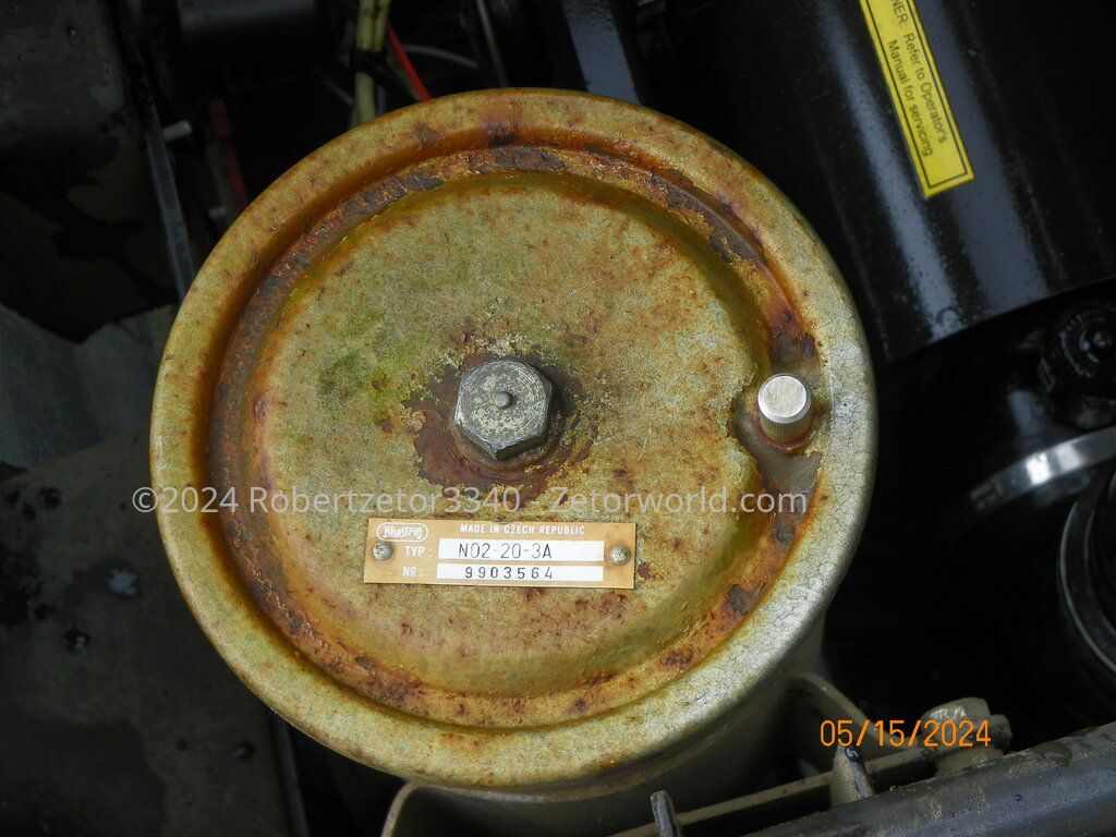

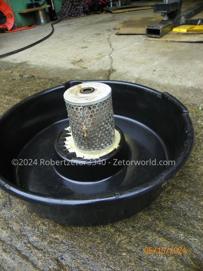

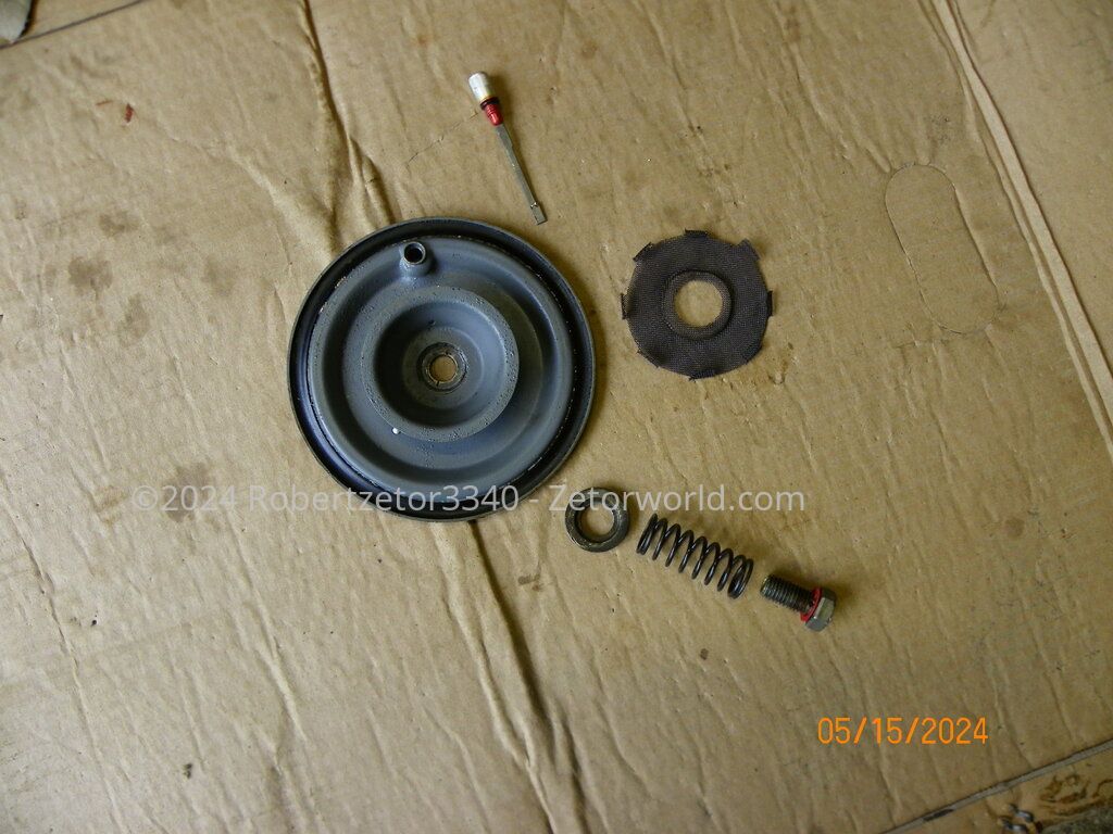

question What kind Hydraulic/Transmission oil and filtre do I need ?
I do not know what the number is for the Zetor 3340 Gearbox/hydraulic Oil Filter.
Does anyone know what the Zetor 3340 Gearbox/hydraulic Oil Filter is ?
filtre: 7011 4566
big rubber seal: 7011 4563
little rubber seal: 93 1136
buy the original ones from your local dealer, they will have the right one. :)
filtre: 7011 4566

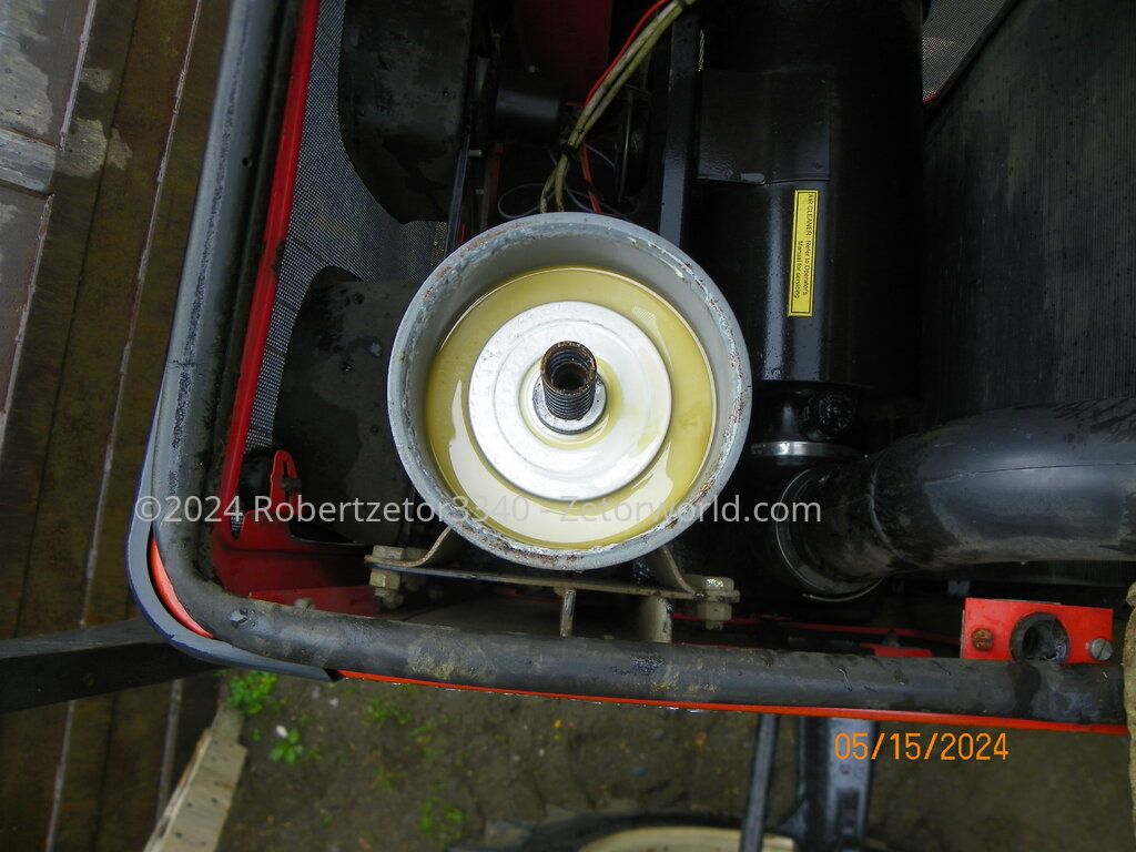

I was only able to find this filtre: 7011 4566
from ebay and I asked them if they had the
Large Rubber Seal: 7011 4563
and the
Small Rubber Seal: 93 1136
Which they replied, they were not able to find.
The photo looks to have the Small Rubber Seal on the filter itself.
I have ordered this filter and will have to see what the Zetor has when I change the filter and Gear/Hydraulic oil
(Ultra1Plus SAE 75W-90 Synthetic Gear Oil, API GL-4
If I will need a Large Rubber Seal, I will be able to see what that this all about then.
There seems to be no good picture or video showing what it looks like.

Hi Joachim,
Thank you for your very good help , I do appreciate it.
Yesterday I received an email from a Zetor warehouse, suggesting I contact the Zetor dealer,
Rene J Fournier's Farm Equipment in the far northern part of Vermont.
Today I called them and placed an order through them for the Filters and Seals.
I also order two other filters with this order.
Gearbox/Hydraulic Oil Filter: 7011 4566

Hi Joachim,
I received the order and there are several errors in it,
but before I call Rene J Fournier's Farm Equipment
I have the part numbers for the other two filters
and can you verify that they are correct part numbers for my Zetor 3340 ?
Fuel Filter Element 4-3/8” Long: 93 1273
(Power Steering) Filter for Metal Steering Tank 5.5” Diameter: 93 1154
With my order through a dealer in northern VT,
one of us may have missed spoke with one of the part numbers
as they do part-orders by land-line phone
(they do not have email, cell-phone and a web order parts page).
So I am not able to see what each part cost with tax and shipping.
Anyways, the error is with the Small Rubber Seal: 931136
and in the place of was ordered 931130 (screw) Long-Bolt for the filter assembly.
This bolt will be mailed back and the Small Rubber Seal: 931136 will be shipped to me soon.
